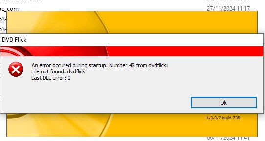

Get this error starting DVD flick can anyone help?

@gsc1ugs: It runs here under Windows 11. You should however use it with the originally shipped ffmpeg.exe from 2015. Copy attached. Extract it into the \bin folder. It failed here with newer versions of ffmpeg.exe.
Or you may want to try the newer DVDStyler as an alternative. It is still actively supported.Last edited by Sharc; 5th Dec 2024 at 02:09.
Install Revo Uninstaller (free version).
https://www.revouninstaller.com/start-freeware-download/
Start it, wait until all installations are found.
Search DVD Flick in the list, rightclick it, select uninstall.
Uncheck "Make a system restore point before uninstall", click continue, click yes on the uninstall questions.
If finished, click scan.
Select all found registry entries, click delete.
Click next.
Select all leftover files and folders, click delete.
Close Revo Uninstaller and reinstall DVD Flick. -

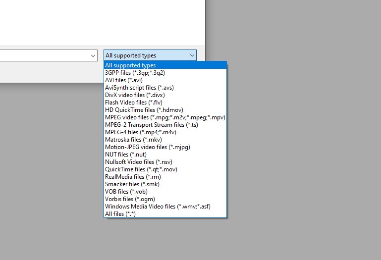

This worked but still get this error adding a MP4 file that runs perfectly

Well somethings wrong because it says in supported files??

I believe Sharc may be on to something.
.MP4 is a container so it may depend on the video or audio codec used to create the .MP4 file.
DVDFlick is old so may support only older codec for creating an .mp4.
Probably the reason it needs the original ffmpeg be used.
I do not have DVDFlick installed but I did use it many years ago & liked it back then.
I remember it had a limit of 99 files. -

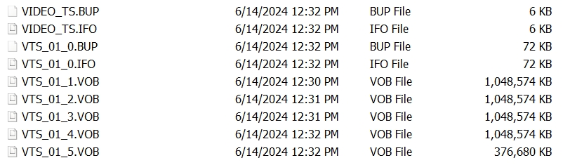

These are the files in a DVD VIDEO_TS folder I had handy.
It is a compressed to DVD5 size & without a menu.
This is basically what should be inside your VIDEO_TS folder.
Usually the AUDIO_TS folder is empty.
[Attachment 83973 - Click to enlarge]
If you created a folder & files like these from a .MP4 with ImgBurn .
I need instructions for how. -

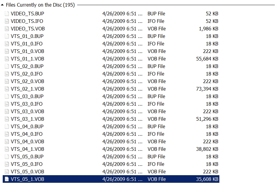

I looked up an old DVD I created with DVDFlick in 2009.
I wrote it to DVD with CloneDVD2.
The list of files is too long to take a screen shot of but you can see it has 195 files.

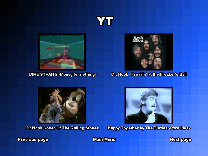

I did the menu so they can be selected as needed.
What I would like to know is how you created a compliant DVD from a .MP4 file with just ImgBurn.
AFAIK this is not possible.

One page of the menu:
