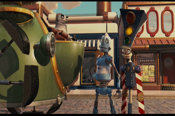

  8. Well this is unfortunate, I tested the clip I sent earlier and created a snip from the other movie I was working on, and both of the snipped portions seem to have processed more appropriately compared to processing the entirety of either film. The only thing you can probably reproduce with the snip I sent above is the issues with TFM doing a bad job fixing the pulldown. Other than that, I don't think there is a way to reproduce the issues I mentioned unless you guys have the whole video(s), which obviously isn't something that is going to happen since that isn't allowed and the obvious legal ramifications.
    I at least went ahead and got images of a couple frames to show what TFM is doing and why I didn't like it. Left is the previous progressive frame, and the right image is the interlaced frame from the pulldown being treated by TFM. The actual video in question is from the dgi source index created from the original mkv video. TFM seems to also be trying to process multiple progressive frames later in the video too, leaving behind the same staircase combing mess seen in the right image, making it frustratingly inconsistent.
    [Attachment 83895 - Click to enlarge]
  9. Horizontal lines such as in the body of the robot are going to resemble combing and be detected as such (false positive)
    Adjust your TFM settings such as cthresh or disable post processing with TFM(pp=0) to see the effect of field matching only, then if you need to change the other settings like cthresh or use a more advanced PP like clip2 if you still need post processing. To help you debug with an overlay you can use display=true - it will say "combed - deinterlaced" when pp is applied if combing is detected according to the calculation in the documentation

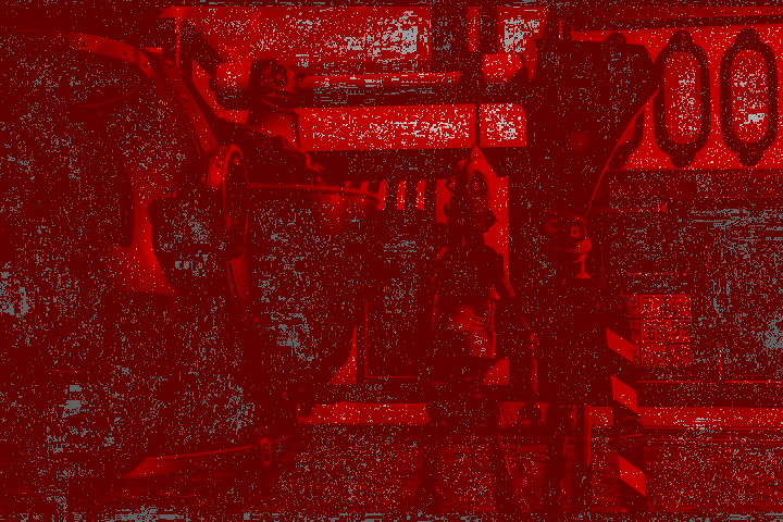

  13. Originally Posted by jagabo View Post
    With a consistent pulldown pattern you can perform a manual IVTC:
    LWLibavVideoSource("robots_snip.mkv")
    SeparateFields().SelectEvery(10, 0,1,3,4,6,7,8,9).Weave()
    This seems to cause destruction when comparing some of the frames, here is one for example.
    Original:
    [Attachment 83906 - Click to enlarge]
    Your Script:
    [Attachment 83907 - Click to enlarge]
    Comparison: (Red means differences, gray means no differences)
    [Attachment 83908 - Click to enlarge]
