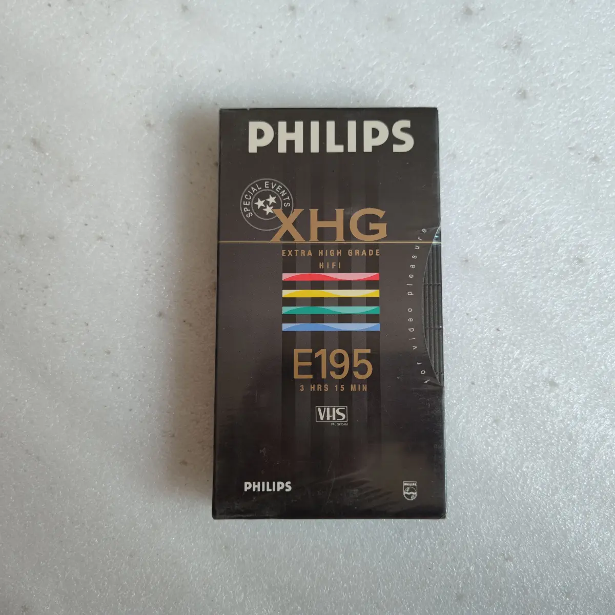

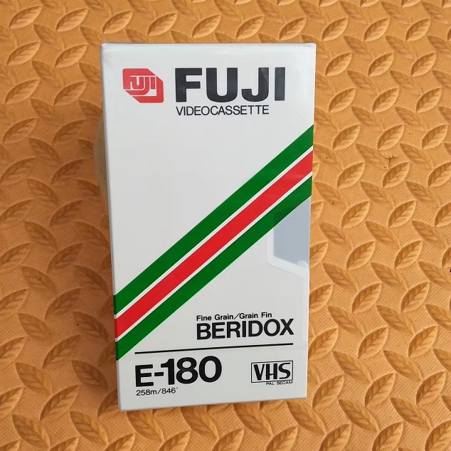

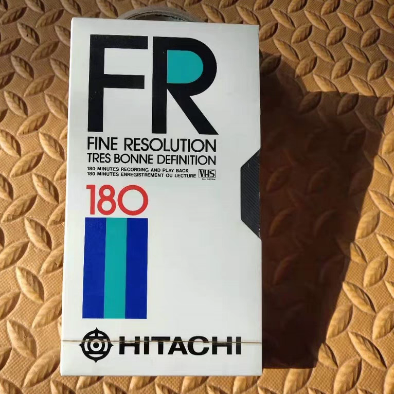

    I'm planning to record the upcoming inauguration just for old times' sake. I picked-up three NOS vintage VHS tapes and I'm wondering if anyone knows which is the best and which is the worst...
    [Attachment 83873 - Click to enlarge]
    [Attachment 83874 - Click to enlarge]
    [Attachment 83876 - Click to enlarge]

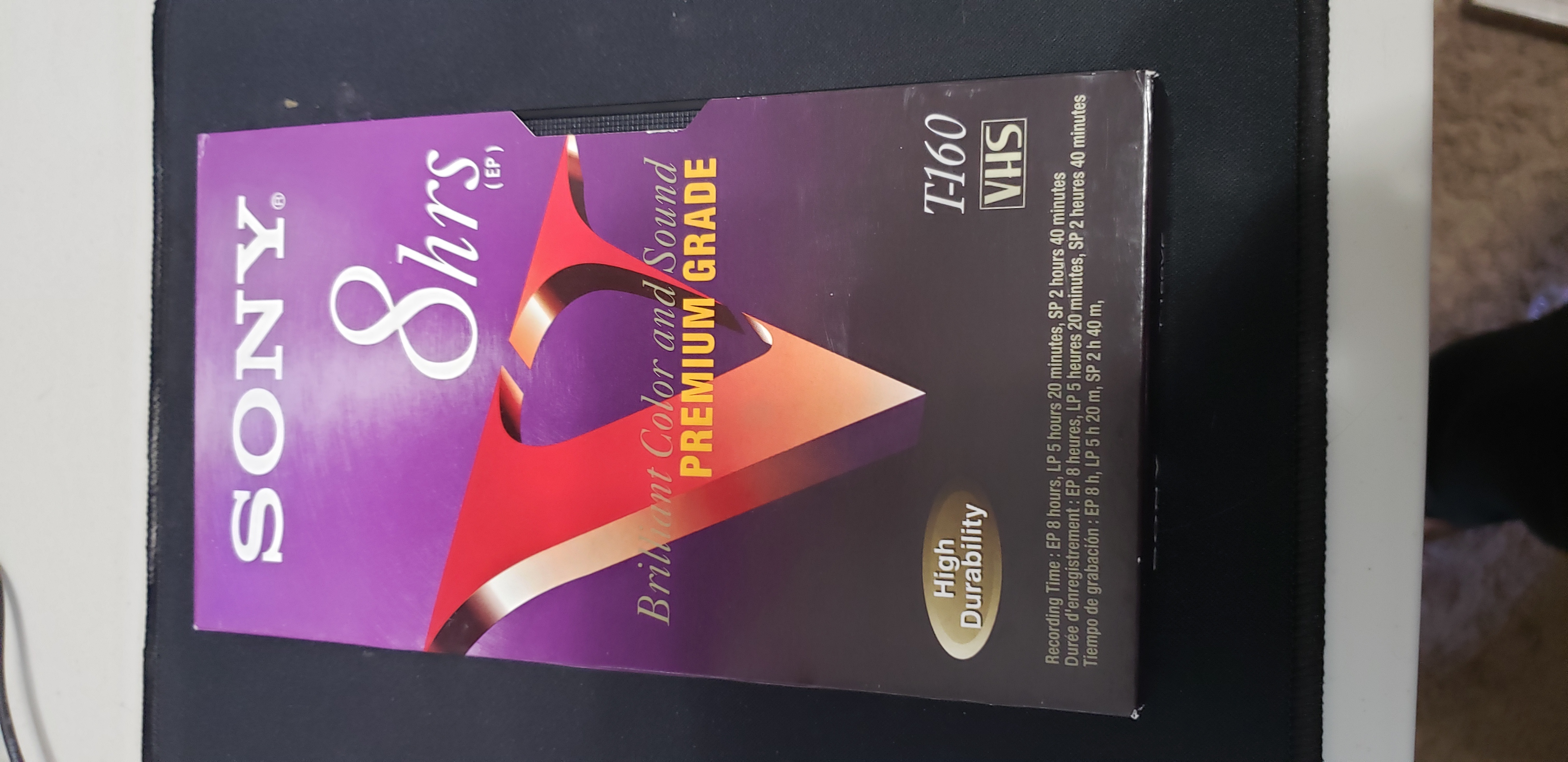

  9. Here is my milage today… These OTA recordings were accomplished with the following hardware/workflow…
    Samsung TV 2015 model UN32J5500AFXZA
    Z Jbox (link above)
    Panasonic ES-15 (with and without)
    Panasonic PV-S9670 VCR
    Sony Premium Grade VHS tape
    The OTA captures were done with my standard workstation…
    YMMV

  15. Used the Hitachi and turned out great. It's important to fire up old electronic equipment every now and then or you'll find it's completely shot when you need it.
