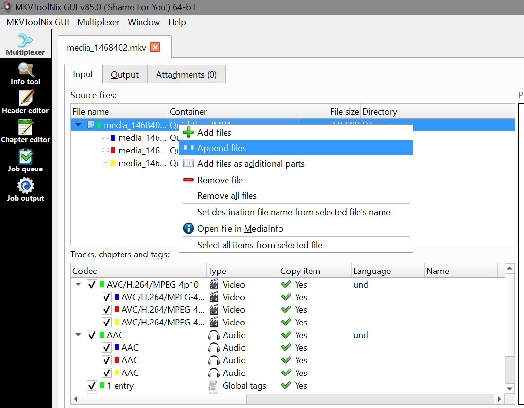

  12. You can use mkvToolnix to combine your files into one as it recognizes these m4s: add the first file, select it, right mouse click and hit append files. After then TSMuxer to change mkv into transport stream.
    [Attachment 83868 - Click to enlarge]

    I think your solutions are just different ways to do what I can do with ffmpeg. What I'm looking for is something that makes my video (mp4 or ts) capable of being cat'ed together to give a smooth, seamless video. Ultimately I'd like to deliver individual files, one right after the other, somewhat real time to have 'live' video.
    For some reason m4s files aren't that way - I'm trying to figure out how to make them be able to run one right after the other without actually merging them.
    Don't get me wrong - I appreciate your help. I'm learning a lot about other tools. But I still don't know what my actual problem is - why does the video freeze and audio continue when cat'ing the ts files?

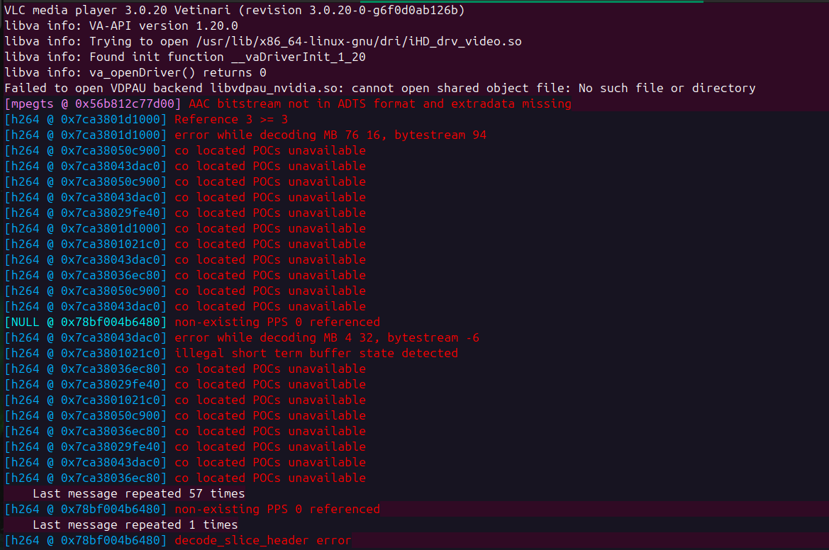

    The ffmpeg concat works well. I'm having issues with the 'looping' concat (adding files to the merge list as they're being downloaded and decrypted) and outputting to the pipe. I can't tell if it's a sync issue with adding the new files or if my processing can't keep up with 'real-time'. Not only is video crappy, VLC is throwing errors
    [Attachment 83959 - Click to enlarge]

    not exactly what sequence of a procedure you are doing, and on what end (yours, client) but you error say exactly that:
    "No such a file or directory"
    So either file is not ready or there is a syntax error in a path
    "No such a file or directory" happens when I cat video.ts : vlc - (some kind of vlc configuration issue)

  25. Error says, that it cannot load file, why it would be configuration issue?
