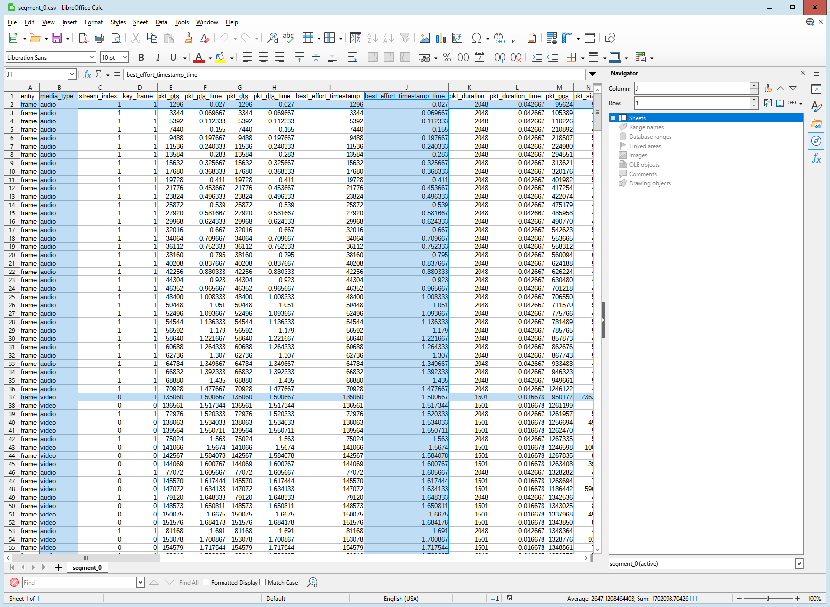

  8. In copy mode ffmpeg (or any other editor) can only cut video on keyframes. The nearest keyframe to your cut point was about 1.5 seconds after the specified cut-in time. The nearest audio frame was 27 milliseconds after the cut-in point. So when you play the A/V file about 1.5 seconds of audio plays before the video starts playing (the first frame of video is displayed for that 1.5 seconds).
  9. There is a way to find out keyframe positions for a video using ffprobe, but it takes considerable amount of time. If that was a concern. Especially using python, it is comfortable to do that. Maybe for op would be enogh to come up with second keyframe only (to start slicing there) if rest of those segment cuts turn out ok (ffmpeg lands it on nearby keyframes for some reason).
  10. Here's an ffprobe report of the start of the file in post #2:
    [Attachment 83846 - Click to enlarge]
    You can see that the file starts an audio packet, line 2, with a timestamp of 0.027 seconds. It is followed by many other audio packets. The first video packet is at line 37 and has a timestamp of 1.50067 seconds. So the media player starts playing the the audio then starts playing the video 1.5 seconds later. The exact behavior depends on the player. Some will show a black screen for the first 1.5 seconds. Some will show the first frame of video for that duration. Some may start playing the video right away but skip the first 1.5 seconds of audio.
