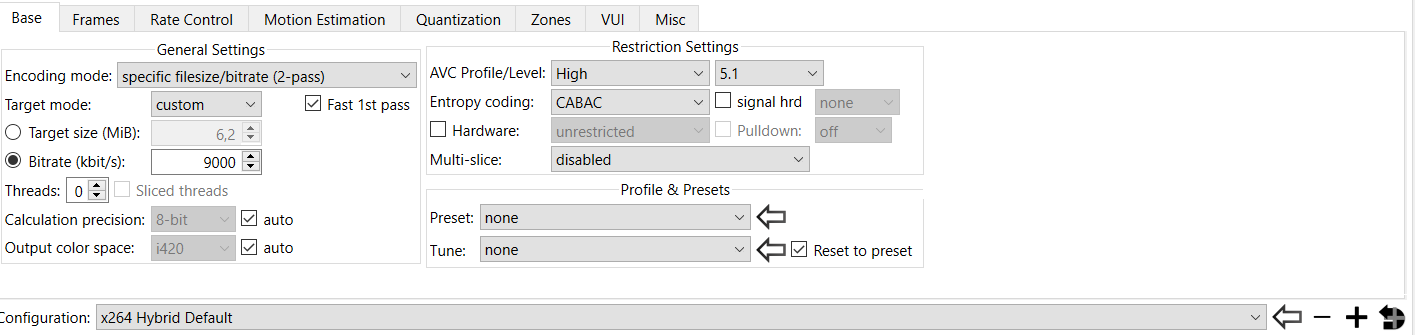

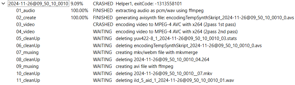

    I have images of the error in Hybrid.
    Shouldn't Hybrid be able to get it through without issues?

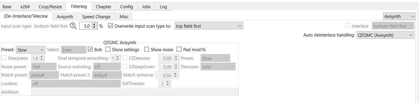

  8. No problem here ...
    [Attachment 83752 - Click to enlarge]

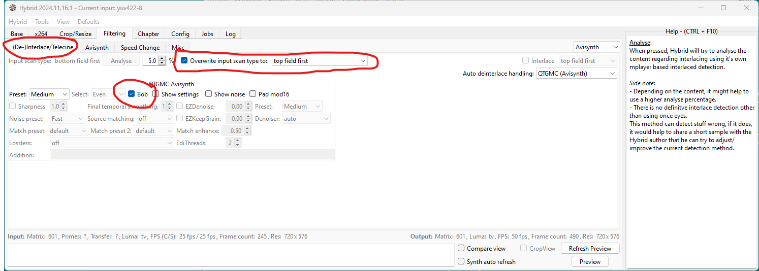

    Aug 2023
    I also have the same deinterlacing settings (except the speed), but still something is not right.Image
    [Attachment 83758 - Click to enlarge]
    should I convert somewhere in Hybrid to YV12? I see your output is yuv 4:2:0 8

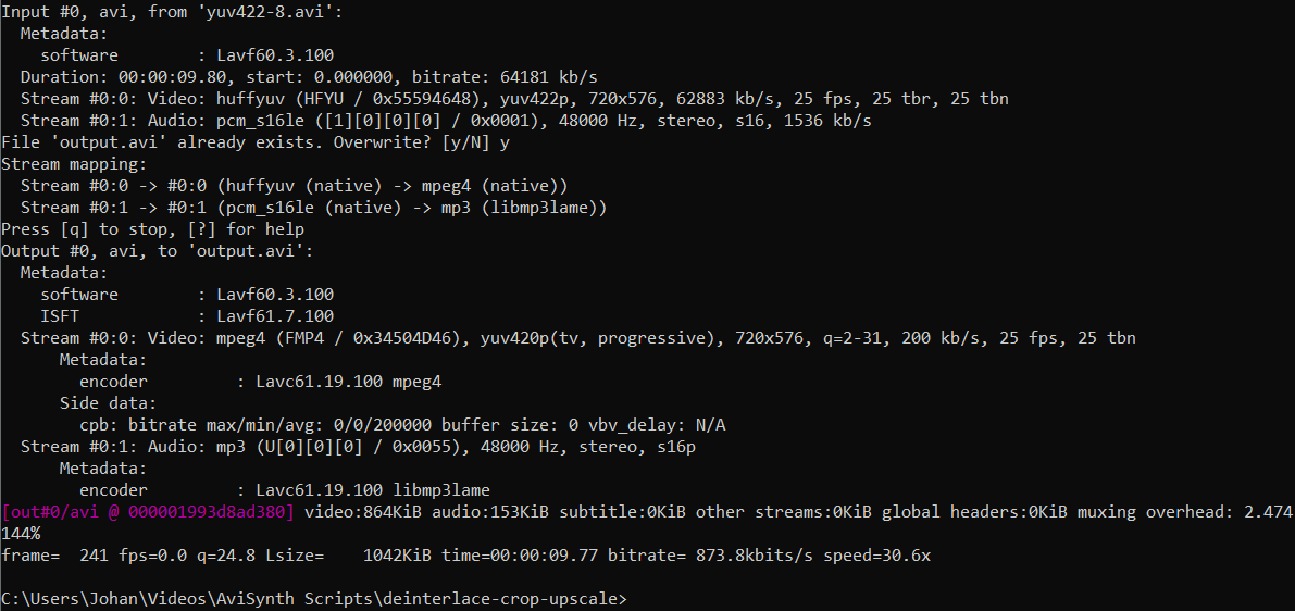

    When I write in cmd and try to convert with:
    ffmpeg -i yuv422-8.avi -pix_fmt yuv420p output.avi
    I get this:
    [Attachment 83759 - Click to enlarge]
  10. No idea what's wrong. You don't need ffmpeg.

  11. No conversion before feeding the file to Hybrid is necessary, Hybrid will:
    a. convert to color space XY if some filter does not support the current color space
    b. Hybrid will convert to the output color space set in the encoder
    The error indicates that something if wrong with either the script or the ffmpeg call.
    a. try whether the problem also happens with latest dev (recreate jobs, don't use old jobs)
    b. if it does not: Read https://www.selur.de/support and share a debug output, also create a debug output of trying the Avisynth preview. (no clue why you switched to Avisynth)
    Cu Selur

    Hello Selur
    Hybrid seems to work after uninstalling and reinstalling.
    Strange because I have no clue what in my settings were wrong
