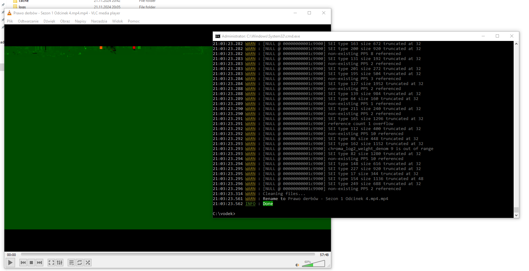

[Attachment 83638 - Click to enlarge]
this is how it looks after being downloaded with N_m3udl-re.
I even tried --use-shaka-packager but i get same result.
Can someone explain wtf is happening here ?![]()

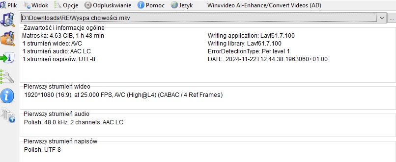

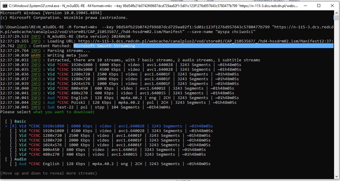

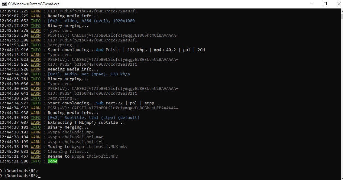

Option with two keys extracted using L3
[Attachment 83645 - Click to enlarge]
download :
[Attachment 83646 - Click to enlarge]
proof:
[Attachment 83647 - Click to enlarge]
[Attachment 83648 - Click to enlarge]
