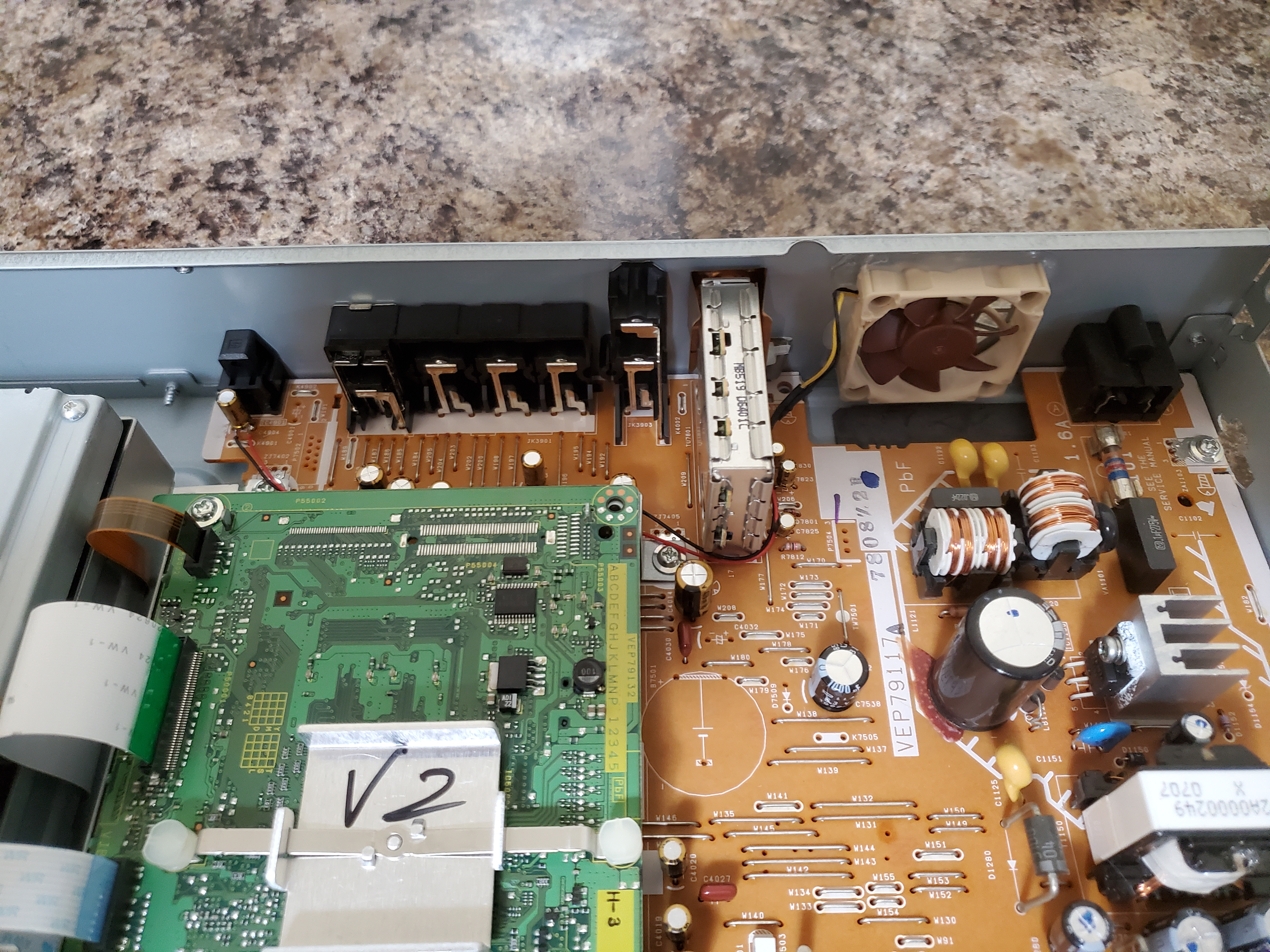

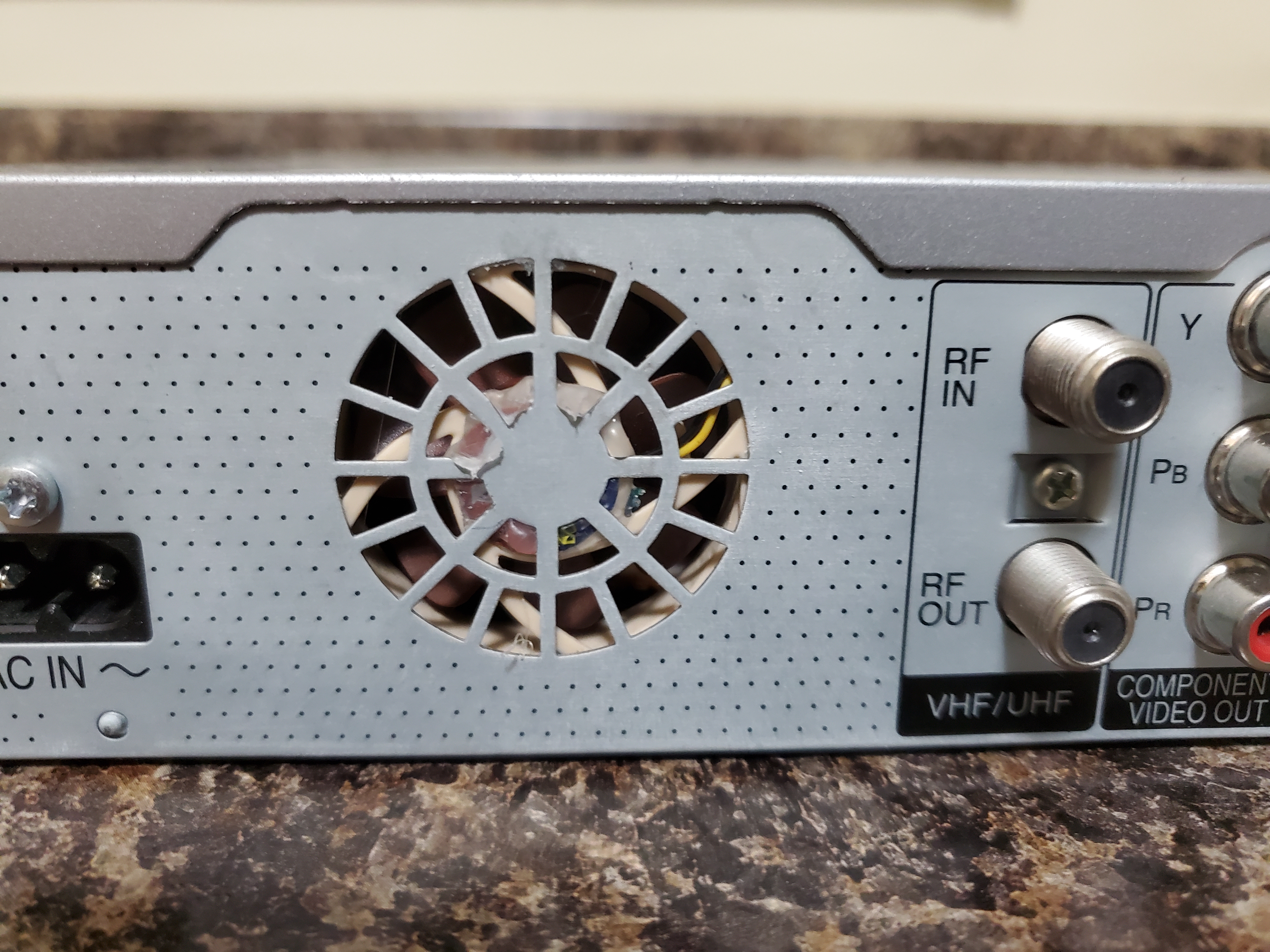

My DMR-ES16's lid gets pretty hot on it's own, which is why I think it was inserting and dropping frames on it's own, before it even reaches the capture card. I figure the chip's overheating. I also wanted to repaste the chip, but can't figure out how to pull the heatsink off.

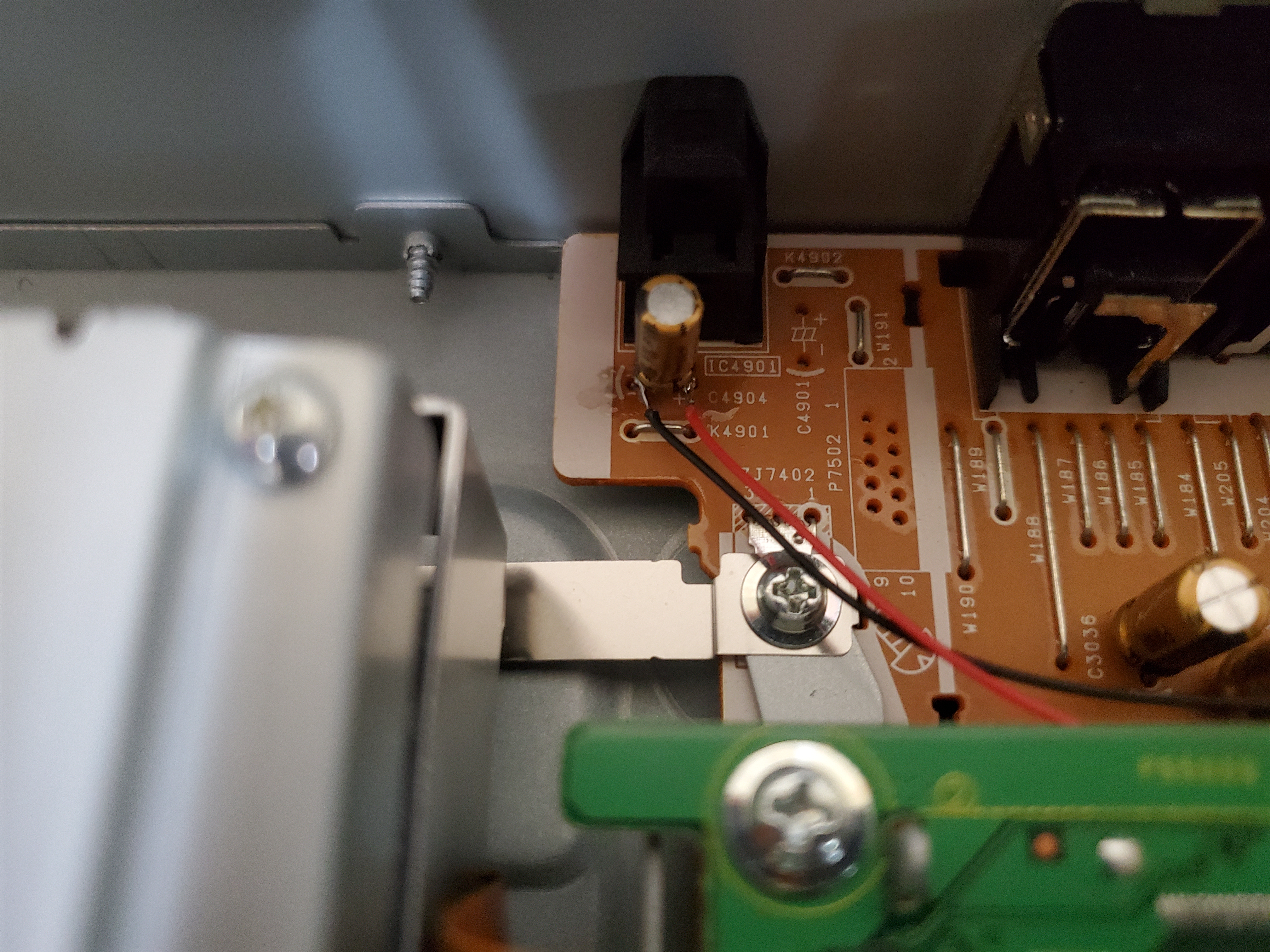

I used a Noctua NF-A4x10V PWM fan, and pulled the 5V from the capacitator directly behind the optical port on the board. I wanted to drill and mount the fan to the inside of the case, but that would mean pulling the board from the case to avoid any metal filings shorting things out at a later date.
Now... it's cool to the touch, and no more drops or inserts... or at least few and far between. The only issue is the fan turns on when the unit powers up the first time, then it stays on after power down. A minor inconvenience though... simply unplug the unit when not in use. Done deal.

It'd probably be a lot more effective to just leave the top cover off presuming that you aren't in a particularly dusty environment. Those fans that JVC and others liked to put near their power supplies probably reduce the pocket of hot air at the very top of the cabinet, but there really isn't a defined path for good airflow. In particular, there's no defined air inlet, just small amounts getting in through various thin seams in the case. Perhaps the ES-16 has some holes in the bottom to let air in, but probably not is my guess. None of the fancy JVC VCRs really had air inflow holes either and they put fans on lots of models towards the end (always near the power supplies and not near the actual chips that get hot that do the video processing). I think really all it does is reduce slow heat buildup at the top of the case really. This could matter more for DVD recorders since they have a spinning disk up there that might be prone to different heat effects.
Maybe try a capture without the fan at all and leave the top cover off and see if you go back to getting dropped frames or not?
If you want to actually cool the chips that do the conversion, you'd want to put that fan right above the digital board which is the separate green board that kind of sits in the middle and force air right down at it and then also give the air a path to escape.

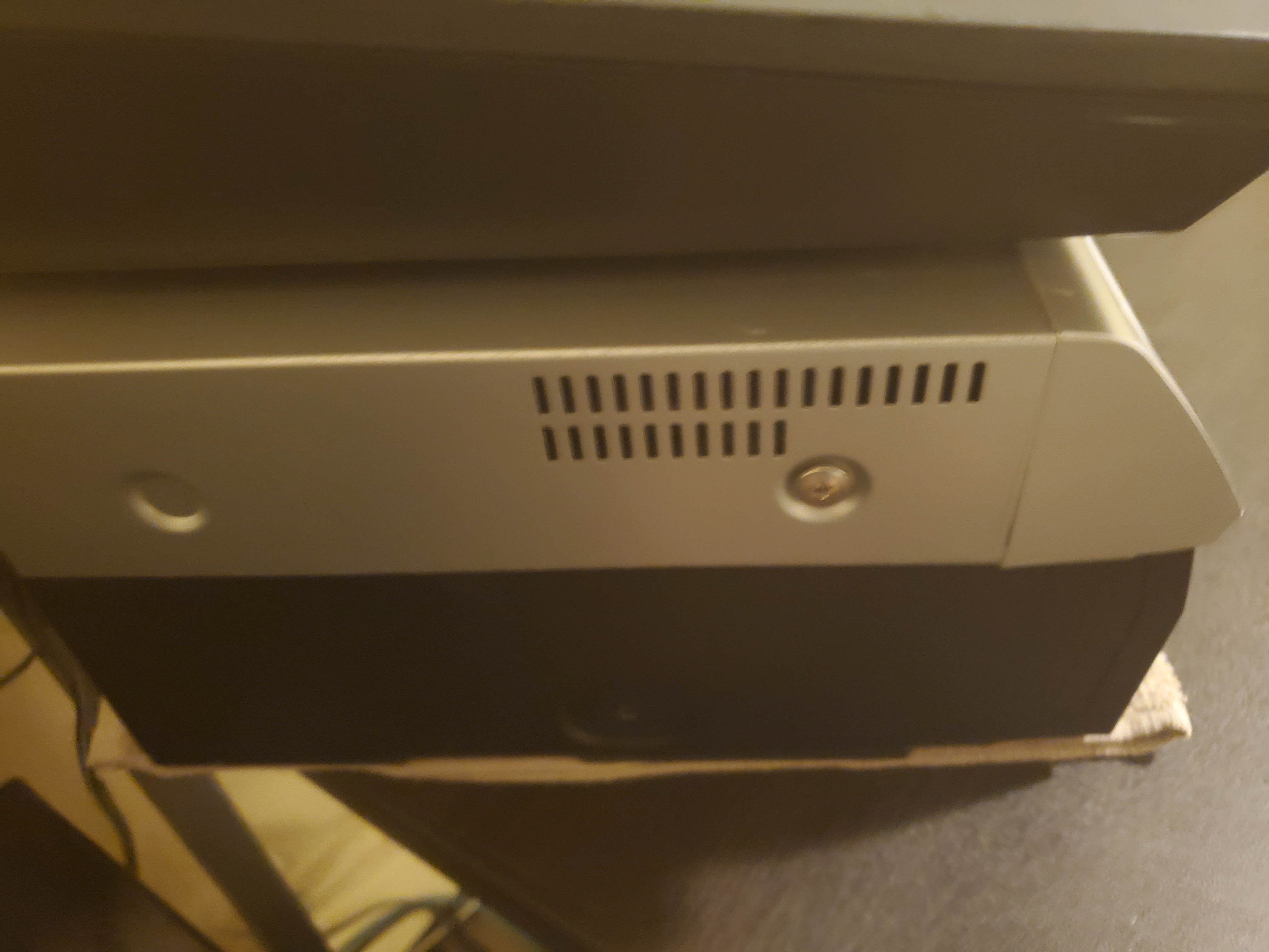

The unit has ventilation slots in the sides of the lid. It wouldn't have a rear fan port without it. Some units have an actual fan, not just the port. And although removing the lid would help somewhat, this way actually draws cool air into the unit, therefore cooling down the chip. I really do see a difference in the captures... from at least 5 to 10 inserts per tape, down to none... or very, very few, if any.

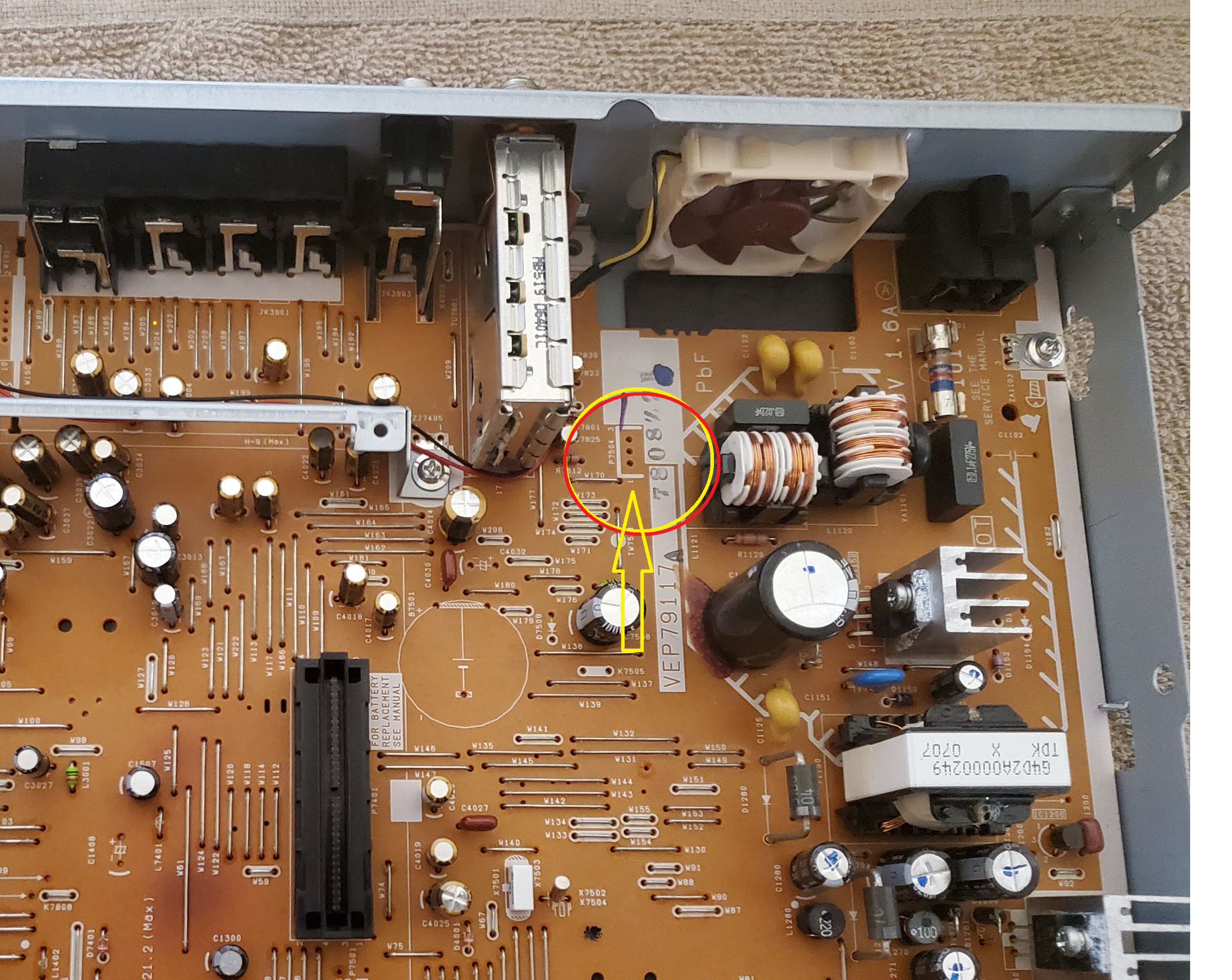

If it was designed for an optional fan I would assume it will have a fan power source, By looking at the board the closest point I see is P7504 a 3pin header, If it is the optional fan connector, not only will turn off the fan when your turn off the machine but it gives you a two speed fan operation if used with a two speed fan (3 wires) so it stays silent unless it's too hot then the second speed will kick in. You can buy those connector sockets online and get a correct 2 speed fan with the corresponding connector.

Well, unfortunately there is no 3-pin header, unless it's hidden somewhere, or the pins themselves just haven't been soldered in. And although I got the green board unscrewed, I could only release 1 of the 2 push tabs. I didn't want to fight with it.
[Attachment 83636 - Click to enlarge] -
There is no pin header, just through holes, To see if P7504 vias have solder on them you will have to look underneath the main board unfortunately, then you can solder a new pin header, If you don't feel comfortable doing it just live with what you have. Although there should be plenty of switched 5V and 12V points on the board, no need for the fan to stay on, Good luck.
[Attachment 83637 - Click to enlarge]Last edited by dellsam34; 21st Nov 2024 at 12:53.
Holy crap... good eye! I definitely need new glasses.
Usually pulling the board isn't an issue for me, as I used to modify D!shnet satellite boxes. (Well.. I converted Bell XPressVu into D!shnet... same parent company, so models were basically the same boards). I originally wanted to drill and screw mount the fan, but wasn't sure how involved pulling the board would be. But after lifting the green board, there's not much more to it, except for the front panel and DVD tray. I can pull the board, remove the front panel, then tape and wrap the drive with a plastic bag. Unless it comes out just as easily. Even if it doesn't have vias connected with the pin holes, I'll look for a temporary source that terminates upon shutdown. The cap I'm using now wasn't powered when the unit was plugged in, only once it was powered on... then stays on after powerdown.
I really only need this for 30 tapes... the entire 65-hour Woodstock 99 PPV. After that, I only have a few hockey tapes, then I'm done with it. I was only sharing for others that may want an upgrade. I didn't even notice it was running at first... I have a space heater in fan-only mode as white noise, and it wasn't until I unplugged to move it that I noticed the hum of the Noctua. The easiest solution is just to use a powerbar... flip the switch when done.
Side note: mounting fan inside has a tiny bit of whirrr, but mounting outside on the back was worse. -

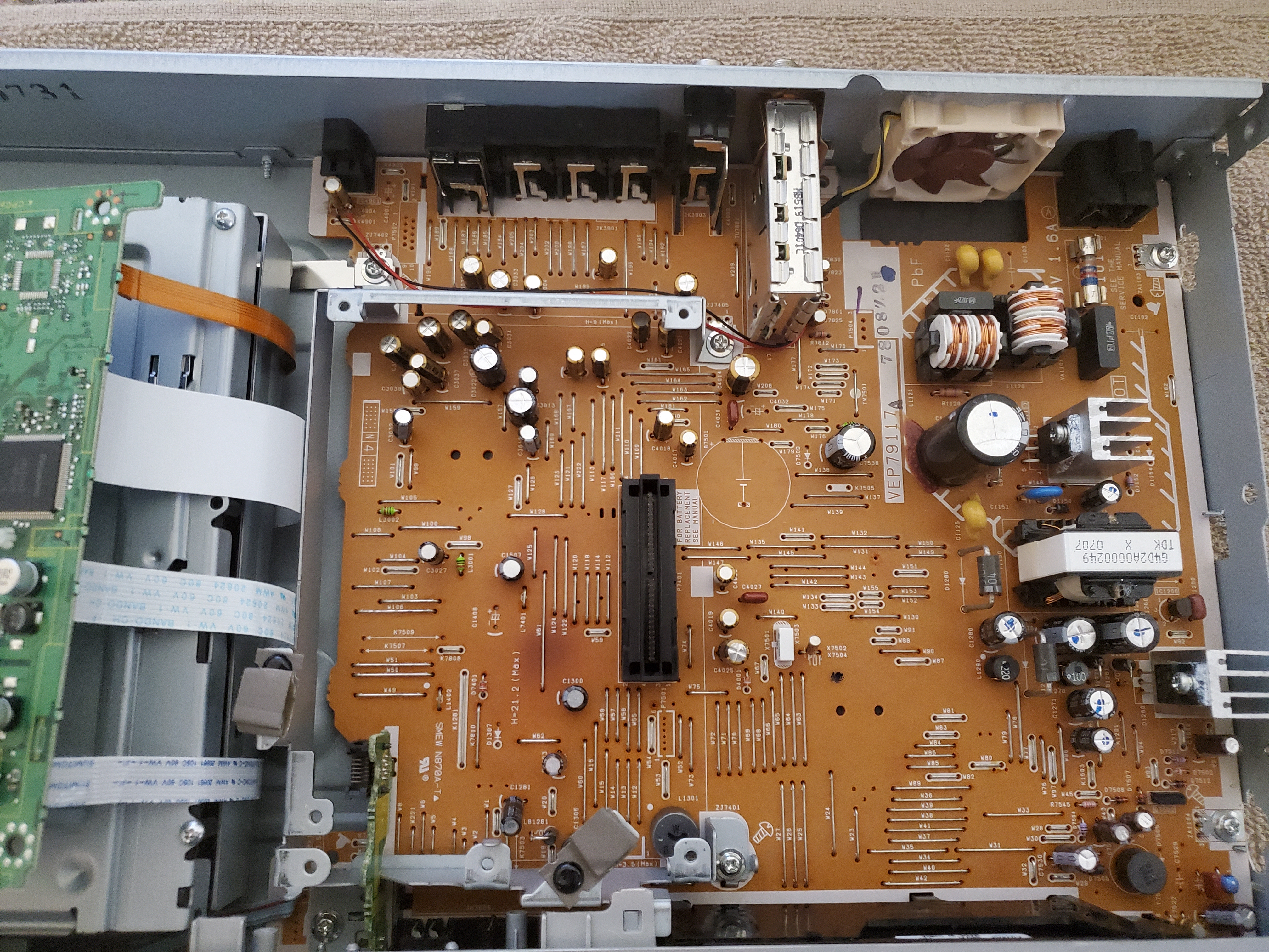

Well crap. After pulling the controller board, the RCA audio out jacks are silent. My project is 30 tapes long, all spliced together, so I capture everything first, then edit one by one. It wasn't until I started editing that I noticed there was no audio. Input works, and optical out works... so I connected a 192K optical to RCA digital to analog converter. I know that's analog (vcr) -> digital (DMR-ES16's optical out) -> analog (optical to RCA adapter) -> digital (capture card), but I figured that the DMR-ES16 passes the audio and video through a buffer anyway, so even that's analog->digital->analog->digital. There's 120~125ms a/v delay if I bypass the DMR with the audio.
So now... I have to recapture everything yet again. This time I have VirtualDub's volume meter displayed during captures. I'll deal with the controller board later. My guess is a loose ribbon cable after I fiddled with it. Hopefully. -

I was thinking I bent a pin or something reconnecting the board, but then if that was the case, then the connectors wouldn't sit flush. That's why I was thinking one of those ribbon cables might be slightly loose, or just not sitting in it's connector properly. That's why I'm waiting until I finish capturing before tinkering again, incase I make it worse. I didn't want to mess with it until finishing the first time around, but gave in to curiosity. Blah.
