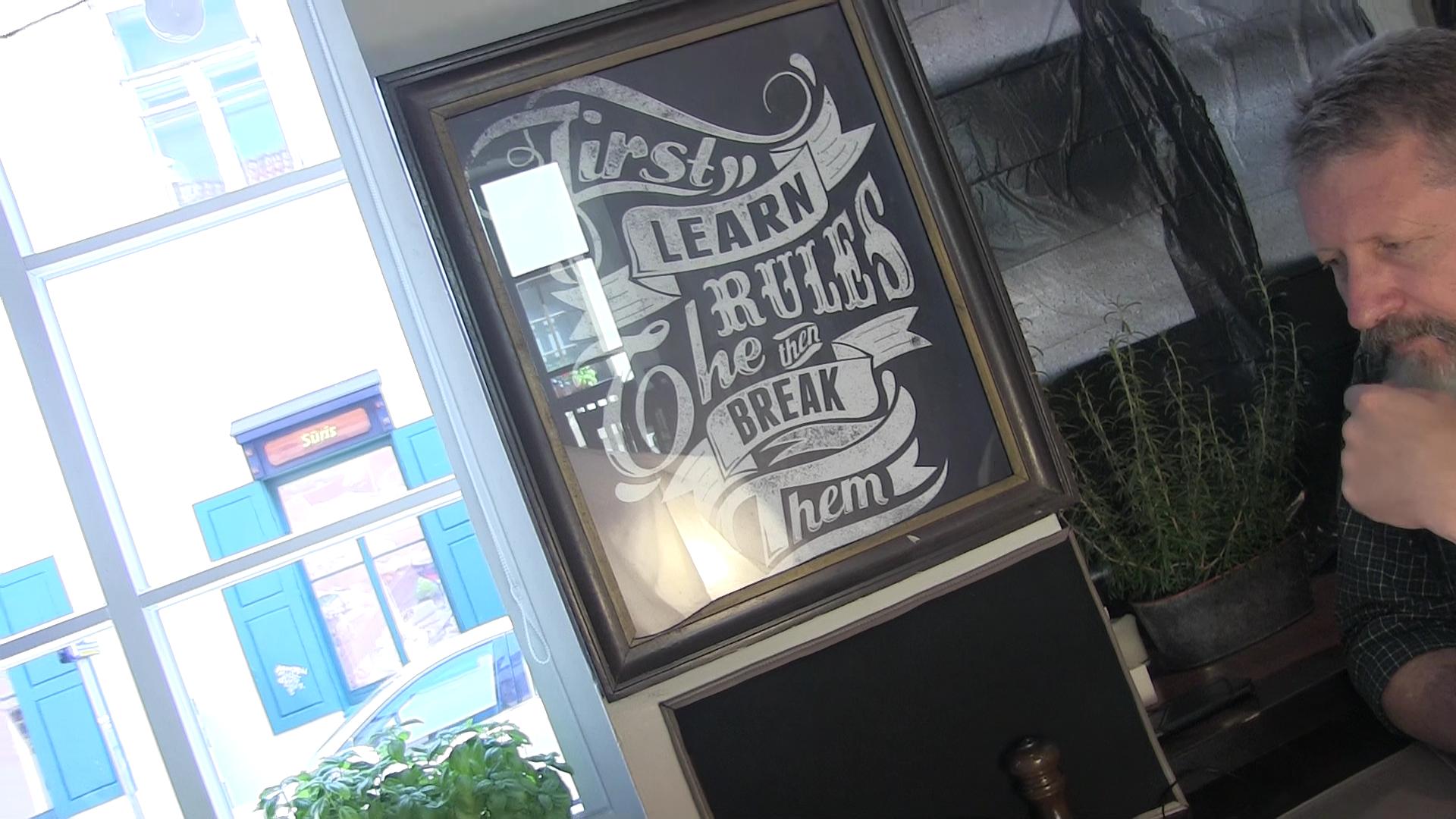

    The first line uses mt_edge() to builds map of edges within the image. So a frame that looks like this:
    [Attachment 84112 - Click to enlarge]

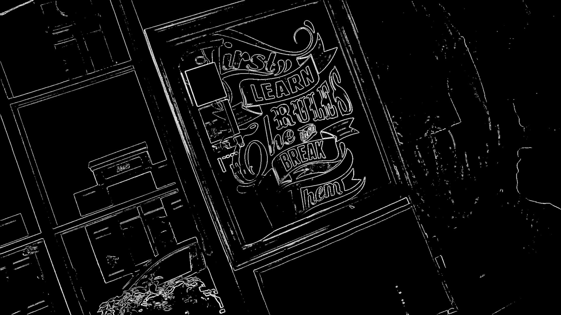

    gives an edge map that looks like this (note that the map is an image so it can be viewed):
    [Attachment 84113 - Click to enlarge]
    Then that map is used to overlay a sharpened version of the image (Sharpen(0.5)) over the image (last) only where that map (mask=edges) is non-black. Where the mask is full black the image is unchanged. Where mask is full white the sharpened image fully overlays the original pixels. In between values of the mask give a weighted blend of the two. The result here is that sharp edges in the video are made even sharper -- without sharpening or increasing noise in other parts of the picture. The mask was blurred a bit to spatially soften the transition between the two (sometimes the transition can create obvious discontinuities in moving video).
