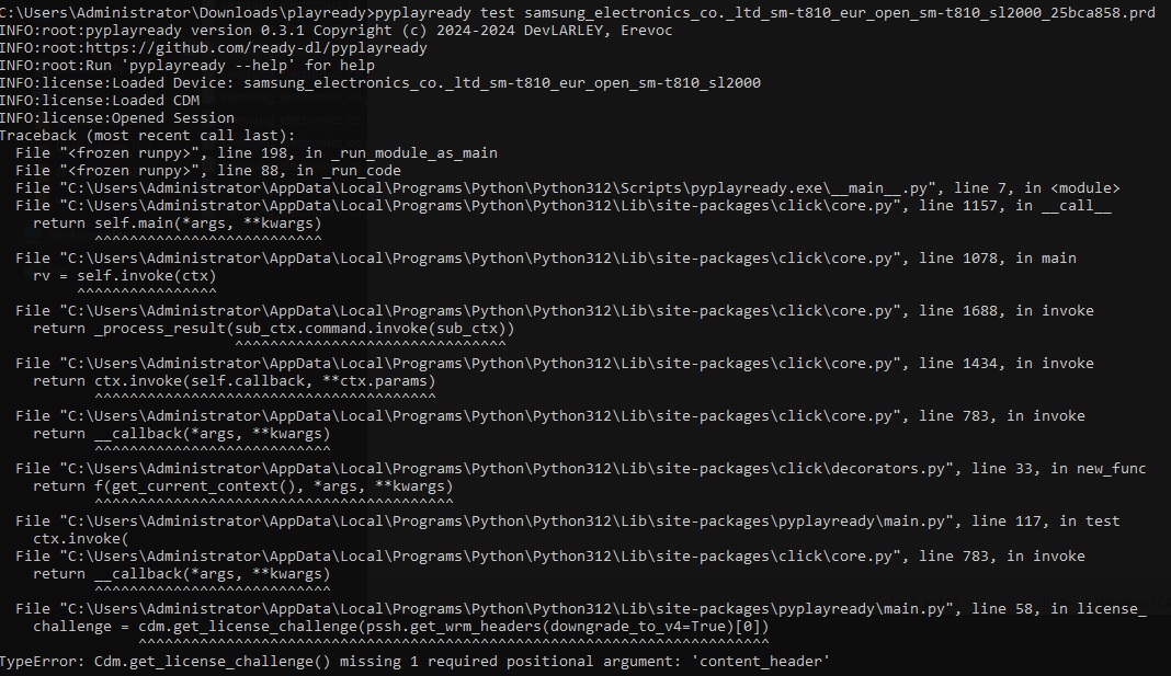

  6. Originally Posted by Silv3r View Post
    (pyplayready-main) PS C:\Scripts\pyplayready-main> pyplayready test .\samsung_electronics_co._ltd_sm-t810_eur_open_sm-t810_sl2000_179feffa.prd
    INFO:root:pyplayready version 0.0.2 Copyright (c) 2024-2024 DevLARLEY
    INFO:root:https://github.com/ready-dl/pyplayready
    INFO:root:Run 'pyplayready --help' for help
    INFO:license:Loaded Device: samsung_electronics_co._ltd_sm-t810_eur_open_sm-t810_sl2000
    INFO:license:Loaded CDM
    INFO:license:Created License Request (Challenge)
    INFO:license:Got License Message
    INFO:license:License Parsed Successfully
    INFO:license:6f651ae1dbe44434bcb4690d1564c41c:88da852ae4fa2e1e36aeb2d5c94997b1

  8. Originally Posted by PSXman_uk View Post
    I get the same problem. Does not work under latest version 0.3.1. You are running an older version 0.0.2.
  9. The example script from the repo's README works though.
  10. I imagine the prd files are fine. Just the test function broke in subsequent versions for some reason.

  12. Originally Posted by PSXman_uk View Post
    Enjoy !
    Thank you
    Thank you, you are correct
    The new version 0.3.3
    pip install pyplayready
    and
    pip install pyplayready==0.3.1
    the "TEST" does not work, on anything older "test" does work
    pip install pyplayready==0.1.0
    or
    pip install pyplayready==0.0.2
    or
    pip install pyplayready==0.0.1
    If I was in politics I make sure you drink plenty of beer
    and watch plenty of TV to keep you busy. | Data is the new oil.
  13. Jep - the main.py scripts needs an update:
    diff --git a/pyplayready/main.py b/pyplayready/main.py
    index 88ff60d..2fd5b93 100644
    --- a/pyplayready/main.py
    +++ b/pyplayready/main.py
    @@ -55,7 +55,7 @@ def license_(device_path: Path, pssh: PSSH, server: str) -> None:
         session_id = cdm.open()
         log.info("Opened Session")
    -    challenge = cdm.get_license_challenge(pssh.get_wrm_headers(downgrade_to_v4=True)[0])
    +    challenge = cdm.get_license_challenge(session_id, pssh.get_wrm_headers(downgrade_to_v4=True)[0])
         log.info("Created License Request (Challenge)")
         log.debug(challenge)
    @@ -75,10 +75,10 @@ def license_(device_path: Path, pssh: PSSH, server: str) -> None:
         log.info("Got License Message")
         log.debug(licence)
    -    cdm.parse_license(licence)
    +    cdm.parse_license(session_id, licence)
         log.info("License Parsed Successfully")
    -    for key in cdm.get_keys():
    +    for key in cdm.get_keys(session_id):
             log.info(f"{key.key_id.hex}:{key.key.hex()}")
         cdm.close(session_id)
    The session_id parameter is missing three times in function calls.
    pyplayready test Device.prd
    INFO:root:pyplayready version 0.3.3 Copyright (c) 2024-2024 DevLARLEY, Erevoc, DevataDev
    INFO:license:Opened Session
    INFO:license:Clossed Session
  14. thx a lot and i guess will be revoked soon like shared widevine devices?
  15. Fixed in v0.3.5
