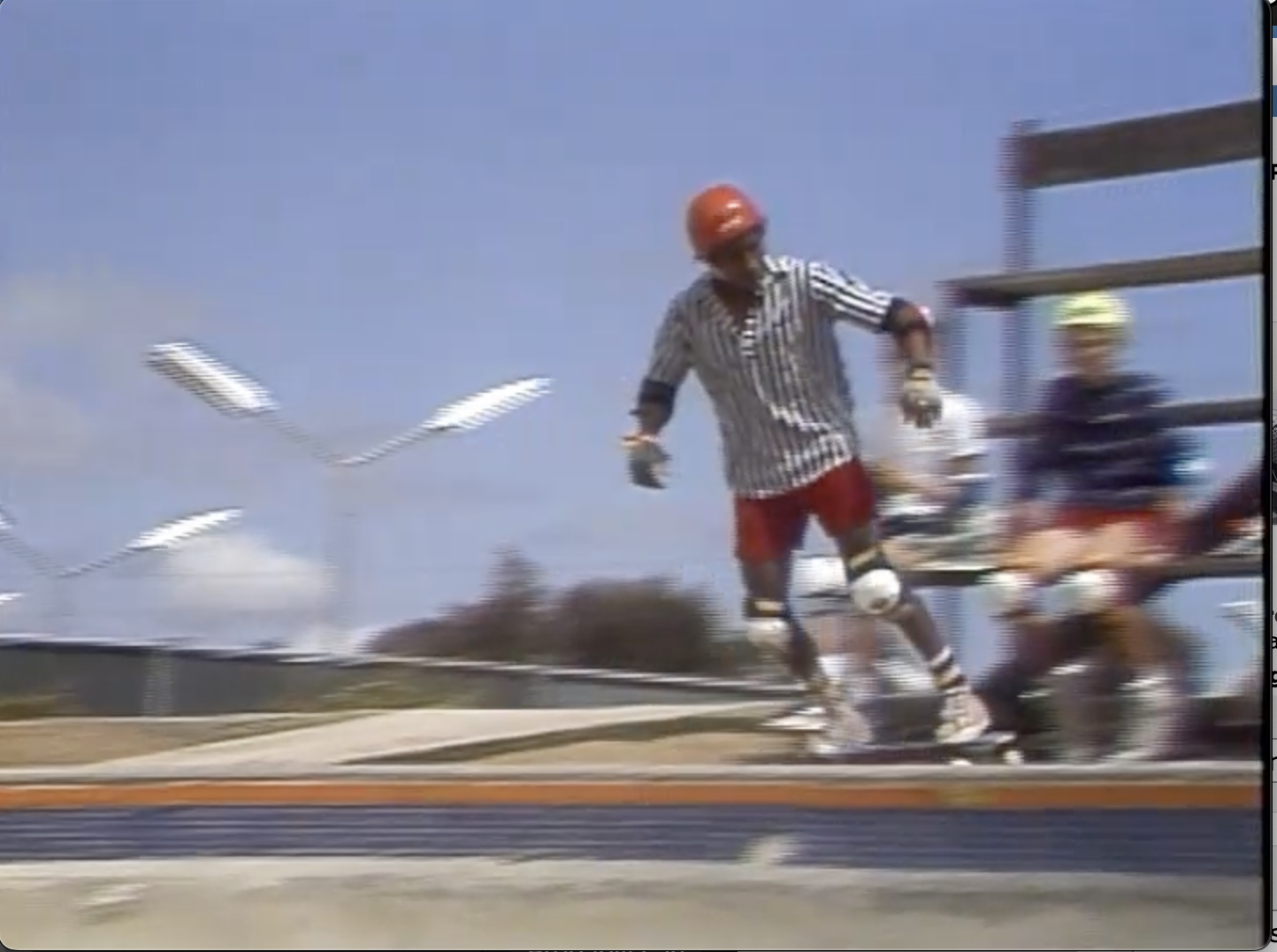

Hi. I have several video files that appear to have a baked-in interlacing that I'd like to fix. The clips are showing as progressive scans at 720x540. I'm guessing they came from a DVD and were resized and deinterlaced improperly?
Here's a short example of a clip: [URL="https://drive.google.com/file/d/1EwTouWEtvHDWTzMs8XZu_tkRpB0Pb-vX/view?usp=sharing"]
[Attachment 83487 - Click to enlarge]
I have FFworks w/ffmpeg running with it and have tried several things but nothing as made it look much better. Temporal Field Interlacing made it look smoother but quite blurry. Thoughts?
Jared

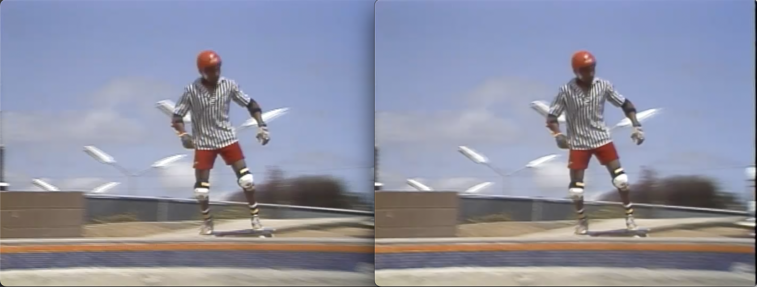

Thanks Dave. I'm on a Mac so I believe I'll have to try something else. That said, I use FFworks w/ the FFmpeg engine.
It appears that Debilinear does more than resize but just as a test, using FFworks, I resized the vertical resolution to 480 and then used YADIF to deinterlace.
Here are the results...On the left is resized to 480 and on the right is after YADIF. Looks pretty good.

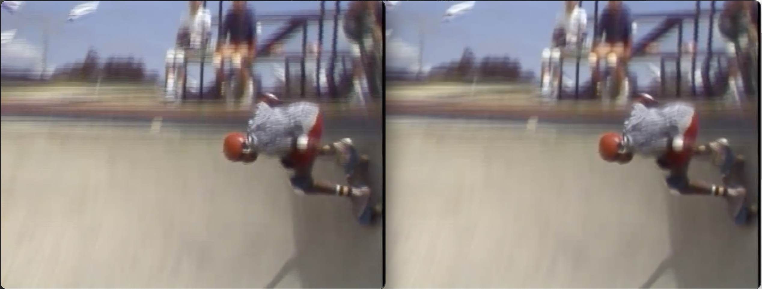

But on this frame, there's vertical camera movement and the right frame with YADIF actually looks worse. Thoughts? I really appreciate the help.

Yes debilinear is a desampling function, to undo the effects of the resize (presumably) from 480 > 540.
Once interlaced material is resized the two fields are co-mingled and it's saved as a progressive file - it's pretty much ruined.
By using a desample, you get back (more or less) the two fields which can then be separated and processed properly.
Other methods involve reducing the height (to decrease the artifacts) then resizing it back.
For example, reduce the height by half then upsize
There are other members of the forum here who know this stuff pretty well. You may get further info on thisCode:bicubicresize(width,270).bicubicresize(width,540)
avisynth is available on a Mac now, there are MacOS releases
https://github.com/AviSynth/AviSynthPlus/releases
Alternatively, vapoursynth is probably more cross platform friendly, and can use descale for vapoursynth
https://github.com/Irrational-Encoding-Wizardry/descale
There is bit of a learning curve for either avisynth or vapoursynth . There might be some GUI's like hybrid which bundle everything and make it easier to use at first
I do not think ffmpeg/libav have descaling kernels yet -
