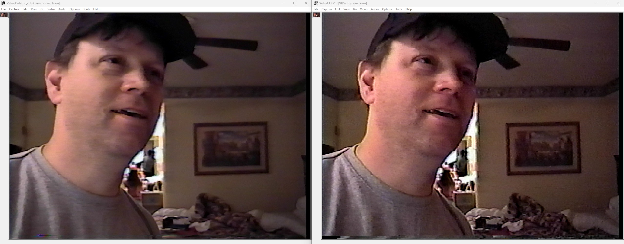

    I'm trying to digitize the VHS home videos my parents recorded over the years. My understanding is that their camera recorded onto VHS-C tapes, then they copied the footage to regular VHS. Many of the tapes have multiple copies. I'm recording every copy of every tape and only saving the recordings with the highest quality (because some of the copies are not in good condition).
    I thought, since the VHS-C tapes are the source, they would be the highest quality. But I was surprised to find that all the VHS-C tapes are in some ways inferior to their copies. Their video quality is blurry and less detailed and the audio is balanced better in the VHS copies (speaking is significantly louder than background hiss in the VHS recordings). The only thing that really makes the VHS-C tapes better is that sometimes they have segments at the beginning that were cut out of the VHS copies.
    I've attached an example of the difference in picture quality (not the best example of the audio difference, it sounds good here and other tapes are much worse, but I'm mostly asking about the picture quality right now).
    See how the detail of his beard isn't as clear in the source tape? The VHS is grainier, but more detailed. I've tried to recreate the detail by sharpening the VHS-C recording, but it ends up looking worse than the VHS tape and still with less detail.
    My questions are...
    1) Is the extra detail in the VHS tape just an illusion caused by the change in format and/or enhancement settings on the VCR that was used to copy? If it's not an illusion, how could the copy possibly have more detail than the source?
    2) Which one of these recordings should I save? The VHS-C has a segment at the beginning that the VHS lacks, but if I append that segment to the VHS recording, the sudden jump from blurry to more detailed quality looks insane.
    3) Is there any way I can just make the VHS-C recording look more like the VHS recording using VirtualDub? I've only tried sharpen and that didn't do it, but I'm not sure what to try next.

    Definitely some image "modification" occurred when copied to the VHS. Look at the noise on the walls and ceiling. Also, the edges are much more defined; the experts will probably expand on that but I'd say the VHS VCR was set to sharpen and other enhancements to the image.
    I think, from a "raw" or "baseline" point of view, your VHS-C capture looks better and would come up better. On the other hand, some areas (eg the bloke's beard) could be slightly lacking in detail in the VHS-C video; the result of old tape age (although I assume the full-size VHS is about the same age...)?

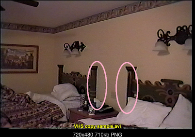

    Here a comparison: https://imgsli.com/MzE3NzY0
    Another one: https://imgsli.com/MzE3NzY4

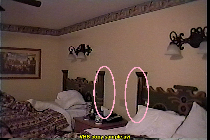

    This depends in part on the over sharpening performed by the player in the vhs copy capture, you can see a clear oversharping halo here:
    but that does not explain all. Even with advanced post processing is impossible to remove the blur and match the details of the two captures. There is also somehow a "distorsion" in the vhs-c capture.
    So my impression is that something just went wrong with the vhs-c capture, i.e. bad adapter, different hardware (BTW, what is your workflow?), different day of the week (just joking), ...

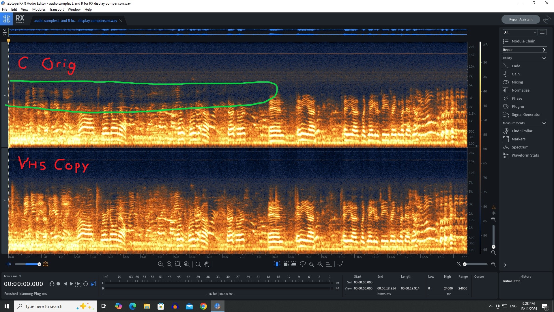

    Yes it seems very likely the main problem here is AC head azimuth misalignment.The black band in the upper trace, (circled in green) represents a loss of signal. We can see it intact in the copy transfer below it. This is classic audio comb filtering. I cant think of any other reason for the particular audio loss as shown in the spectrum trace below. One band of frequencies.
    When there is such a loss in such a band , (3 to 4 kHz) we can expect there to also be losses in higher frequencies, which we can also hear in the audio and see in the trace. The highest captured frequency extends to about 5 kHz. Whereas the VHS copy extends to about 7 kHz.
    Again, likely the copy is also somewhat azimuth misaligned, either in the playback on the OP's JVC, or at time of copying VHS-C to the VHS, or a bit of both, just not as badly in sum. Unfortunately any error at time of copying from VHS-C to VHS is now 'baked in' to the copy and cannot be removed. Whereas the original VHS-C tape will have no such error. Of course we could recapture the VHS copy with linear audio azimuth aligned but there would be no point as best picture and sound will be in the original. So long as the azimuth error re the VHS-C tape is adjusted out at the JVC at time of digitising, the full audio spectrum should be extracted.
    And as already covered, any other audio 'generational losses' will be bypassed when capturing from the original tape.
    Important: aligning linear audio azimuth on one tape recorded on one camcorder or VCR, should make it automatically aligned to all tapes recorded on that same camcorder or deck, or close to it.
Name:	Audio comparison spectrograph VHSC top marked.jpg

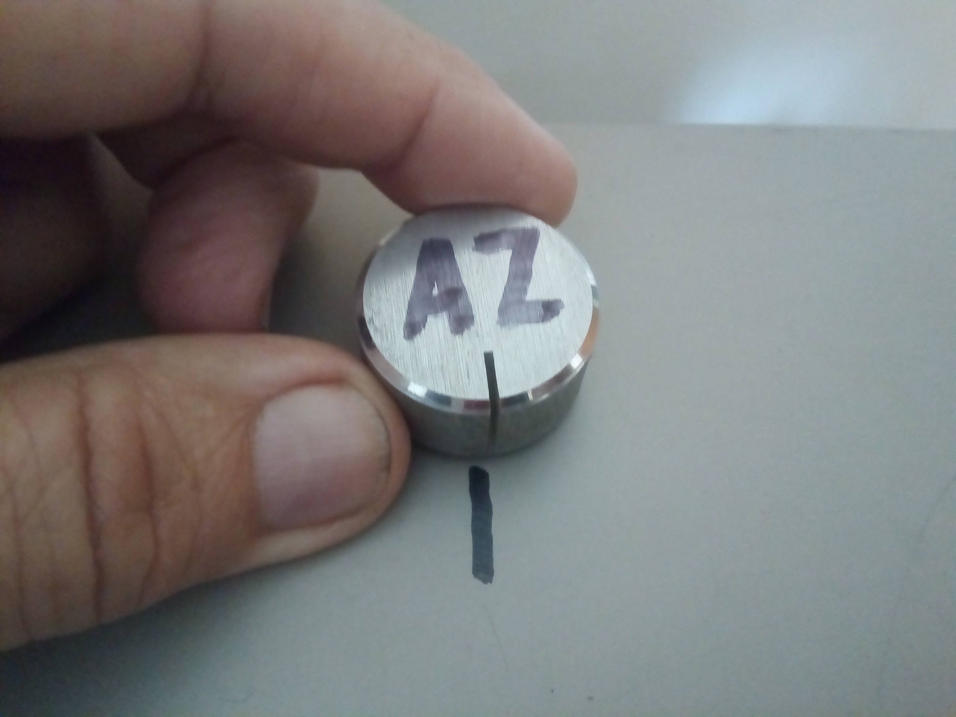

    The simple custom mods I made for my own machines make adjusting azimuth as easy as adjusting the factory fitted picture tracking control. No need to open up the deck and poke around with a screwdriver! Safe and quick. Done in seconds.
    I knocked up the external adjuster in an hour.
Name:	VHS azimuth adjuster.jpg
