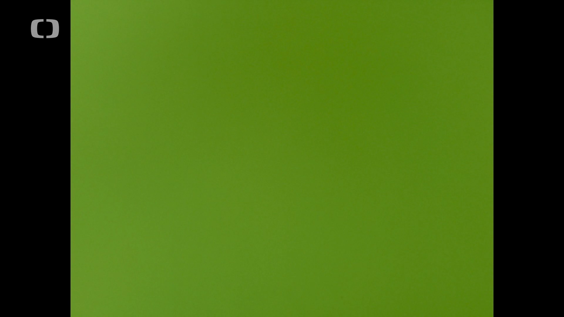

    It's a matter of principle and I don't want any loss of quality, which is not absolutely necessary in digital technology.
    Now my problem. I have HD material from restored films. But the recording service has its channel logo in it. The material is even encoded in the Blu-Ray standard. Tmpeg Authoring Works (which is very strict) accepts it and doesn't want to re-encode it.
    The channel logo could be covered by a subtitle track using the old trick. But not every player interprets such a track in the same way. Sometimes you have flickering and when skipping the effect that the subtitle disappears and yet the logo is still visible. Also, if you select a different subtitle track, the logo cover disappears. Not the real thing.
    The logo is completely in the black border and as I strongly suspect, the logo is only saved in the I-frames. (no motion vectors are affected)
    Now I have done the following manually:
    I deleted the first I-frame from the h264 elementary stream using a hex editor.
    I encoded an I-frame with a covered logo in the same settings (!) as the original stream.
    I used the hex editor to copy the new I-frame into the place of the old one.
    And what can I say: it works! The logo is gone and the stream is intact. Every player (even the very critical ones) does not display a logo until the next I-frame.
    So it works manually!
    The only flaw is that I have completely re-encoded the I-frame. This should also be lossless. So patch the I-frame at the position and patch the position where the logo is black.
    And I can't do that. I won't understand the 300-page PDF on the h264 codec in this lifetime.
    There should be an editor that can patch I-frames without loss. Limited to my special case. (Logo in the margin, only I-frames, only h264, only black)
    I could offer some money for it. But I don't know how many hours a codec programmer would need. And at 50 € per hour I'll soon be poor.
    What do you think of the project?

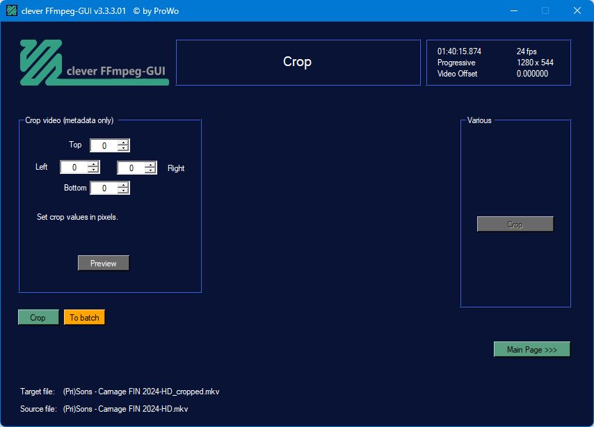

  3. You could also use clever FFmpeg-GUI and crop the video lossless, without recoding.
    But it's not supported by all players.
    Load your video, click main page, click various, click crop.
    Insert the crop values, check with the preview button, and if the result is ok then click crop.
    Done.
    [Attachment 84058 - Click to enlarge]
  4. Ok, thank you, but that doesn't help me. To many players I tried ignore that patch.

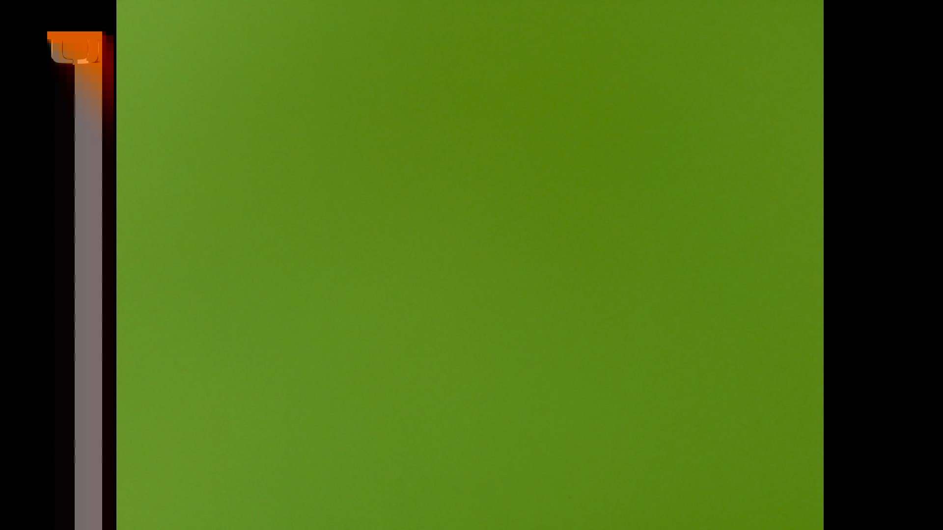

    I only want to edit the macroblocks 486 to 492 on first slice. But it seems that changing their color influence the following macroblocks down there.
    And not just at the border the green content is orange too. (not really to see here but it does - believe me, I just covered it because of movie rights) The modified blue script does the same... (in blue)
    Now I'm looking for a solution to set the pixels black without influence other pixels or mblocks.

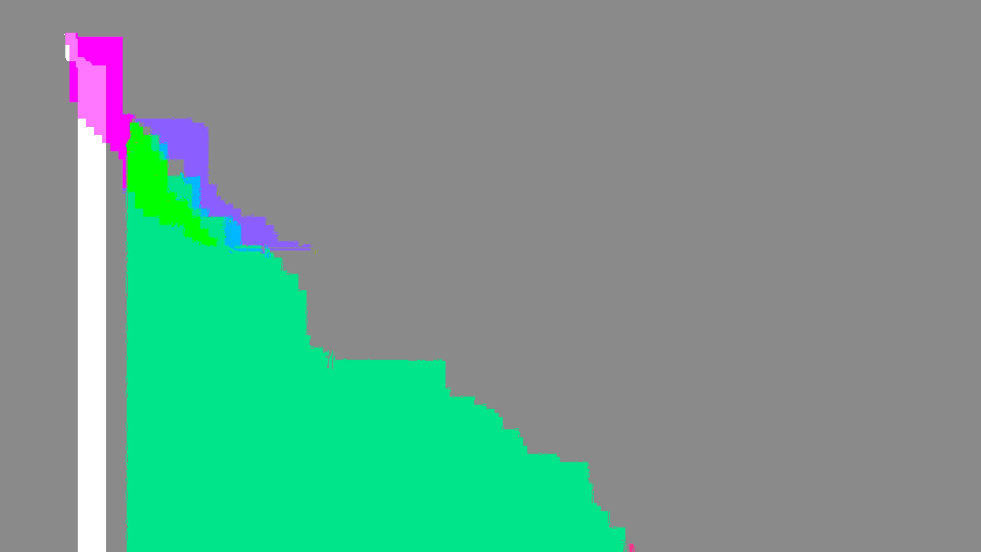

  9. The 1. for-loop iterates only to i=0 so the old code "y+37 *i" is the same as y. But I tried your code and nearly the same effect with other colors.
    Perhaps interesting the difference schema between coded and original I-frame: Here you can see which areas are effected only when I modify
    macroblock "486" (it's where the logo starts, so your code with i =0 and j = 486)
    [Attachment 84074 - Click to enlarge]
    48 MB are no problem for 10 minutes with a 2 gigabyte file (of 30 minutes)
    I counted the macroblocks in first slice which is the first I-frame with the code
    print(len(ds["slices"][0]["sd"]["macroblock_vec"]))
    the answer was: 8160 (makes sense for 16x16 because the macroblock pixels of video are 1920*1088)
    I also had an idea to copy the values from a black macroblock of the border to a logo-macroblock
    (number "0" or "2" or "8159" for example because mblocks start from the left corner on top )
    ds["slices"][0]["sd"]["macroblock_vec"][486] = ds["slices"][0]["sd"]["macroblock_vec"][2]
    but then the entire frame content is damaged.

    Unfortunately, some of the brightness information in the logo blocks is later reused in the actual image content. So, if I turn the brightness (luma) of the logo to dark, the image also becomes dark in some places. So sometimes they are connected.
    Above on the difference image you can see that if I darken Macroblock 486, then other image contents also become darker.
    The logo can therefore not be patched even when encapsulated in an I-frame.

    Why those macroblock vectors are selected with 120 step?
  14. One line has 120 mbs. And so logo is 5 lines high. I was lazy so I jumped to next line with +120
