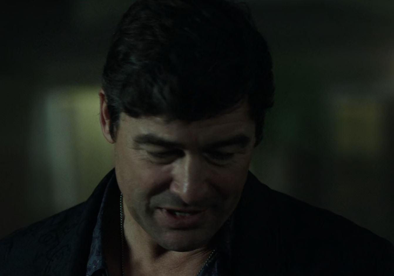

  1. Hi, I'm converting my Blu-ray collection to digital and in the process of trying to shrink these 30GB movies down to 4GB or less I keep getting particles outlining the people in the movies. I have my settings set at MKV, X265 10bit, with constant quality set to 22, speed set to slow, and constant frame rate.
    I've used HandBreak, Vid Coder, MyFFmpeg, etc.
    [Attachment 83415 - Click to enlarge]

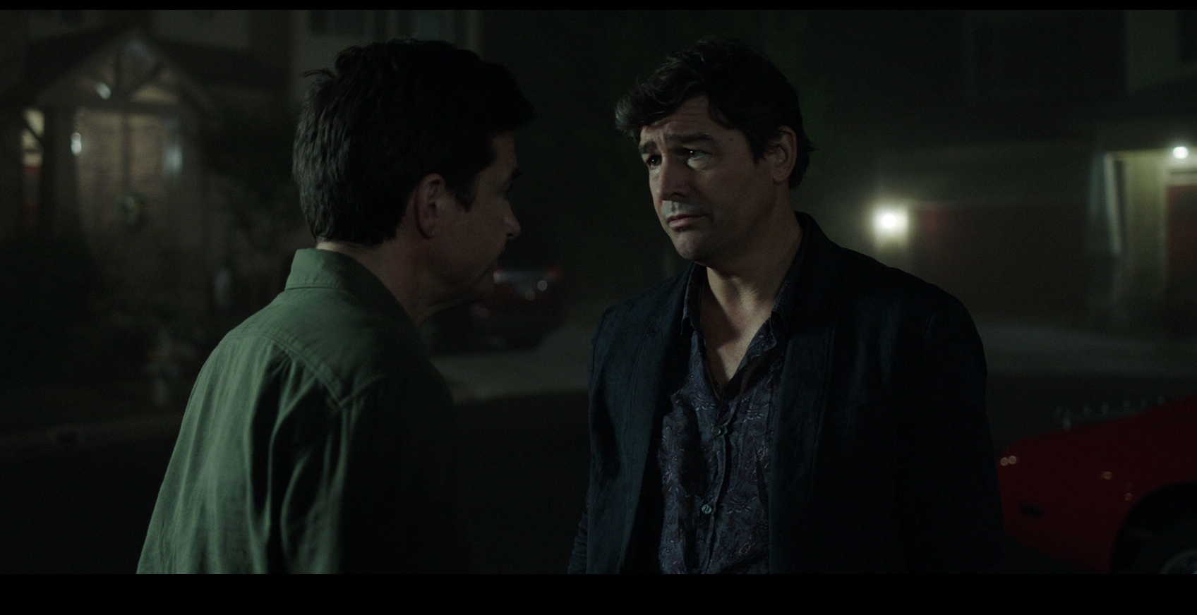

  2. This screenshot really shows how bad it is.
    [Attachment 83419 - Click to enlarge]
  3. Compression and re-encoding artifacts. One cannot expect same quality by shrinking the filesize by a factor of 1/8. You need to find your sweet spot between encoder, filesize (bitrate), frame resolution, noise filtering etc.

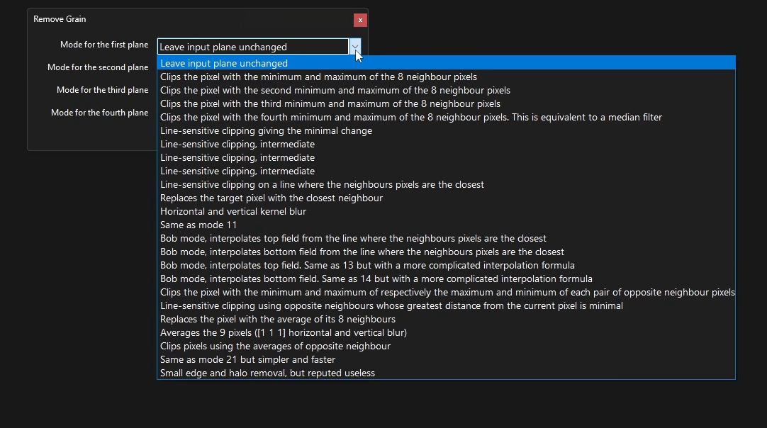

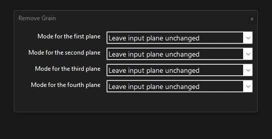

  13. Originally Posted by jagabo View Post
    The source has a lot of film grain. A lot of the compression of high compression codecs comes from not repeating parts of the picture that don't change from frame to frame. Film grain changes with every frame so it doesn't compress well. What you want to do is filter away the grain before compression.
    Another thing you can do is reduce the resolution. Fewer pixels requires less bitrate. But you loose a little detail too.
    It's all a matter of where you want to make your compromises.
    What setting do I pick to remove the grain?
    [Attachment 83508 - Click to enlarge]
    [Attachment 83507 - Click to enlarge]
