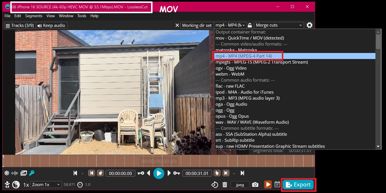

But why convert MOV to MP4 with Handbrake? Isn't it enough to losslessly remux MOV to MP4 with LosslessCut?
You beat me to it, see my EDIT in my previous Post.
I was going to ask later on if there was a way to change from MOV to MP4 in LosslessCut, even if i don't need to Cut bits from the file before exporting it, as i am not yet familiar with any other aspects of LosslessCut.

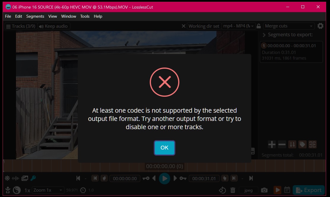

EDIT: so i imported the iPhone MOV file into LosslessCut, and selected to export to MP4 but it gave me the Error in image 2 below, or am i doing it wrong.
[Attachment 85073 - Click to enlarge]
[Attachment 85074 - Click to enlarge]Last edited by Bridgy; 24th Jan 2025 at 10:15.
MOV and MP4 are the same container. But Apple only allows certain codecs to be used in MP4. MOV allow many others. For example, ProRes is allowed in MOV but not MP4.
I had a feeling they were very similar at least, but was not sure how.
So LosslessCut will not change the MOV to MP4 so why would that be. -
Just tried MKV, i got the same Error as i did with the MP4 Export.

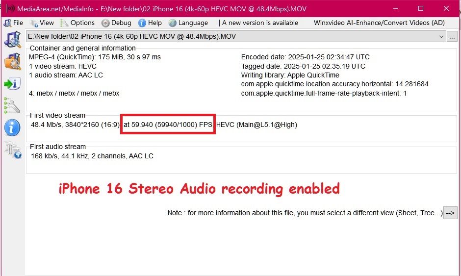

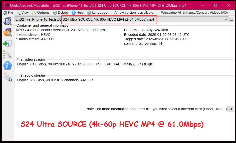

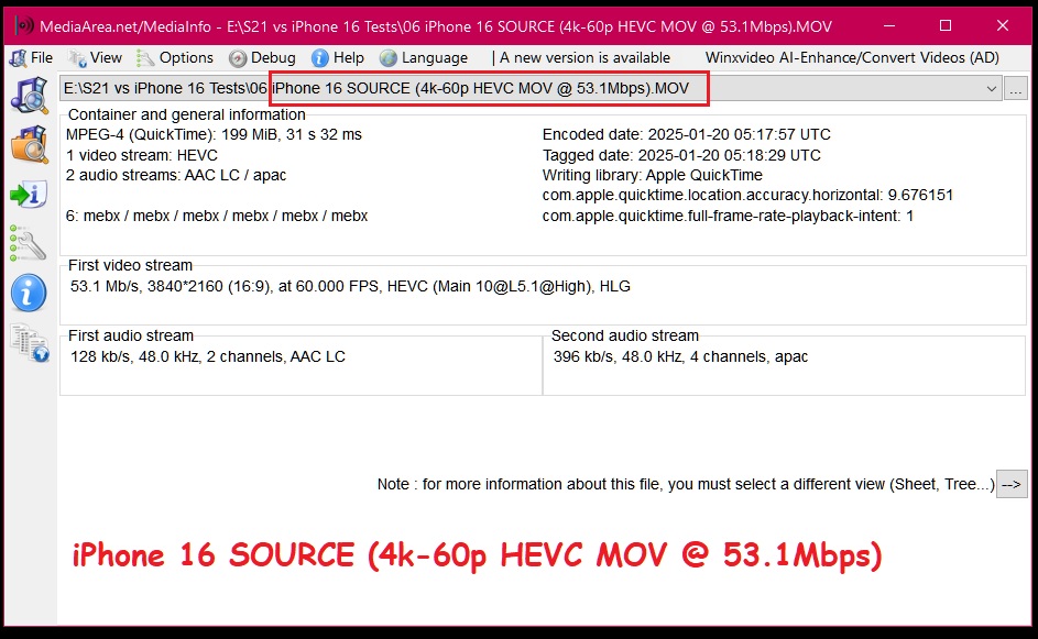

MediaInfo for the iPhone MOV and my S24 Ultra MP4 Files are below.
Seems like the iPhone has 2 Audio streams ? i wonder if there is a way to stop this in the phone video settings.
When i recoded the MOPV to MP4 in Handbrake the 2nd Audio stream was removed.

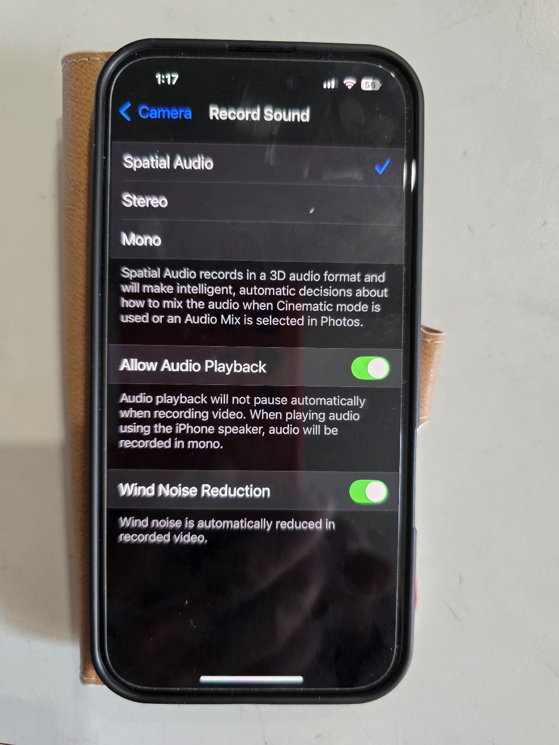

I just found a reference to the Spacial Audio that might be causing this, i will go into the iPhone video settings and disable it.
https://discussions.apple.com/thread/255785732?sortBy=rank
Ok so the iPhone has Spacial Sound set by Default, so i changed it to Stereo and recorded another 30 second test video, and the 2nd Audio stream has now gone, and while i was in the camera settings, i noted that they also set HDR mode on by default too, which is stupid, HDR with every phone camera that i have used makes the video look like crap, and that is why the iPhone video that i recorded the other day looked washed out, now it looks normal.
Also, MediaInfo shows the video at 59.940fps not 60fps like it originally showed before changing these settings.

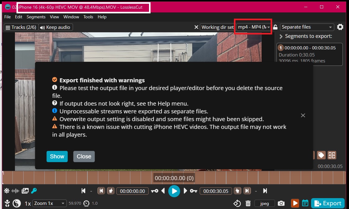

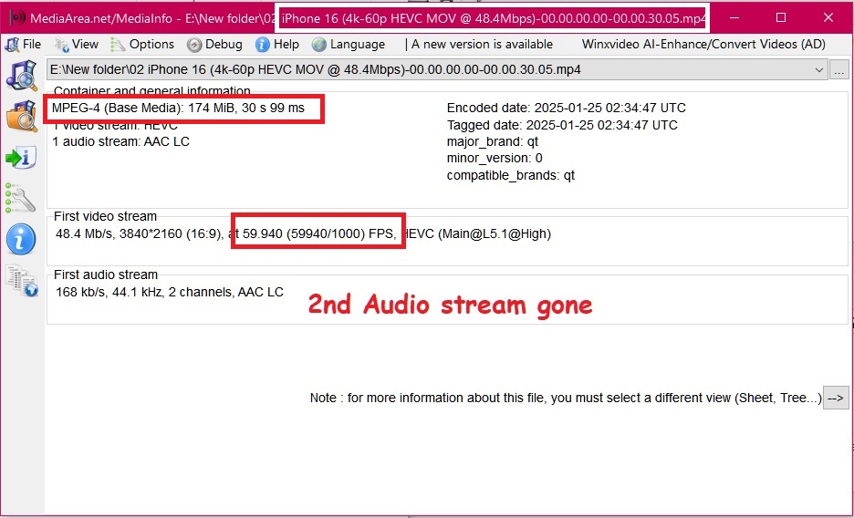

Also, i just imported the MOV file into LosslessCut and changed it to MP4 and it worked, took a few seconds to complete.
[Attachment 85100 - Click to enlarge]
[Attachment 85104 - Click to enlarge]Last edited by Bridgy; 24th Jan 2025 at 22:20.
The apac audio stream can be disabled (removed) in LosslessCut, so that the hevc and aac streams can be muxed to MP4 successfully.
Yes HEVC and AAC is, but i never heard of APAC, so that was definitely the culprit.
