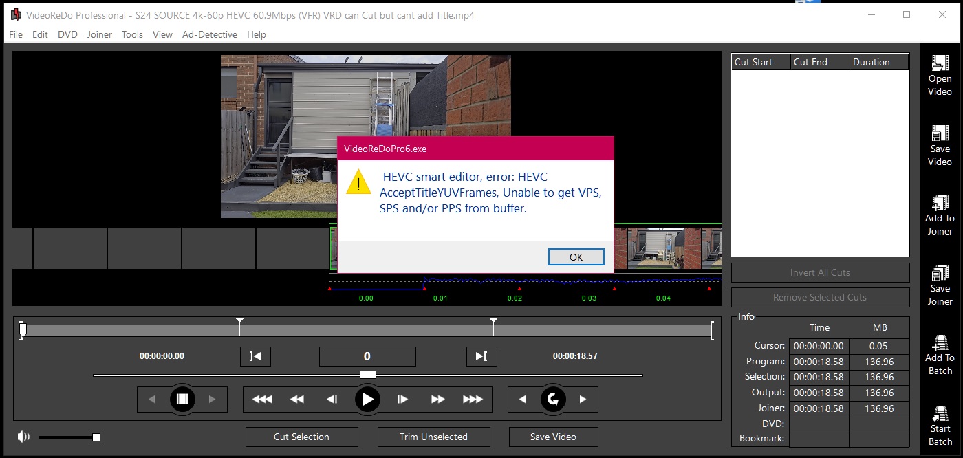

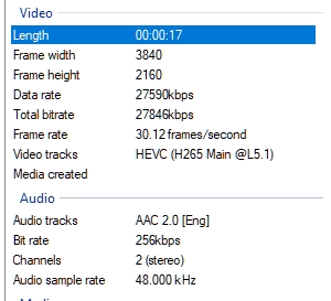

    OK i just recorded a 4k/30p HEVC file with the S24
    1: Imported to VRD, Cut to 3 segments and Merge, Smart Render and Export perfectly, and playback on my laptop in MPC is perfect.
    BUT there is still Lag in the preview screen and during seeking in the timeline, same as the 60p files, this could just be an issue with my laptop specs, or a bug, if this does not Lag in someone elses computer then it is my laptop at fault, not VRD.
    2: Imported the Cut File to the Joiner list, add my Title, Export crashed, just as it does with the 60p Files.
    3: Imported the Source File to the VRD Joiner, this time it was the actual uncut File as it came from the Camera, i added the Title, and it Exported perfectly, so go figure, but it wont export the file if i cut and merge it with VRD first.
    4: Imported the Source file into LosslessCut, i Cut 3 segments and it exported perfectly, plays perfectly.
    5: I imported the Cut file from LoslessCut into the VRD Joiner list, i add the Title, and it exported perfectly.
    Same results that i got from the 4k/60p source files.

    Ok so with 4k/60p you get Lag when playing in the preview screen and seeking to cut points, and it crashes when you export, but your 4k/30p files were fine when previewing and seeking in the timeline, and they exported as well.
    My VRD can cut both 60p and 30p HEVC and export them without any issues, and both play perfect in MPC on my laptop, i just suffer with the Lag on both.
    Everything else for me does work in VRD with HEVC file, but why will VRD add a title to a camera file with no cuts, but not add a title when i make some cuts first, this is obviously another bug, but i can work around this by importing the camera file first, add the title and export, bring that into VRD again and then cut the unwanted bits out, then smart render it, at least this works for me.
    OR i just cut the file with LosslessCut first, then import to VRD to add the Title because this method has always worked.

    Yes, because i know for a fact as a former Beta Tester that Pro had a lot more additional features included, which is why i bought the Pro version, i could never have been able to use the Non Pro version, or at least been able to do stuff that i really needed to do with my files.
    I think we just need to put VRD to bed and let it do what it does for those who are using it, and i will plug away and use it whenever i need to, but the biggest winner in all of this for me was finding LosslessCut, and at the beginning i criticized it for looking a bit tacky and childish as far as the User Interface goes, but i heard a lot of people also criticize the look of VRD as well, and that's fine because VRD to me is far and away the best looking GUI, it is laid out perfectly, and so easy to use, even a child can use it.
    Handbrake has also been a big winner for me as well for exporting to other formats, and i thank codemaster for teaching me the ropes properly.
    EDIT: one other thing that i may not have mentioned before with VRD, so after importing a file and adding a Title, the exported file will not show the bitrate of the actual source file, it will give a lower bitrate depending on the duration of the actual file.
    With my 30 second 4k/60p HEVC test file it was recorded at 61.0Mbps, but after i export that with a 7 second Title, the bitrate shows up as 49.5Mbps.
    I asked Dan Rosen about this very same thing several years ago and he attempted to explain it to me, but he did assure me that the video part is still the same bitrate as the source file because it is not recoded when Smart Match is used for the export.
    EDIT 2: OK well just as i suspected, Dan Rosen was indeed correct with what he told me regarding the Exported file with a Title still being the same as the source file, but shows it as being lower.
    I just opened VRD and i imported that 4k/60p HEVC test file with a Title that shows up as 49.5Mbps, i cut the title off, and smart rendered back, and the export file came in at 59.8Mbps.

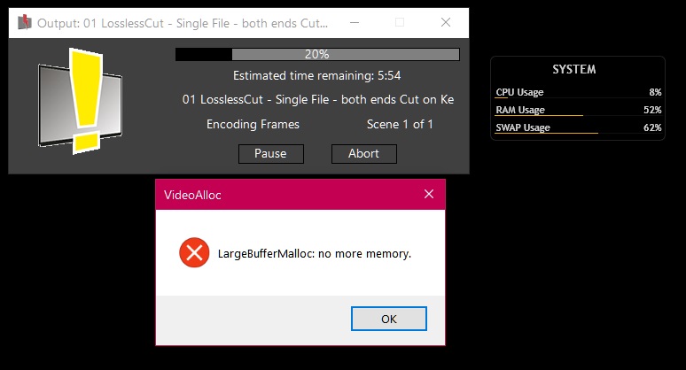

    Hey guys, this morning i decided to Test the Cutting and Smart Rendering of my S24 Ultra 4k/60p HEVC and AVC files, just to see if these might behave differently that my S21 and S23 files did some time ago, because VRD is now smart rendering my exports from LosslessCut as CFR but the Source files are all VFR, so i know that there is some small difference in these S24 files, i just can't pin point it.
    My S24 4k/60p AVC (72.0Mbps) files will play properly without glitches when Cut on any frame.
    My S24 4k/60p HEVC (61.0Mbps) files still only play properly without glitches when the start cut of each retained segment is cut on a Keyframe, the end cuts can be made anywhere.
    EDIT: well stone the crows, i was able to add Titles to these 4k/60p HEVC LosslessCut exports the other day, now i tried to do one and VRD gave me the Large Buffer Malloc:no more memory error, which is odd.
    I think i was getting some of these several years ago and Dan Rosen explained it to me, but the so called bug that he found in VRD that was causing my laptop to do this was fixed.
    I have tried it several times just now and it seems to happen as soon as the Ram Usage gets to about 50% and the SWAP Usage hits 61% and it crashes.
    [Attachment 84995 - Click to enlarge]
    I rebooted the laptop and the Swap Usage went back down to 15% and i was then able to add a Title and it worked.
    I only have 16gb of ram in my laptop, Is there some way to stop my SWAP Usage from getting too high like this.
    EDIT: Ok well it looks like my VRD is failing to add Titles to any of my 4k AVC and HEVC Files, been trying for 24 hours and it will not even add titles to the Files that were Cut with LosslessCut, which it was working with before, so clearly something has gone wrong that is continually giving the Large Buffer Malloc:no more memory error.
  30. The swap file error you got can be due to one of two things .. issues with the OS (either drivers or incorrect settings) or the software in question has a bug that is causing memory leaks. Memory leaks are where the software and/or os is not releasing memory once it is finished with it - the affected memory is not physically in use but is tagged as "in use" by the os and so unavailable for anything else.
    One check you can do is to reboot the laptop and leave it running *without VRD running*, periodically checking the physically memory usage and the swap file usage. If the usage of both increases with time without VRD running, then it is an os issue, if it is stable over time then it's VRD. Unless you've already checked this?
    Next, check how much space windoze is allocating to the swap file (aka paging file). For a 16G system, MS recommends a swap file that's between 4G and 1.5 times the physical RAM, that is 24G. 4G is the absolute minimum and 24G is if you have hibernation set up. For less than 16G of ram they recommend a swap file equal in size to the amount of physical RAM, so you have recommendations between 4-24G. I have Win10 on my desktop with 64G RAM and the paging size set to be managed by the system. Greyed out it says 'recommended' paging size 9G if I wanted to manually configure it but the system managed paging size is 64G .. the same as the physical RAM. Of course it's all academic on my pc - with 64G of RAM the paging file just sits there and does diddly squat. So I'd say best practice would be to have it between 16-24G on your laptop. You can set the paging file to operate off another drive, but the system drive is always the quickest.
    Check to see if the paging file on the laptop "managed by the system" or manually. If the later, maybe switch to the former? If it's the former and the current paging size is less than 16G, set it to manual and set the paging size at 16G. Or even 24G.
    If the virtual memory settings are all ok, the next thing to check is to make sure all the drivers are up to date, especially those for the mobo & CPU. Check for optional updates in win update but also check the manufacturer websites - not all manufacturer drivers are available via WinUpdate. Driver issues can cause memory leaks, especially mobo ones since it is those that manage the RAM. The thing with out of date drivers is that os or software updates may not be 100% compatible with the older drivers, so a pc may work fine one day, you update windows and then it has driver issues.
    Of course, this is all presuming that the issue isn't a bug in VRD Pro. If that is the case, your only hope is to post a help request on the reddit forum in case someone else has encountered the same issue and found a fix, tho' Dan hasn't posted anything there in months. Otherwise do a web search with VRD/videoredo" and the error message you got. You might be lucky. After 7 months of fruitless searching I finally found a very obscure forum entry that helped me fix an issue on my now 8mo pc - someone had the same issue I did and posted a help request. They got no answers and a week or so later they made a follow-up post saying they'd fixed the issue and gave instructions.
    The lack of a response indicates no-one else here has had that particular issue, hence the need to look elsewhere.
