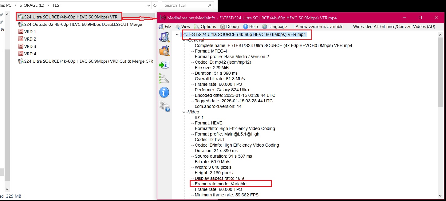

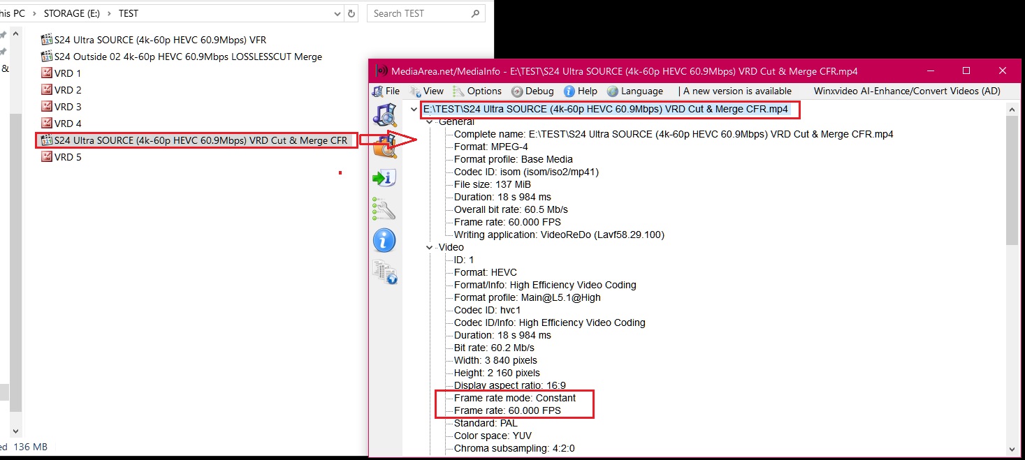

    Is the CRF Factor for exporting VFR files to CFR (as in my case) different than for exporting to VFR to VFR ?
    Also, wouldn't the CRF factor be different depending on the Source file bitrate, so if my S24 recorded 4k/60p at 40Mbps and not 60, would i still use CRF17 to export to 1080 or 720.
    My S24 can record Normal Bitrate mode, and High Bitrate mode for 1080 and 4k HEVC recordings.
    4k/60p HEVC Normal Bitrate is 60Mbps, High is 144Mbps.
    1080/60p HEVC Normal is 22.0Mbps, High is 60.0Mbps
    So in my previous post, where it shows the 1080/60p HEVC (CFR) Export, the CRF17 is 17.0Mbps, so even this is lower than what the camera records 1080/60p HEVC at, using a CRF of 16 would get the 1080p export more like 22.0Mbps.
    To me it still seems like a lot of guesswork with CRF Factors, not knowing what bitrate each CRF Factor number will export for any given source file.

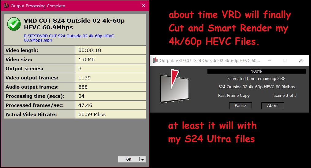

    A question re VRD. I must have missed the evidence for it, but you say VRD uses MainConcept encoding and not x264/265 .. yet when I check the VRD log it mentions x264 encoding. Admittedly I do have hardware encoding turned on.
    All i can say right now is that VRD definitely used Mainconcept encoder for many years, and the late Dan Rosen told me this himself during some of our chats in Skype, and he told me that if he used the x264/x265 encoders, he would need to charge a lot more for VRD because with VRD being a commercial program (paid for) he would have to pay a big license fee for those encoders.
    At the time i really had no idea that Mainconcept was nowhere near as good as x264/x265, but he did advise me to use Intel QuickSync (QSV) if Maincencept was too slow, which i had to do many times, as the Mainconcept encoding could take from 5 to 8 times times longer to export, depending on the resolution and format i chose.
    The same still applies now, my 6 core laptop will encode with Handbrake or VRD at around 6 times the duration for a 4k to 1080p export, and around 4 times slower for a 720p export.
    I did read in this Thread where someone did confirm that VRD still uses MainConcept, need to go back and find it.
    Maybe if you could do an export with VRD and give us a look at the Log File.

    Re VRD and what encoder it uses, I'll attach the log for the edit of a sample video. In case the attach doesn't work I'll paste it into another reply following.
    The emoji's in the following post are the fault of the forum. They are (naturally) not in the actual log.
  10. 2025-01-16 18:20:26 Image support lib: 8.0.1 (r40318), ippIP AVX2 (h9)

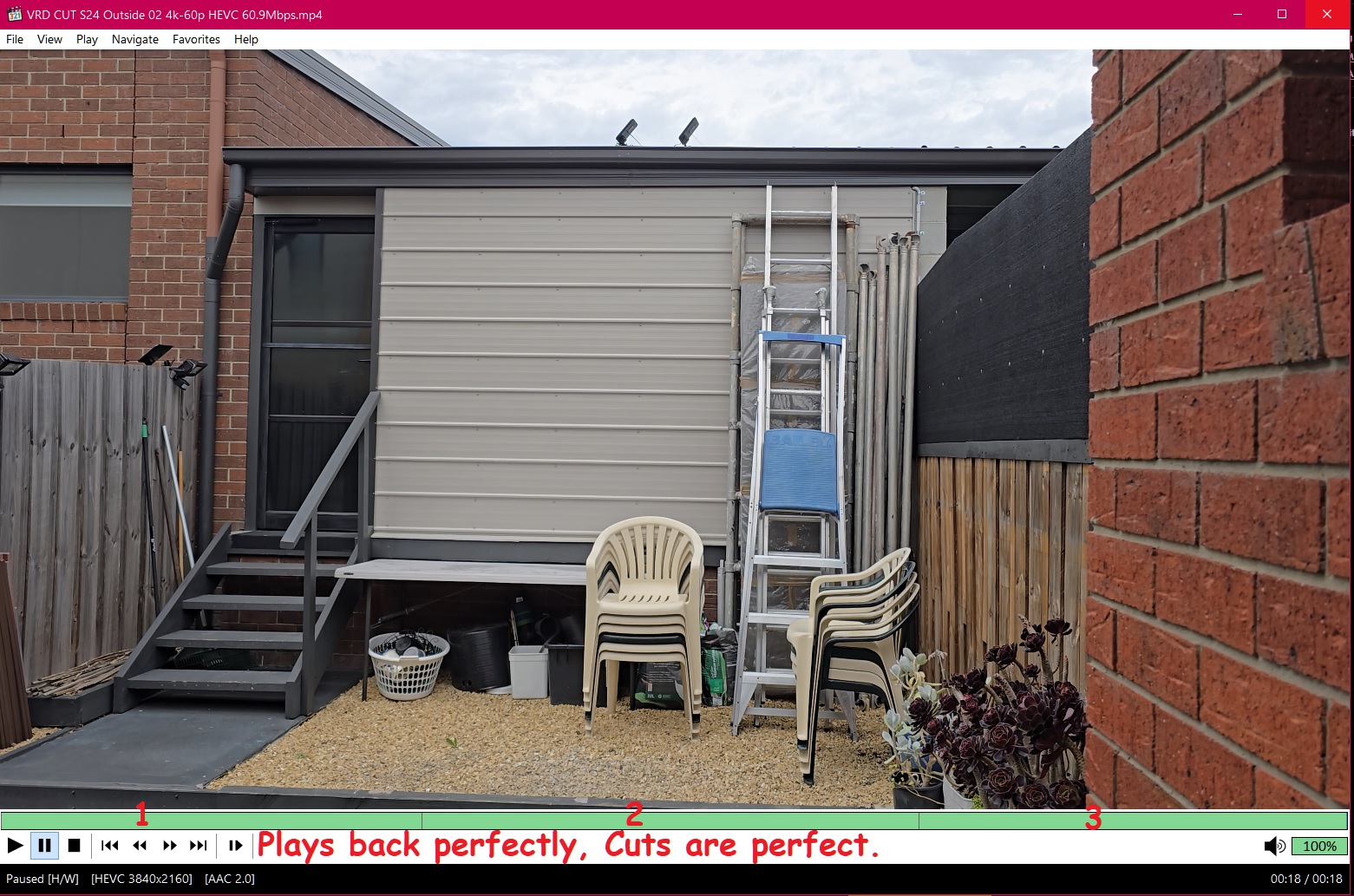

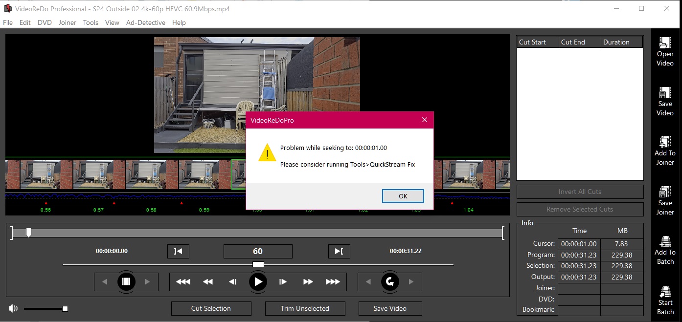

    So i decided to give VRD a shot at Cutting and Smart Rendering one of my S24 Ultra test files (failed with the S21 and S23 files) just to see what happened, as i had not tested this before now, and after a bit of effort and time to find my 4 Cut points (leaving 3 segments to merge) i did manage to get 3 cuts done after getting a Seeking Error and suggesting i try Quickstream Fix (which i ignored) and the Export worked flawlessly, it would just crash when trying it with the S21 and S23 files, or any other 4k/60p HEVC files from other cameras.
    Is there a Ghost coder lurking somewhere inside the VRD Software.
    [Attachment 84904 - Click to enlarge]
    [Attachment 84905 - Click to enlarge]
    [Attachment 84906 - Click to enlarge]
    [Attachment 84907 - Click to enlarge]

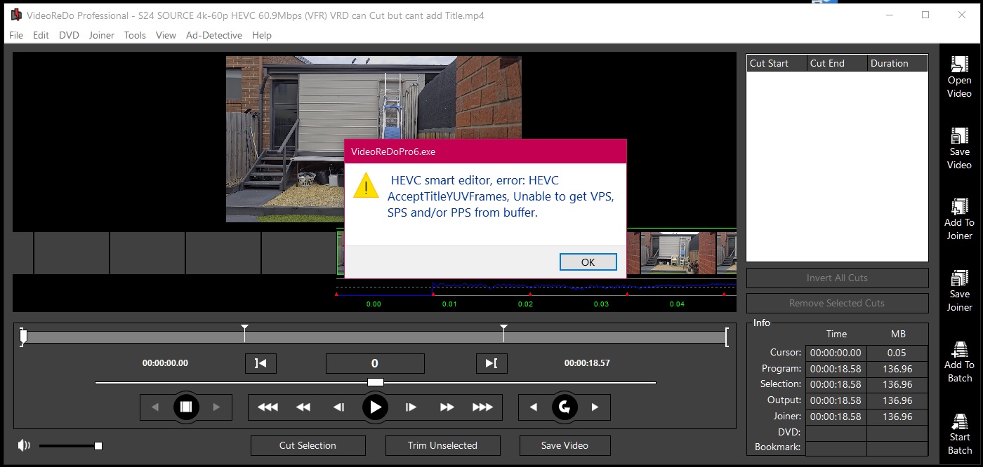

    Now the BAD News
    If i import this Cut file back into VRD Joiner to add a title, it fails with the following Error.
    [Attachment 84910 - Click to enlarge]

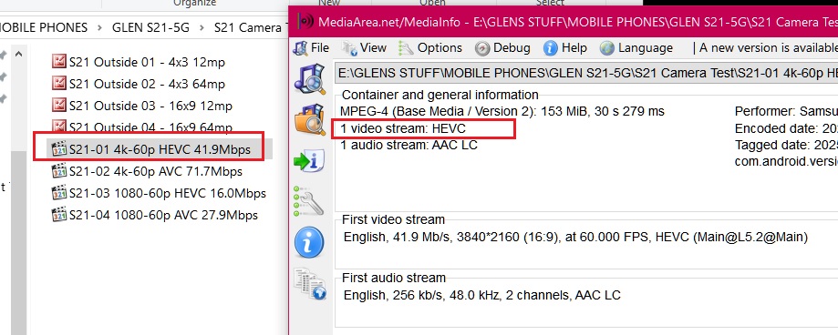

    All of this is Really strange because i can load an S24 Cut file from LosslessCut into VRD and add the same Title and it Smart Renders perfectly.
    So i am back to square one, still need to Cut/Merge/Smart Render with LosslessCut, and do Titles in VRD, at least i know what i am dealing with now.

    As mentioned above, i finally did a Cut and Merge test using VRD and one of my S24 Ultra test files, and for some strange reason it worked (barring the Seek error) but when i checked the Attributes in MediaInfo, the Exported File shows up as CFR, the Source file is VFR, and i noticed this was the case yesterday after i exported a LosslessCut Merged file from VRD with a title, this time LosslessCut was not used, so VRD seems to show these S24 Ultra files as CFR after they have been processed.
    Source File as VFR
    [Attachment 84908 - Click to enlarge]
    Exported File as CFR
    [Attachment 84909 - Click to enlarge]
