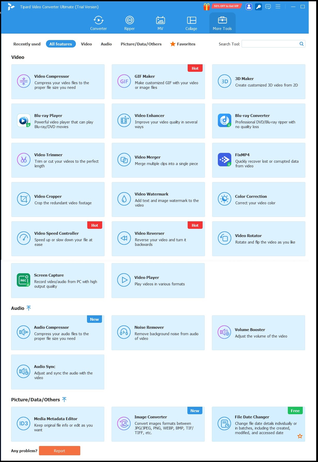

    Originally Posted by Seeker47 View Post

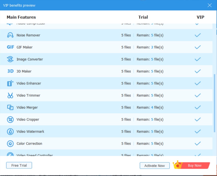

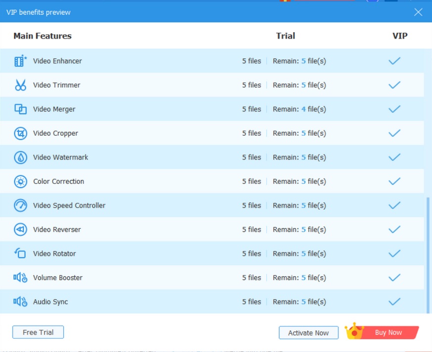

    But you both seem to be indicating that that whole gallery of functions shown under "More Tools" is indeed included within this single Tipard program ?
    I can confirm that all of the conversion Tools listed in the "More Tools" setting are indeed included in the Tipard Ultimate software, i just tested the Video Reverser and it seems like we only get 5 attempts to test each feature in the Trial Version.
    [Attachment 84402 - Click to enlarge]

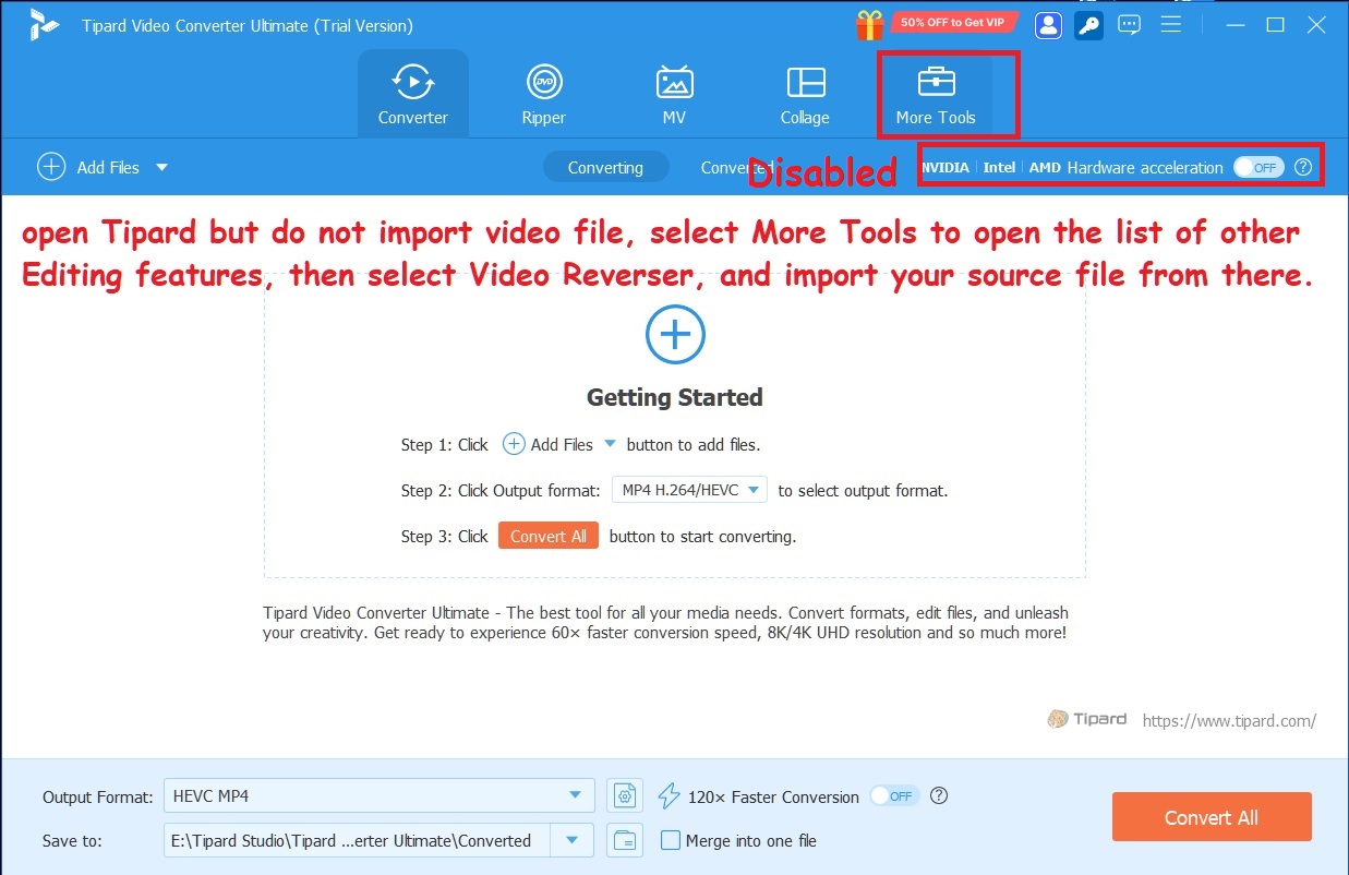

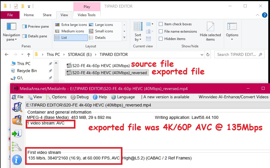

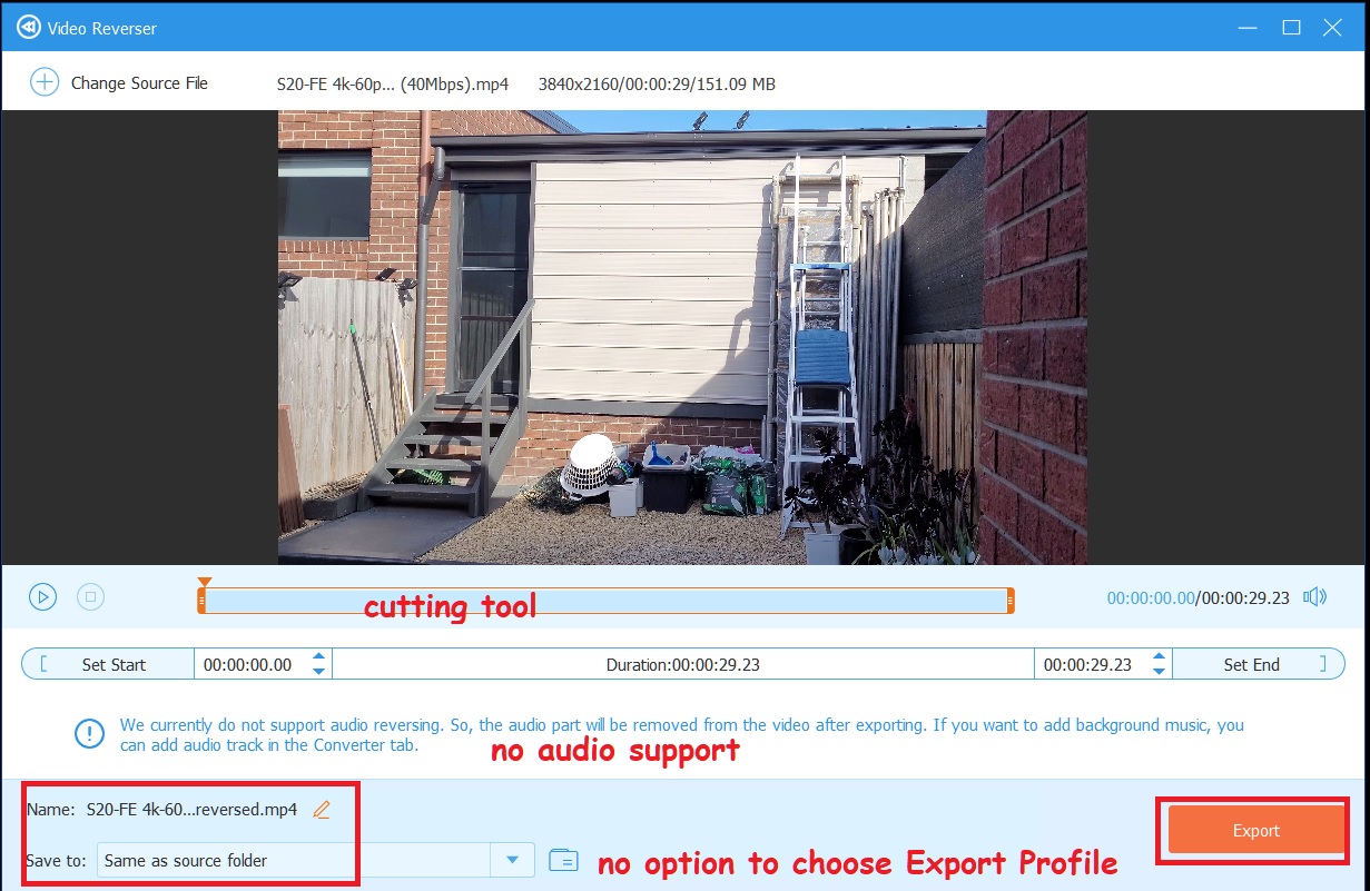

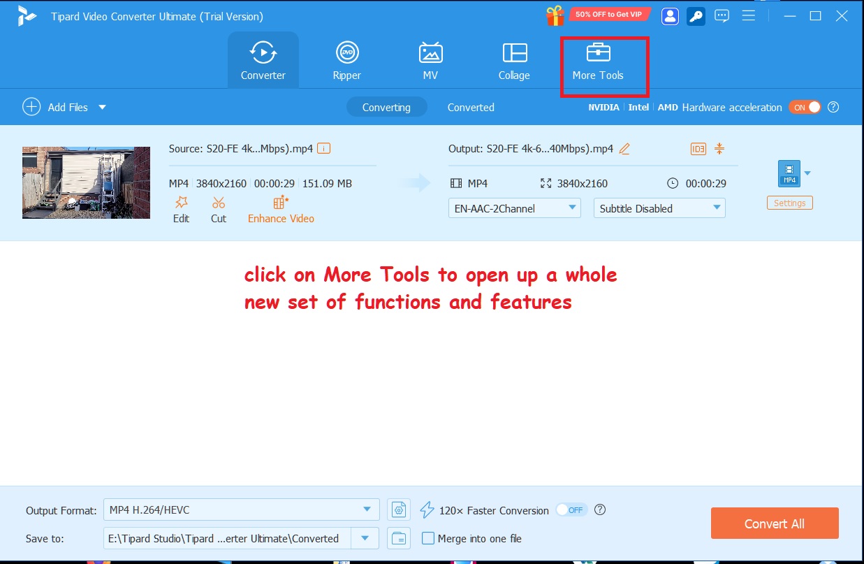

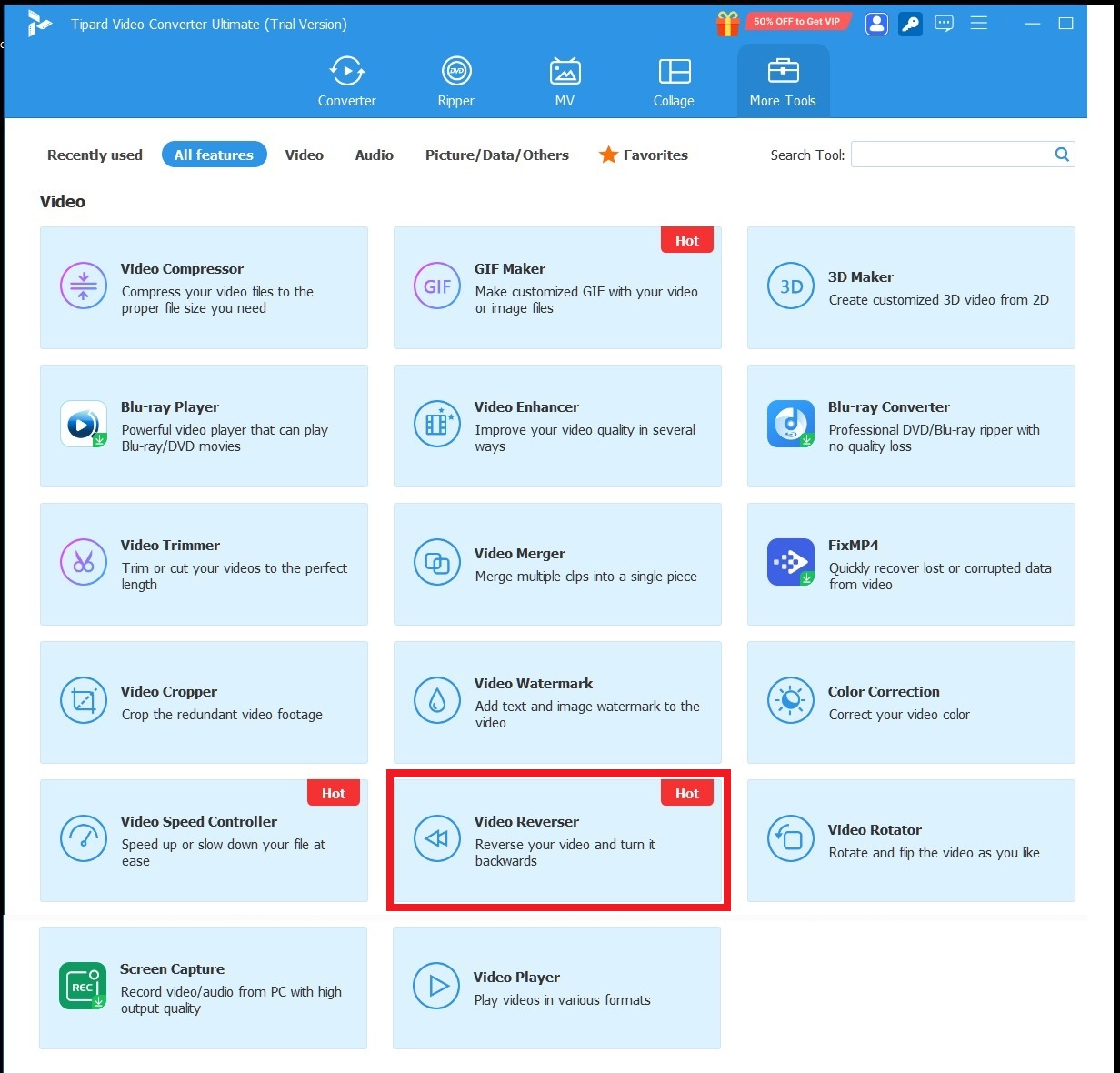

    OK here are my Video Reversal results, source file is a 30 second 4k/60p HEVC @ 40Mbps recorded on my camera.
    Most of these additional editing features offered by Tipard will result in your files being fully recoded, maybe except for the Cutting Tool, which may export to the Lossless Conversion or "Same as Source" format if you buy the software and Enable the 120x Faster Conversion option.
    Open Tipard Ultimate, select the More Tools option (i disable Hardware Acceleration in my editing software)
    [Attachment 84423 - Click to enlarge]
    Select the Video Reverser option.
    [Attachment 84418 - Click to enlarge]

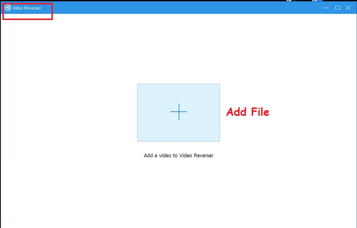

    Import your Source File.
    [Attachment 84419 - Click to enlarge]
    You can Cut/Trim your file, select your File name and destination, BUT there is no Audio support, and there is NO option to select an Export Profile, so i have no idea how Tipard are doing this, so i just continued with the Export process to see what happens.
    [Attachment 84420 - Click to enlarge]

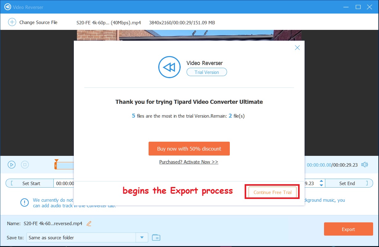

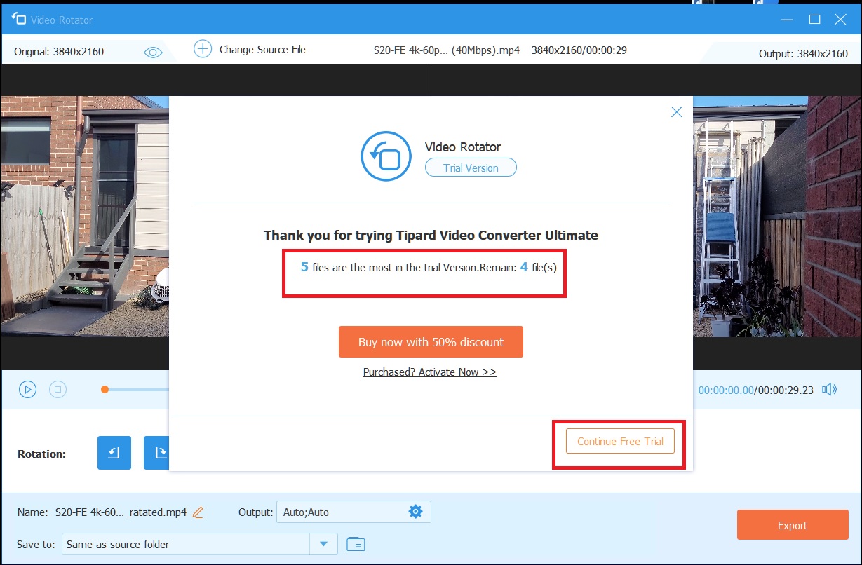

    I currently have 2 more test before this one, after this i get 1 more chance to test this feature.
    [Attachment 84421 - Click to enlarge]

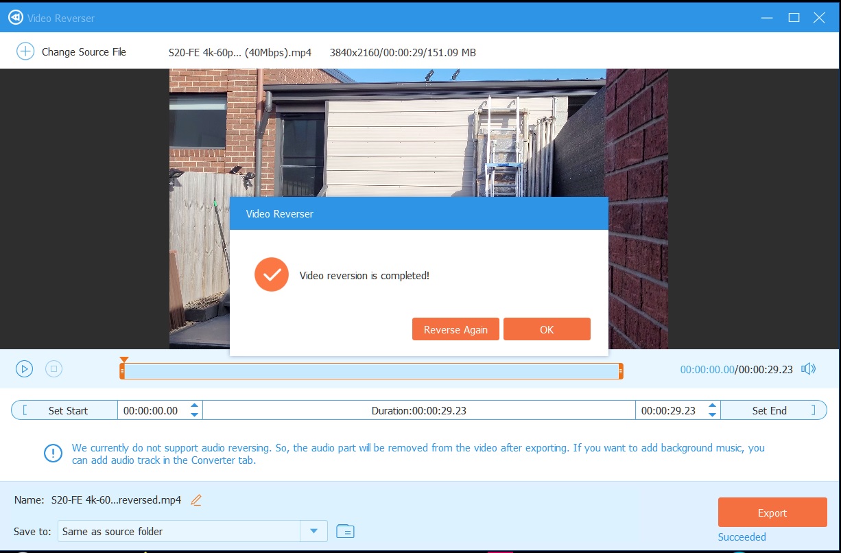

    All completed, BUT this is not good news, my 4k/60p HEVC file (40Mbps) was exported to 4k/60p AVC @ a massive 135Mbps, and it took 4 minutes to recode the file, however i always disable all Hardware Acceleration when i edit or process video files, so this may explain the slow recoding time, as well as the Laptop CPU might also have a lot to do with this too.
    [Attachment 84422 - Click to enlarge]
    [Attachment 84424 - Click to enlarge]
    So, in a nutshell, without having any option to select an Export Format profile, then i see this Reverse feature being totally hopeless, and pointless.

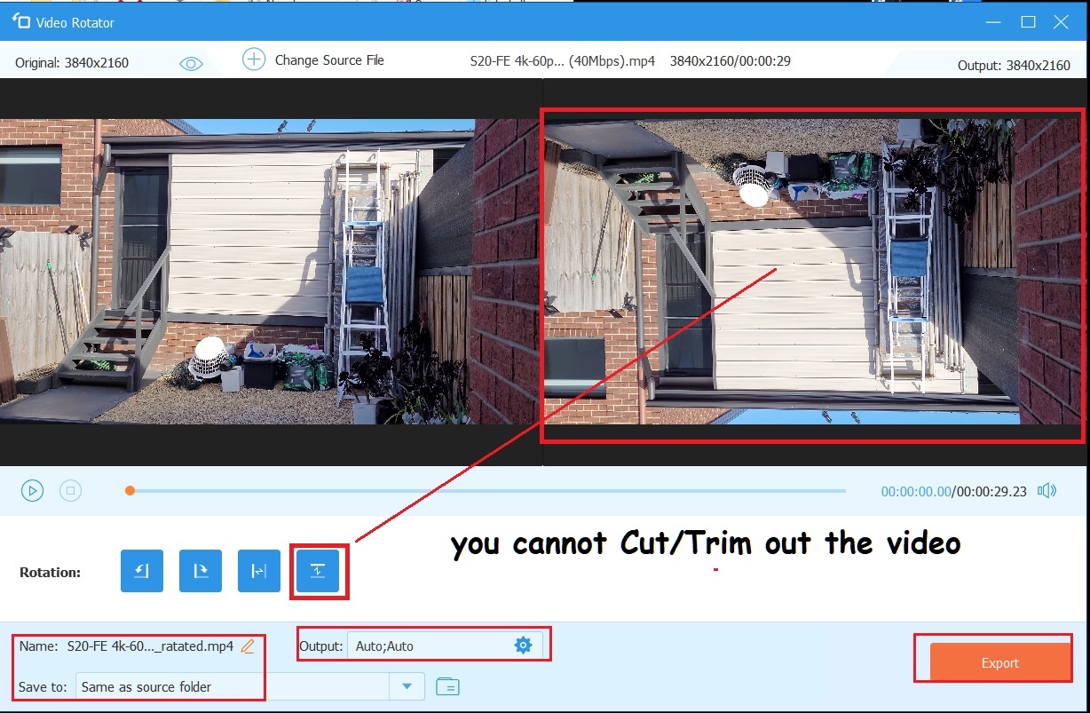

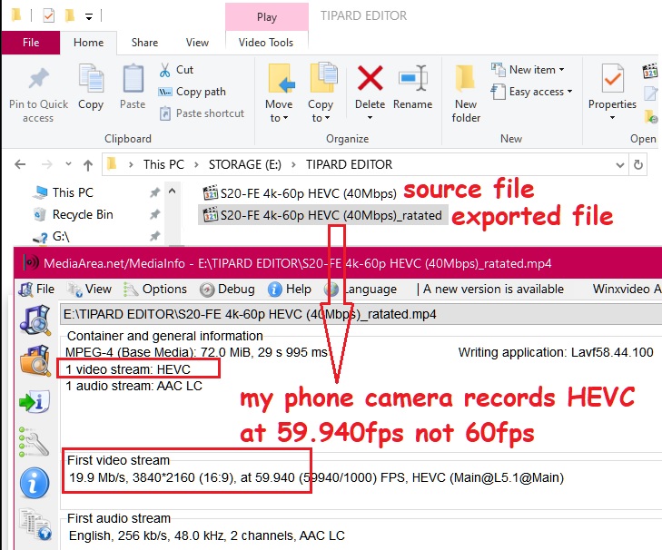

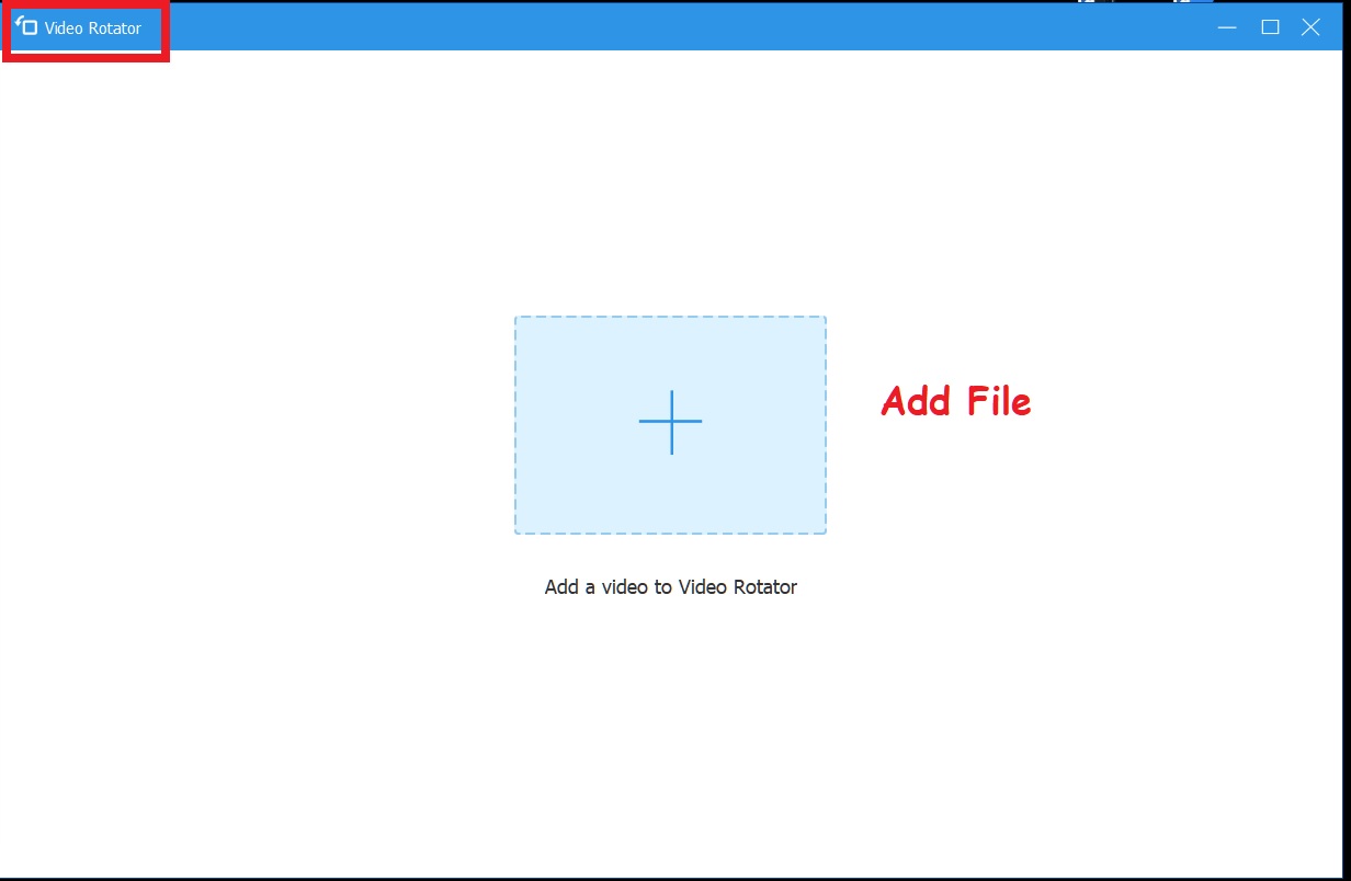

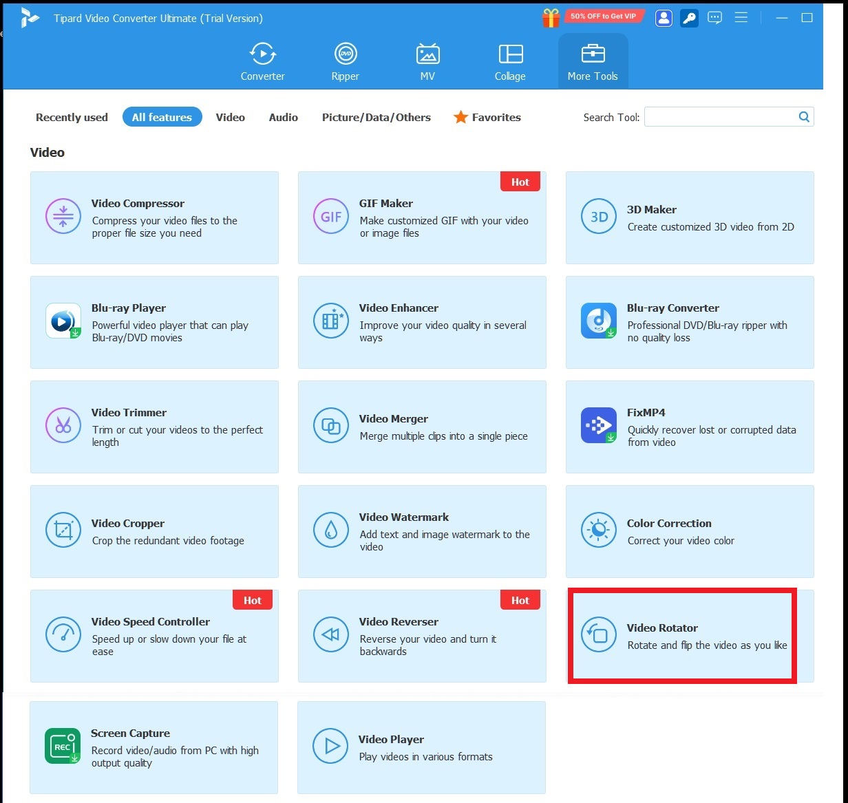

    Ok everyone, before i publish my results for the Rotation Tool, i want to remind you that the so called Lossless Conversion using the 120x Faster Conversion option that is only available in the paid for Version can only apply to video files that you import for Cutting/trimming/merging purposes (what i call Smart Render) and any other editing feature offered in this Software has to be re-encoded for obvious reasons, so you would need to select one of the built in export presets, or create your own custom profile.
    Back to my summary of the Tipard Video Rotation Tool.
    [Attachment 84443 - Click to enlarge]
    [Attachment 84444 - Click to enlarge]
    [Attachment 84445 - Click to enlarge]
    Make your appropriate Settings here, noting that the maximum video Bitrate is 20Mbps.
    Select your Rotation Mode, and you cannot cut/trim your video file here.
    [Attachment 84447 - Click to enlarge]
    Continue to Export.
    [Attachment 84448 - Click to enlarge]
    Exported Video results via MediaInfo.
    [Attachment 84449 - Click to enlarge]
    This Tool seems to work very well with a decent set of Export settings too.

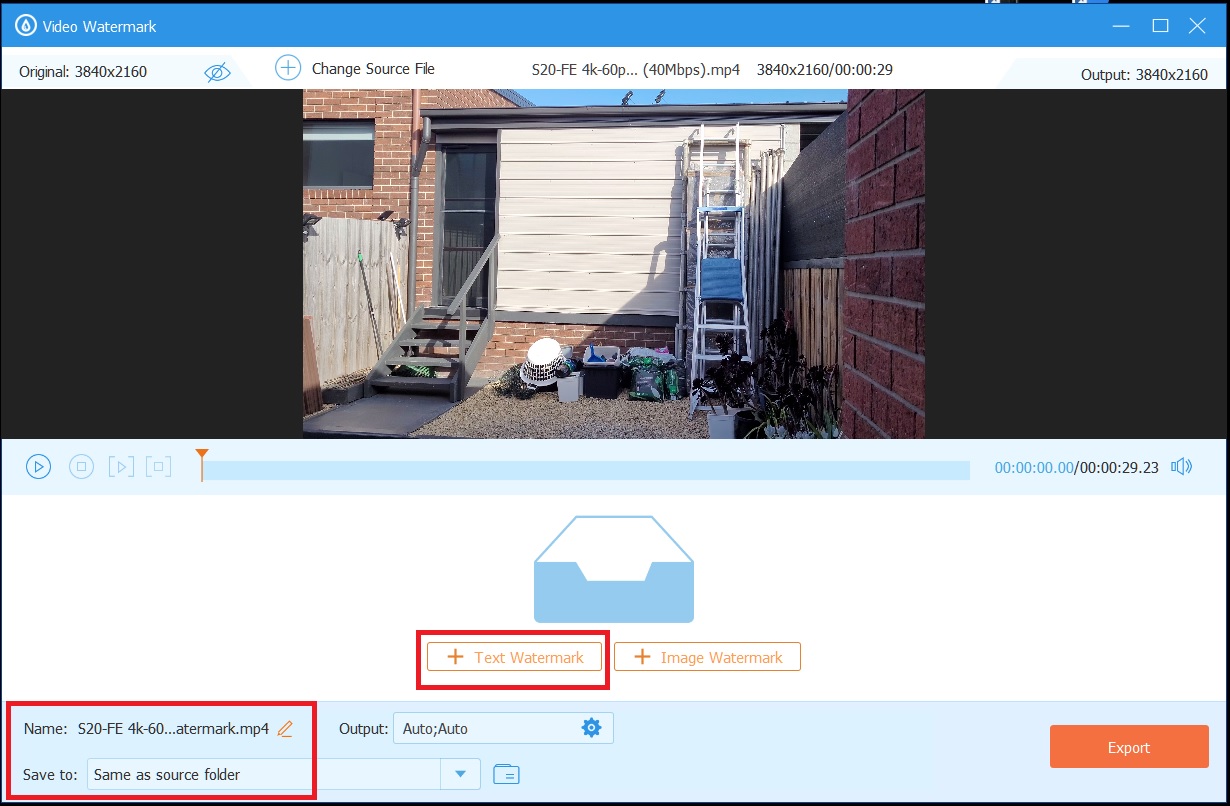

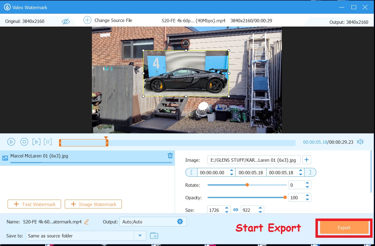

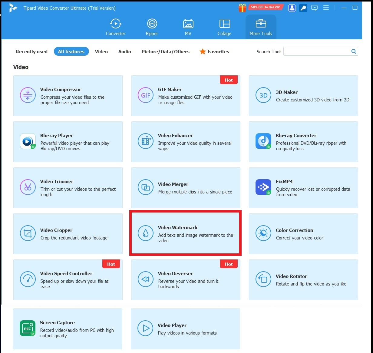

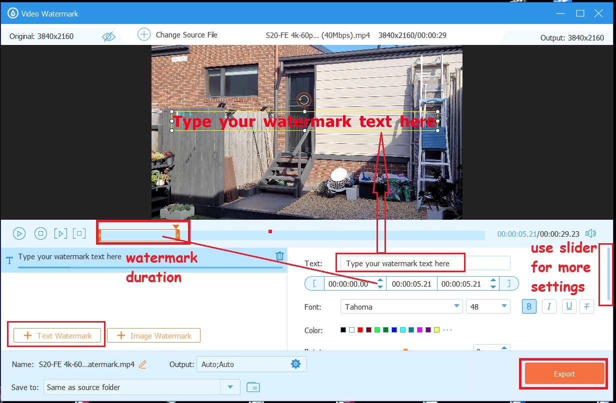

    My summary of the Tipard Video Watermark Tool
    [Attachment 84450 - Click to enlarge]
    [Attachment 84451 - Click to enlarge]
    [Attachment 84452 - Click to enlarge]
    Select Text or Image for the Watermark.
    [Attachment 84453 - Click to enlarge]
    Create Settings for Watermark.
    [Attachment 84454 - Click to enlarge]

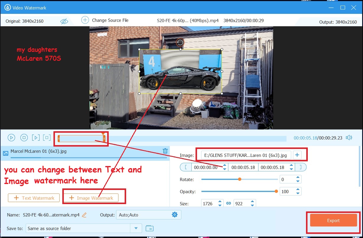

    You can change between Text and Image Watermark here.
    [Attachment 84455 - Click to enlarge]

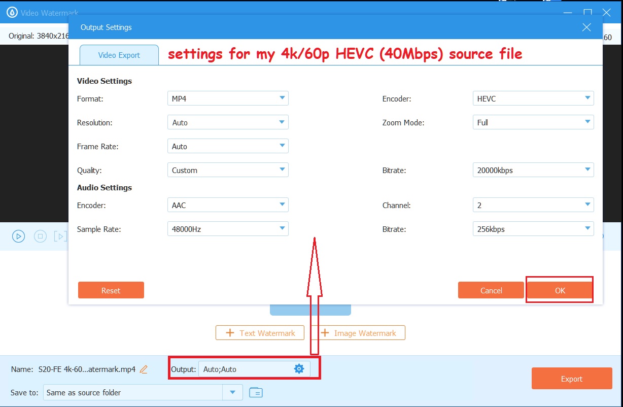

    Create your Export Settings here.
    [Attachment 84456 - Click to enlarge]
    Start the Export.
    [Attachment 84457 - Click to enlarge]

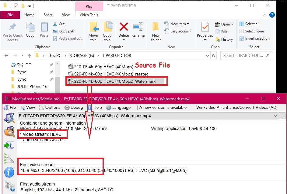

    Exported File results from MediaInfo.
    [Attachment 84458 - Click to enlarge]
    Very easy to use, with the same Export Settings available as per the Rotation Tool.

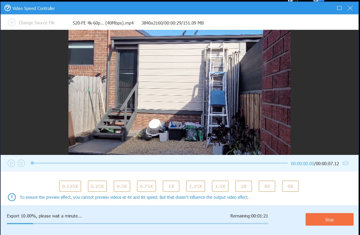

    I just tested the Tipard Speed Control Tool
    There was no point in posting up Screenshots, it is a basic tool and i got exactly the same results as per the previous tests, seems to work very easily and very fast output, just don't use it if you have Audio in your video file, the Audio is sped up as well.
    [Attachment 84459 - Click to enlarge]

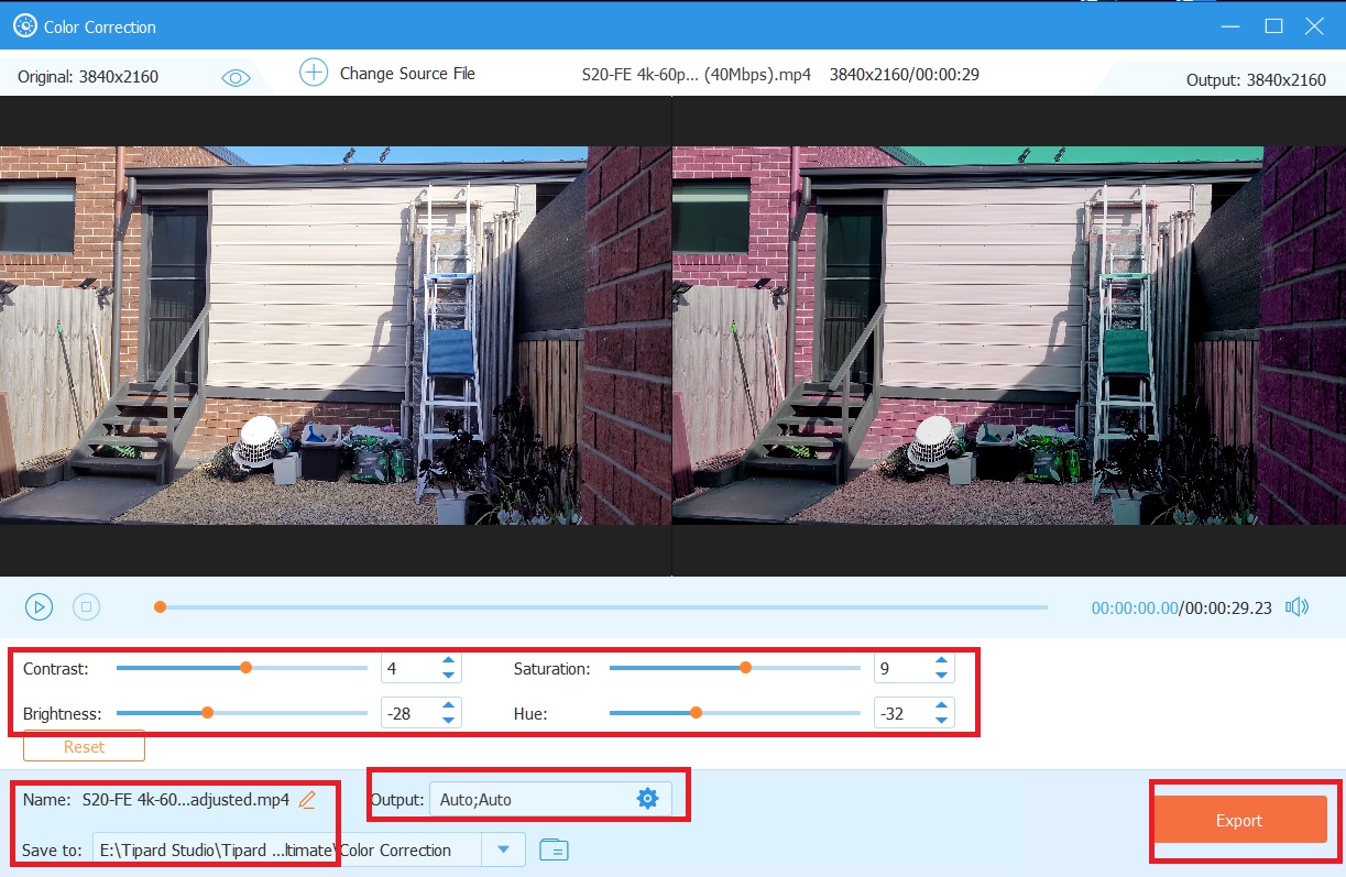

    I also just tested the Tipard Color CorrectionTool as well
    As per above results, very basic correction tool, easy to use, and may suit those who require it.
    [Attachment 84460 - Click to enlarge]

    Just a Heads up about the Export Settings that i used for these Extra Tools in Tipard that i am currently testing.
    My Exports were done using the Custom setting where i can choose my own Audio and Video settings as well as a custom video Bitrate, the Audio is fixed on AAC, no choice, and the maximum video Bitrate is limited to 20Mbps.
    The High Quality and Standard Export profiles you can change Audio and some other settings, but you cannot set a custom Bitrate, they are preset by the software, so i have posted the Export video Bitrate for them below.
    high Quality preset: the exported video Bitrate is 133Mbps.
    Standard Quality preset: the exported video Bitrate is 81Mbps.
    These export video Bitrates would only apply for my own 4k/60p HEVC files which are recorded at 40Mbps, BUT these Bitrates above are absolutely far too high for me, so i would be restricted to using the Custom profile where i can set my own Bitrate, which is only 20Mbps, and i really want my exported file to be at least 40Mbps to maintain the source file quality.
    I have also just completed a Rotation test on a 3 minute 720/60p AVC video using the High Quality preset, the source file was only 2Mbps, the exported file was 18Mbps, 9 times higher bitrate than the original, yet to the eyes, you cannot see any difference because there can't be, so why would they offer an export preset that is always going to be far too high and where you cannot change it yourself.
    So the video Bitrates in High and Standard Quality settings are too high, but the Custom setting only offers a maximum of 20Mbps.

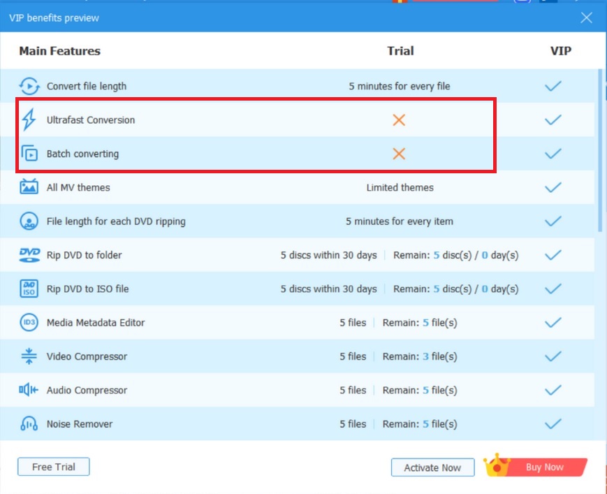

    Apart from not being able to test their Lossless Conversion (Same as Source) using the 120x Faster Conversion tool for Cutting files, this Tipard Ultimate seems to be a very decent Almost "All in One" editing suite for those who only need the basics.
    It imports almost all format files, it Cuts, Merges, Export to other Formats, it has a vast array of other editing features not available in other similar priced or even more expensive software.
    Would i pay US$59 for it as an Alternative to VRD (should VRD ever go down) well yes i would, as long as i can Cut my files and Export them back to the original format (as in Smart Render) without having to create my own Export profile and have to set my own video Bitrate.
    Unfortunately for me i cannot test the Lossless Conversion via the 120x Faster Conversion tool because Tipard lock it out in the Trial Mode, so i have to buy Tipard to try it, and i am in 2 minds about this right now.

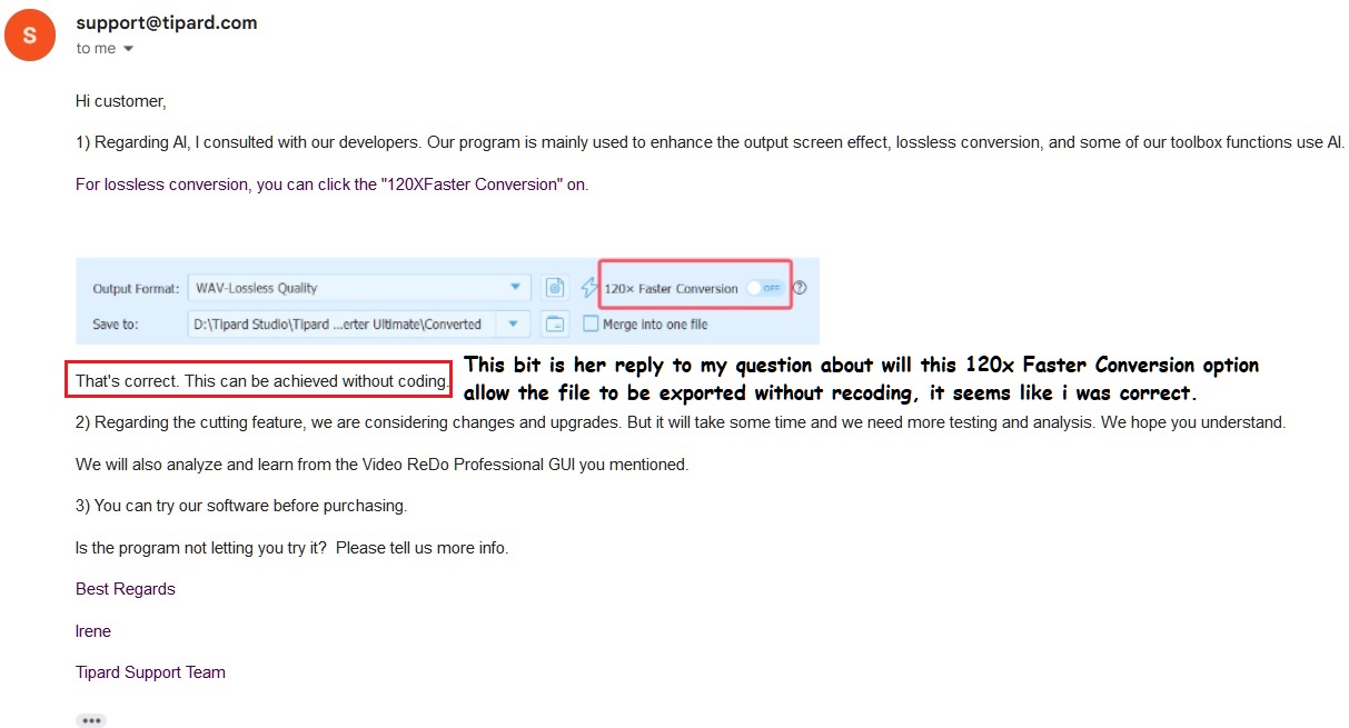

    The Tipard lady (Irene) told me that to get Lossless Conversion i need to Enable the 120x Faster Conversion switch that is found on the GUI main screen after a file is imported for cutting.
    The 120X Faster Conversion switch is not available in any of the other additional editing features, because doing other edits outside of just cutting bit out requires a full recode.

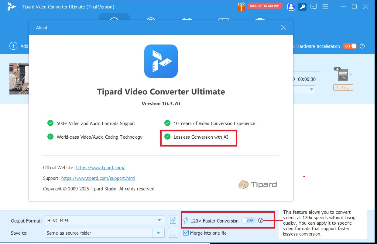

    What version of Tipard are you using, is it the Video Converter Ultimate like what i am testing ?
    [Attachment 84477 - Click to enlarge]
    The support lady told me that if i wanted the export files to be the Same as Source file, i need to enable that 120x Faster Conversion button (in the full version)
    They claim to do Lossless Conversion with AI, but i have no idea what that means.

    Just got another reply from Tipard Support, this was what she had to say.
    [Attachment 84481 - Click to enlarge]
    Got another email with screenshots of what is and is not available in the Trial Mode.
    [Attachment 84485 - Click to enlarge]
    [Attachment 84483 - Click to enlarge]
    [Attachment 84484 - Click to enlarge]

    Ok well in an email that i think i posted above, they claim to do Lossless Conversion (no recoding) by using that 120x Faster Conversion option, so i don't know what is going on here.
    Why don't you move to the latest version rather than stick to a 2 year old version, maybe their Lossless Conversion system has changed from hat you have (Ultrafast Conversion)
    If it did do Lossless, or as we call it Smart Render, then you should not have to click on the export profiles menu and select an export profile as you did, we don't need to do it in VRD, and nor with LosslessCut i don't think.
    It should, by default, just lock out any previously used Export presets made and Smart Render it to your selected destination folder, this is how i thought it might work.
    Anyway, it doesn't matter now, Tipard in their wisdom has locked out this feature in Trial mode so i can't test it anyway.
