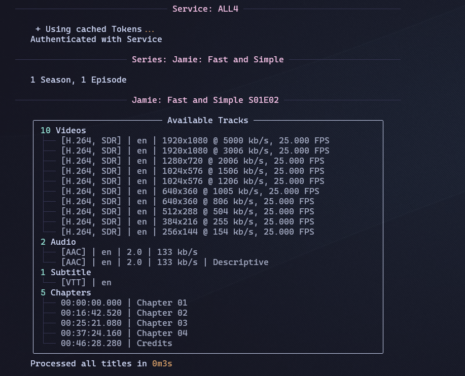

You get the chapter timestamps from their API, not the stream itself. If you want to do it all manually, you'd have to use the web developer in your browser, find the timestamps, and then use mkvmerge to add them when muxing.
No, the vast majority of streaming services don't encrypt their API. Channel5 is the only one I can think of that does.
For automation, you'd need a script. If you don't know how to make one, I recommend checking out Devine from the sticky threads at the top. It's a framework written in python that'll allow you to add and download from various streaming services. You can find some of them in my signature, including Channel4/All4.
It's not super beginner friendly, but will save you a lot of time and manual labor once properly set up:
[Attachment 83373 - Click to enlarge] -
