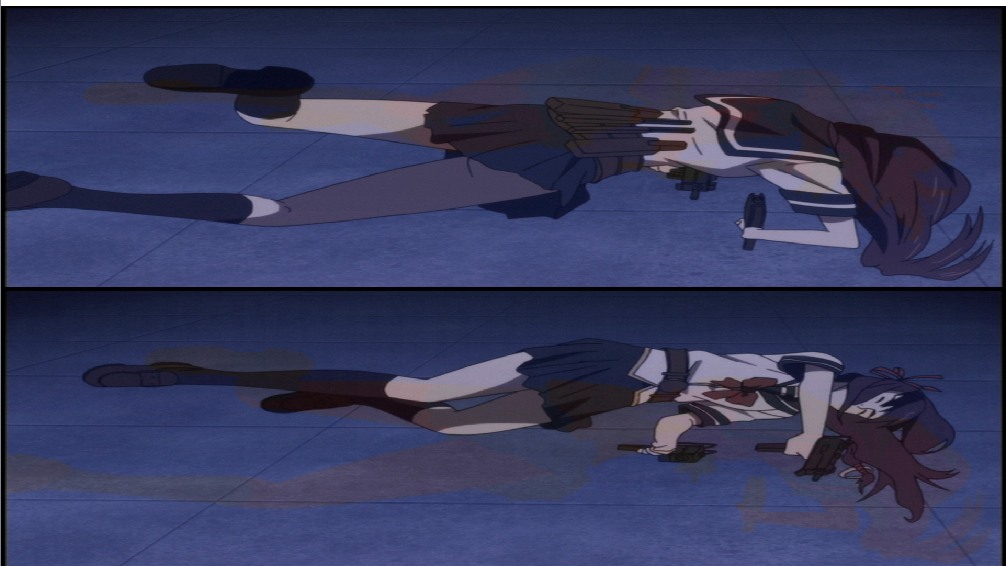

Hi, I have recently acquired an anime Blu-Ray which is interlaced. When using standard deinterlacing I get blended frames such as this.
[Attachment 83343 - Click to enlarge]

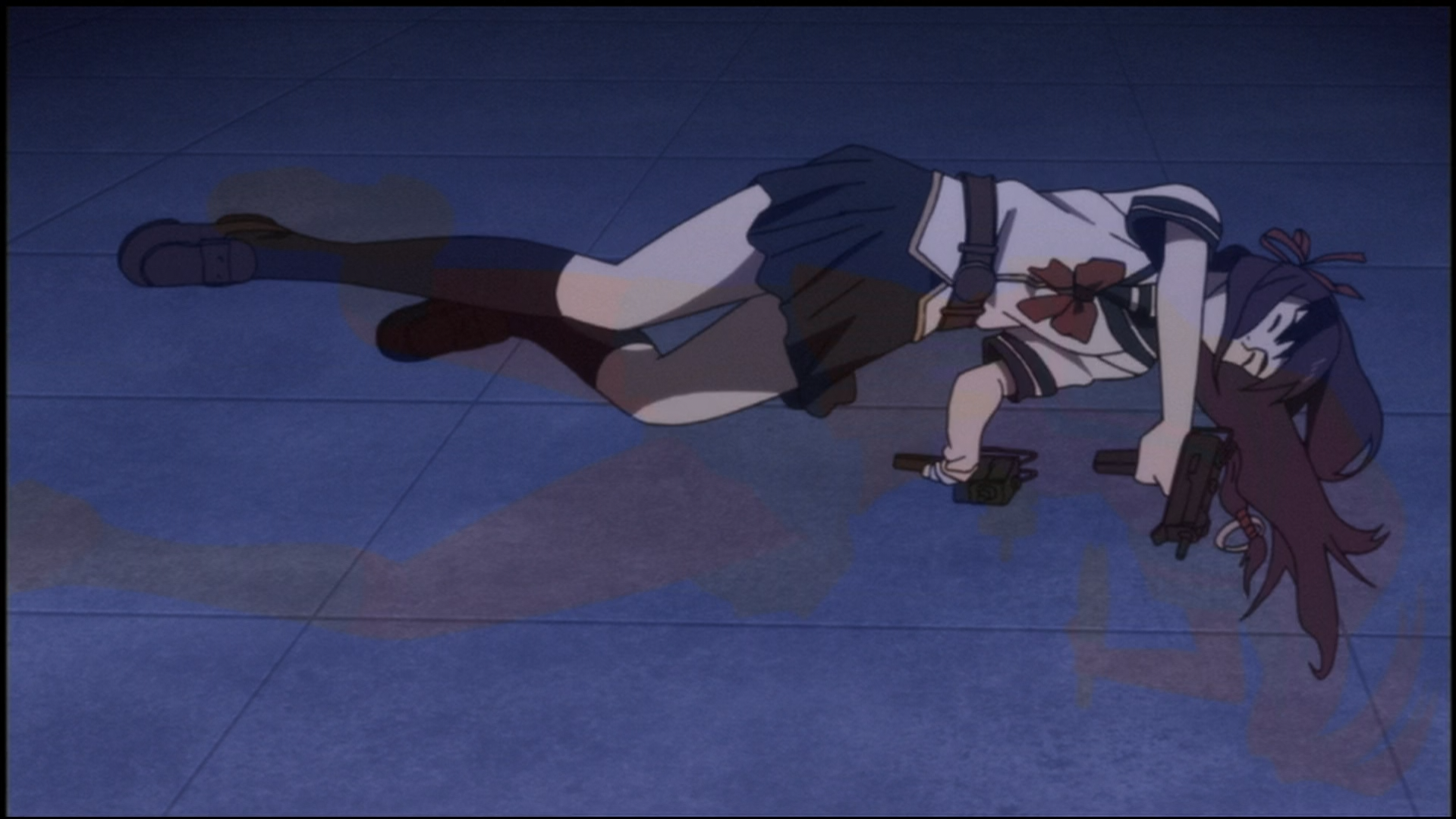

Digging deeper and looking at the individual interlace fields I can see that the chroma bleed/ghosting is present in each field.
[Attachment 83344 - Click to enlarge]
Is there a script/tool/plugin which can detect these "bad" frames and replace them with good ones?
I already tried multiple filters in Vapoursynth/Avisynth but didn't get any good results.
Thank you in advance for your help!

see this post from feisty2
http://forum.doom9.org/showthread.php?p=1692414#post1692414
Code:DGSource("sample.dgi") luma = tfm(pp=0, slow=2) chroma = vinverse().Srestore(omode="PP3", cache=10) #manual sync: figure out which frame (previous,current aka p,c) of 'chroma' clip is most similar to current frame of 'luma' clip # 46*log(|x-y|+1) uses the full [0,255]-range and scales little differences better than |x-y|*2 diffp = mt_lutxy(luma,chroma.selectevery(1,-1),"x y - abs 1 + log 46 *") diffc = mt_lutxy(luma,chroma, "x y - abs 1 + log 46 *") # average difference between compared frames mp = mt_lutf(diffp,diffp,"avg",expr="x") mc = mt_lutf(diffc,diffc,"avg",expr="x") # build conditional masks based on the caculated comparisons maskp = mt_lutxy(mp,mc,"x y < 255 0 ?") # finally merge the luma of the tfm with the chroma of the srestore clip accordingly to the binary mask MergeChroma(luma,chroma).mt_merge(chroma.selectevery(1,-1),maskp,luma=true,Y=2,U=3,V=3) TDecimate() -
Thank you for sharing your code. The video you sent looks perfect!
I got hung up on Srestore error: "I don't know what AvsPlusVersionNumber means."
I downloaded this Universal Pack which thankfully worked flawlessly and fixed the issue!
Thank you once again!Last edited by Maguku1738; 6th Nov 2024 at 08:50. Reason: Found solution for problem I was having.
