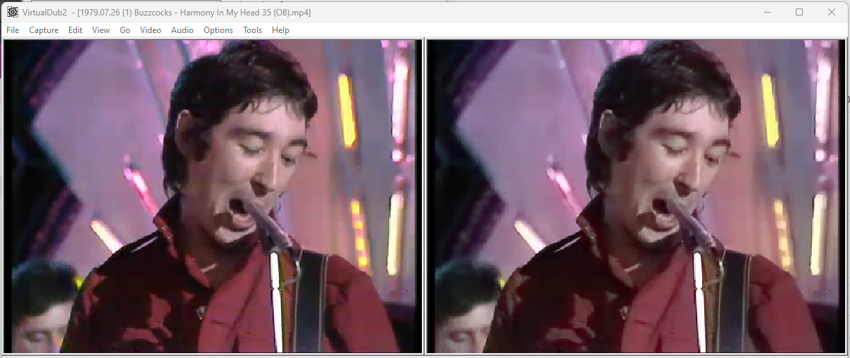

    Easy to check yourself. Get a dodgy capture and apply CCD, then see the difference. In most cases, I wind the threshold up to Full, but you may not need that much, depending on the video.
    CCD doesn't "clean" a video like Spotless or Temporal Degrain does. CCD reduces those small colour blotches that are in poor-quality videos.
    Here's a file, in this post you can play with:
    https://forum.videohelp.com/threads/416435-Which-copy-looks-better-to-you-Attachments#post2756192
    Apply CCD, set threshold to Max, and scrub along. You'll see blotchy areas which have been cleaned up a bit. Here's a still. Check out the face of the fellow at bottom-left.
    [Attachment 83309 - Click to enlarge]
    I use it a lot.

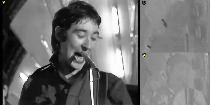

  3. For visualizing the color noise it is often helpful to inspect U and V planes, for example:
    LWLibavVideoSource("1979.07.26 BBC1 TOTP OBRV - Harmony In My Head 35.avi")
    Y=greyscale().subtitle("Y") #visualize the luma
    U=UtoY().subtitle("U") # visualize the chroma U plane
    V=VtoY().subtitle("V") #visualize the chroma V plane
    return stackhorizontal(Y,stackvertical(U,V))
    [Attachment 83311 - Click to enlarge]
    Edit: In Avisynth you may want to try the filter (for progressive video only):
    CnR2(mode="oxx")
    Edit: Here an example before/after. Top row: noisy luma and noisy chroma. Bottom row: denoised chroma (U,V) using CnR2
