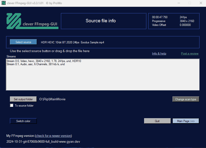

  2. You could use clever FFmpeg-GUI.
Name:	HDR10 to 8-bit SDR.gif
