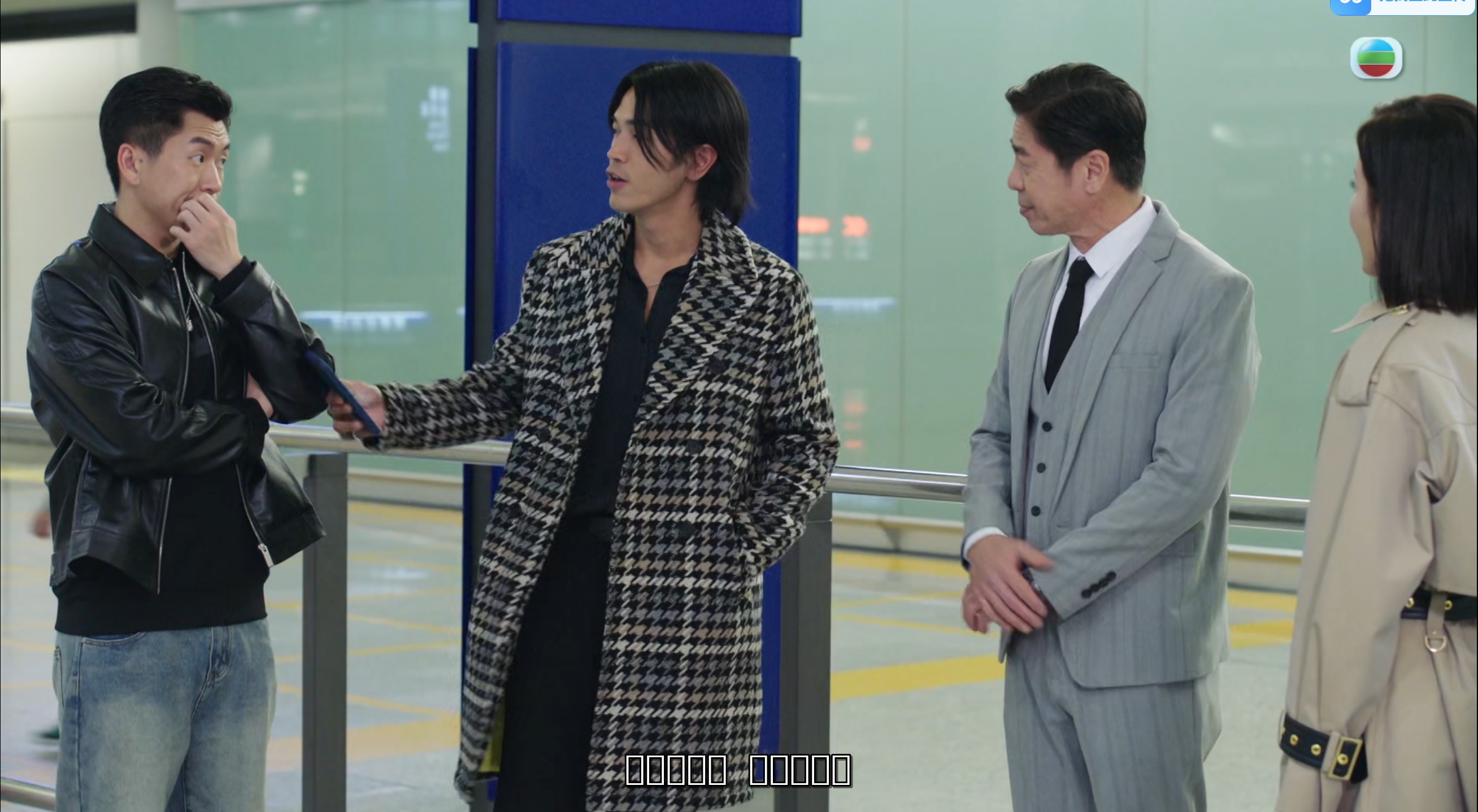

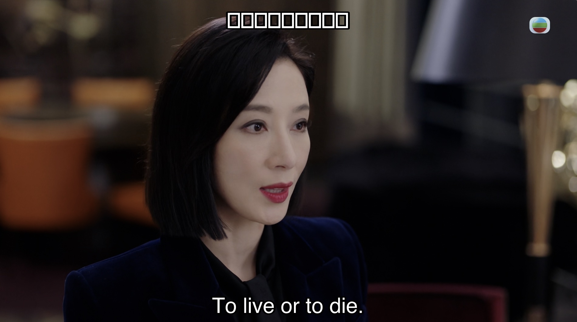

    after mixing I get video with subtitle unreliable like this (English sub seems fine, but Chinese subtitle I get this)
    [Attachment 83197 - Click to enlarge]
    and I use mkvmerge to manually muxing and still got the same results.
    HTML Code:
    mkvmerge -o test.mkv EP2.mkv 000tc.vtt
    I'm using Intel Mac with macOS 15

    tried all of them, still the same
    [Attachment 83198 - Click to enlarge]

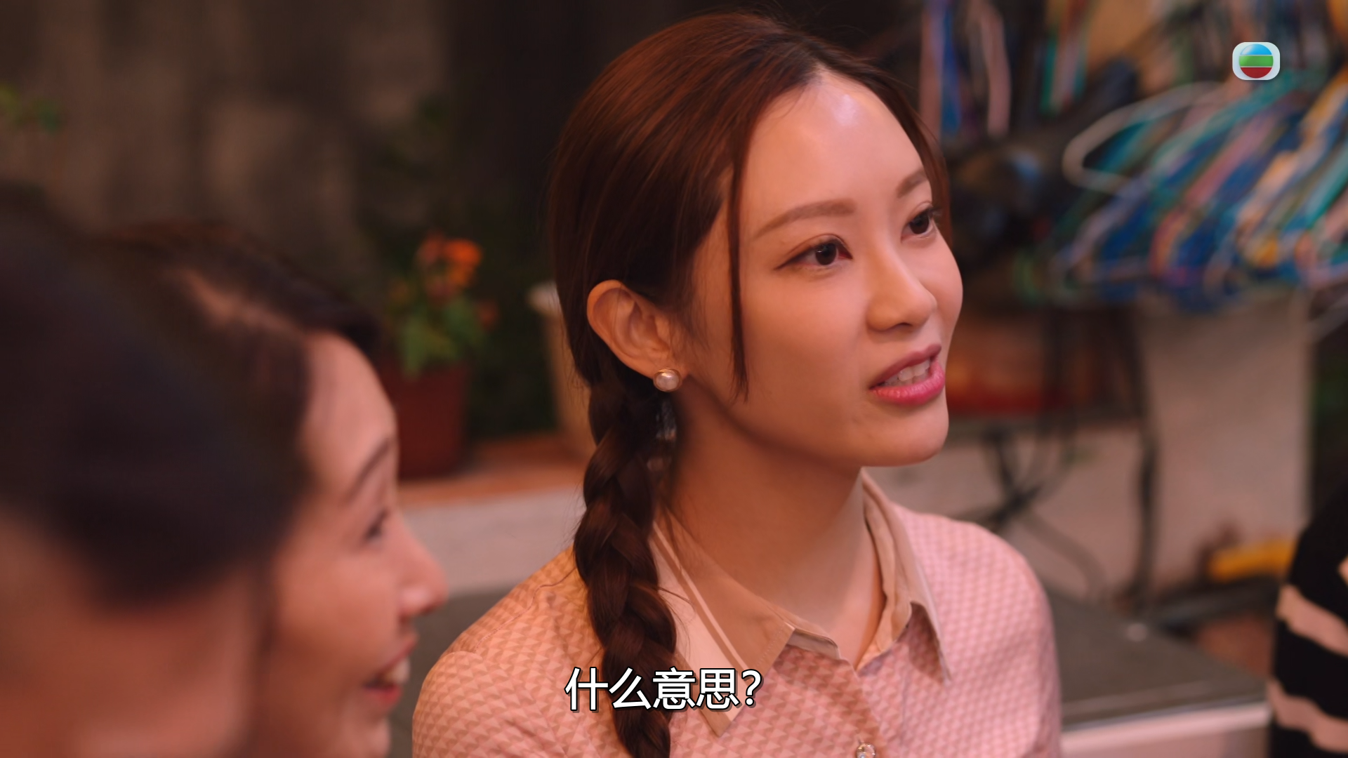

  10. ok, after updating to macOS 15.1, subtitle is normal again.
