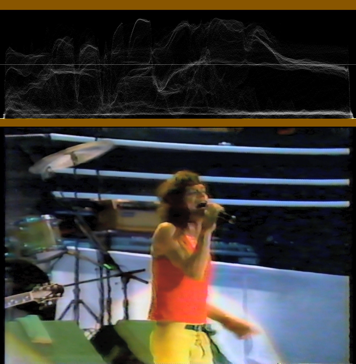

    I made the capture. it has graininess to it. this VCR plays better than my Sharp that i've been using. Let me know how i can do better. I captured with Virtualdub 2.
  7. Crushed darks. First set the levels right by adjusting the proc-amp settings of your capture device.
    (Why did you capture into RGB? Use YUV instead.)
    Just trying to "fix" it in post processing something like this may improve it a bit.
    AVISource("rolling stones capture sample.avi")
    ConverttoYV12(interlaced=true)
    assumeTFF()
    levels(16,1.6,215,16,235,coring=false)
    QTGMC(preset="fast")
    SMdegrain()
    assumeTFF()
    SMdegrain()

    Sorry, may bad. Your capture is in YUV (UYVY). Never mind.
