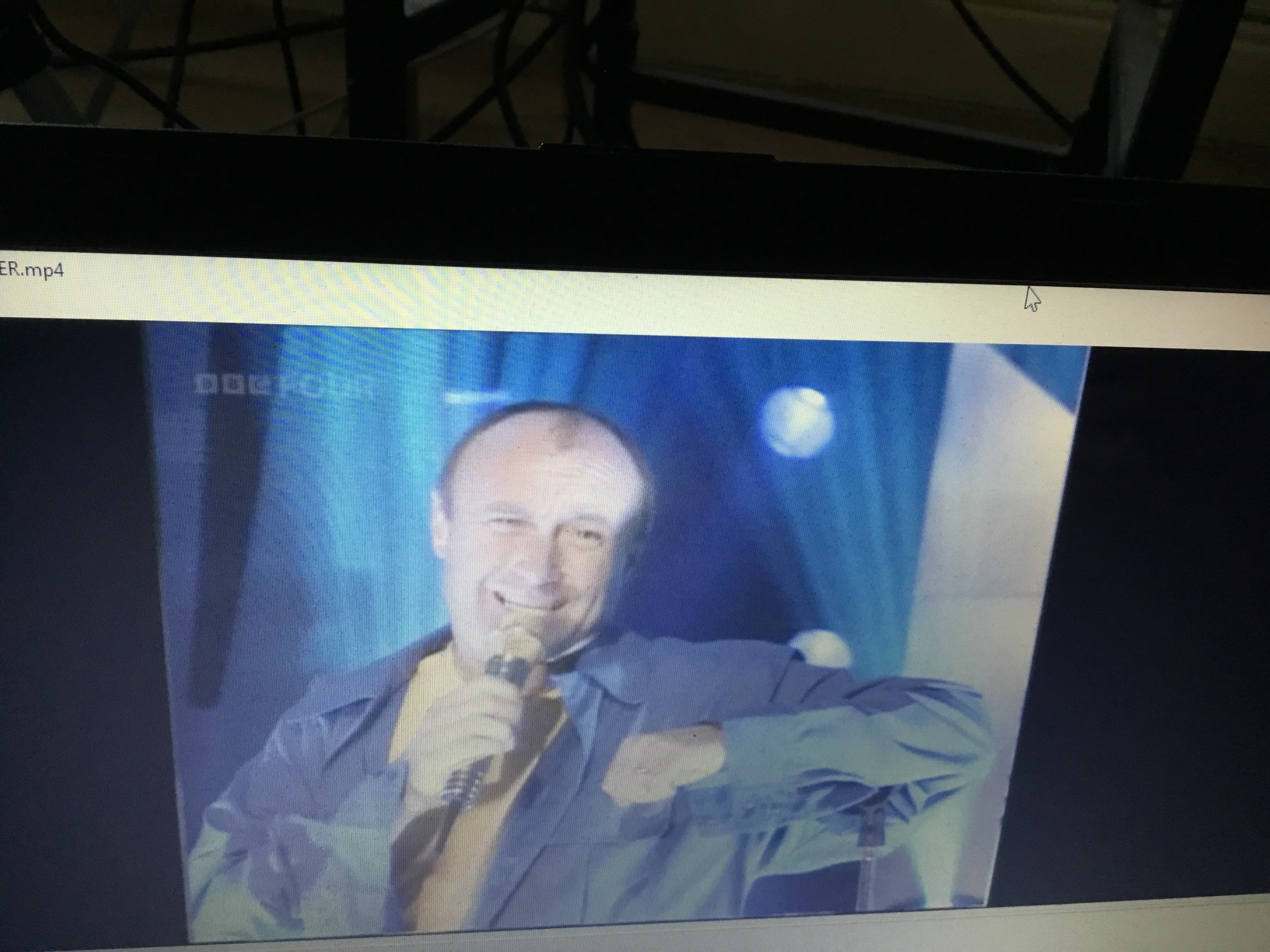

    HI THANKS SELUR i just took a picture of it it is a mp4 video file it has bbc four logo in the corner most of the softwares just blur it I am after a software that will remove the watermark Image
    [Attachment 83134 - Click to enlarge]
  4. Not a smaple, but judging from the screenshots.
    InpaintDelogo should work, proPainter will probably work too.
    1st requires Avisynth
    2nd Vapoursynth (or some coda environment).
    => happy learning and figuring out how to use them

    Also SELUR HOW DO YOU download this software PRO PAINTER SOFTWARE microsoft apps have it don’t know if that’s the same software I have checked it out on Google and I can’t seem to find it to download it but Microsoft apps have a software called pro painter for 9.99 dollars to buy don’t know if that’s the same software
    And the InpaintDelogo I can’t find that software anywhere to download I have found some pictures of this software on the doom site found on Google but no where to download it
    The pro painter software seems to be the best one to go for cos there is a short video on YouTube with someone cutting out a ice skater from a video file using this software
  6. I use proPainter (https://github.com/sczhou/ProPainter or more precise I use https://github.com/dan64/vs-propainter) through Hybrid and it's torch-addon, but Hybrid is meant for advanced users (and is rather large, especially with the addons).
    InpaintDelogo (https://forum.doom9.org/showthread.php?t=176860) is an Avisynth script.
    If you have never used Avisynth or Vapoursynth, both these solutions are probably for you.
    You probably might want to search YouTube for: remove logo from video inpaint
    This should show some tutorials on how to remove objects and logos using Abobe Premiere, Davinci Resolve, Runway, ComfyUI or similar tools.
    All these are probably easier than learning Avisynth, Vapoursynth, etc.
    Cu Selur

    Originally Posted by barry25 View Post
    There is a load of thoses ai softwares... ...if anyone has used any of thoses ai watermark softwares is there any that really work
    About usage of the worthless Chinese clickbait found-on-google scamsoft you should ask in the amateur forums like Reddit.
    Selur listed the proper options, logo removal is a video editing task, so for that you need to know how to edit videos. Heads-up, you have a very long way a head of you, considering how you "took picture" of your video file, that's not how video things work...
