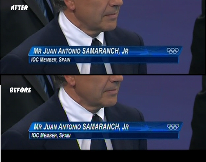

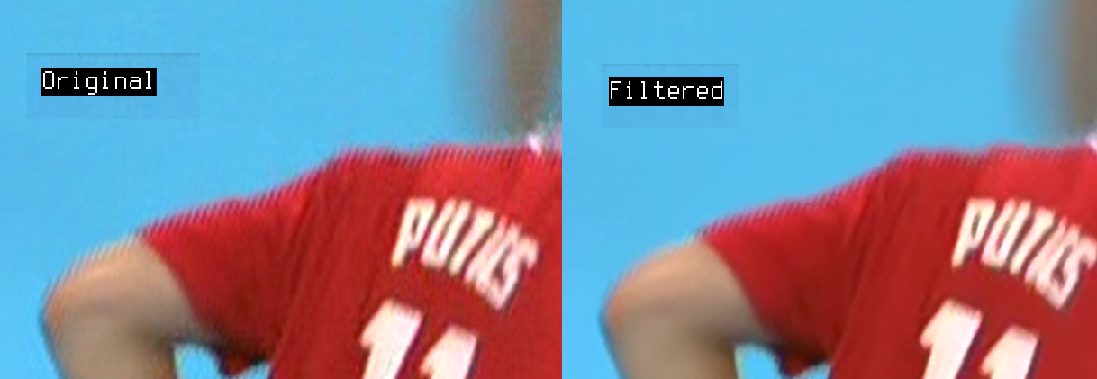

  2. Derainbow & dot crawl remover is what you need
    MPEG2Source("20120811_2319_Medallas_Fem.d2v", cpu=0)
    # 1: REMOVE RAINBOWS
    ConvertToYV16(interlaced=true) #
    orig=last
    ev=orig.assumetff().separatefields().selecteven()
    od=orig.assumetff().separatefields().selectodd()
    ev
    ue_chroma = UToY(ev).blur(0,1.5).ttempsmooth(maxr=6,lthresh=15 0, strength=2)
    ve_chroma = VToY(ev).blur(0,1.5).ttempsmooth(maxr=6,lthresh=15 0, strength=2)
    YToUV(ue_chroma, ve_chroma)
    MergeLuma(ev)
    ev_filtered=last
    od
    uo_chroma = UToY(od).blur(0,1.5).ttempsmooth(maxr=6,lthresh=15 0, strength=4)
    vo_chroma = VToY(od).blur(0,1.5).ttempsmooth(maxr=6,lthresh=15 0, strength=4)
    YToUV(uo_chroma, vo_chroma)
    MergeLuma(od)
    od_filtered=last
    interleave(ev_filtered,od_filtered)
    assumefieldbased().assumetff().weave()
    converttoyv12(interlaced=false)
    #2: DEINTERLACE
    QTGMC( Preset="fast", SourceMatch=3, Lossless=1, Sharpness=0.4, TR2=2, EdiThreads=4)
    Selecteven()
    #3: REMOVE DOT CRAWL (PROGRESSIVE ONLY)
    main=last
    main
    #checkmate (thr=12,max=12, tthr2=0) #
    bicubicresize(480,360) #
    spline36resize(720,576)
    lsfmod
    filtered=last
    main
    mt_edge().mt_expand()
    mymask=last
    mt_merge(main, filtered, mymask)

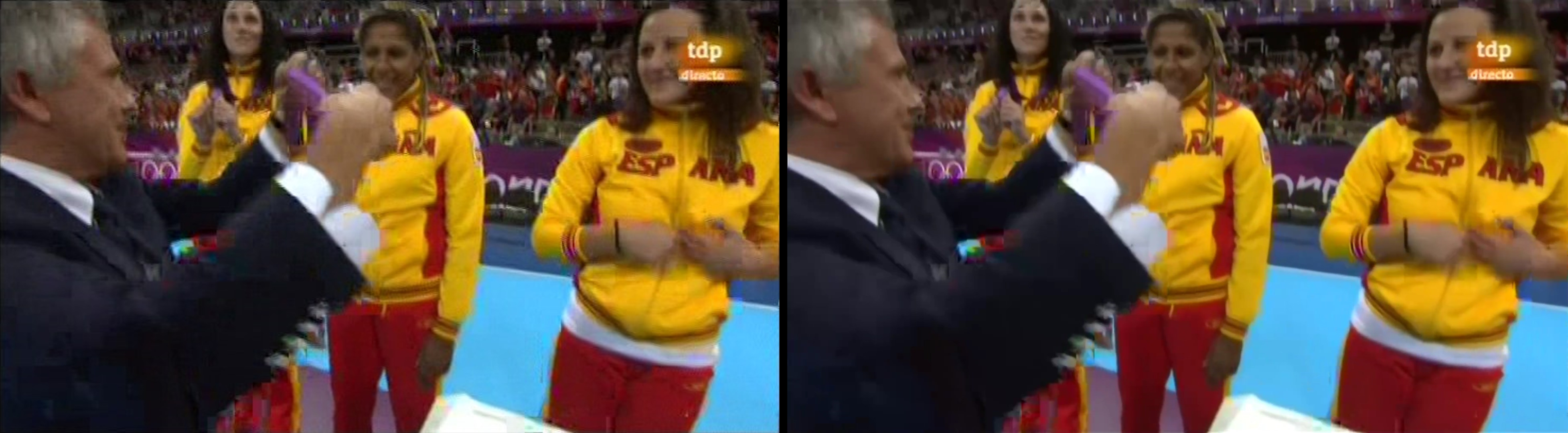

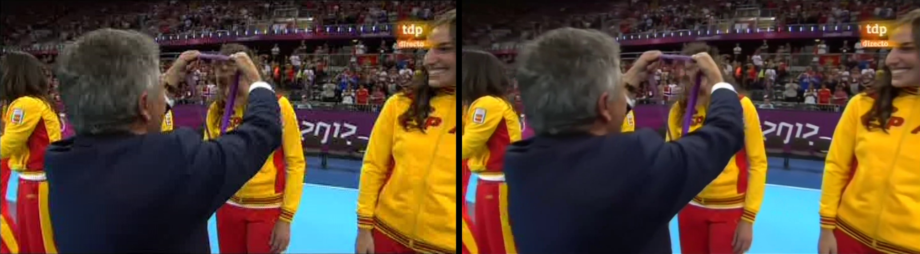

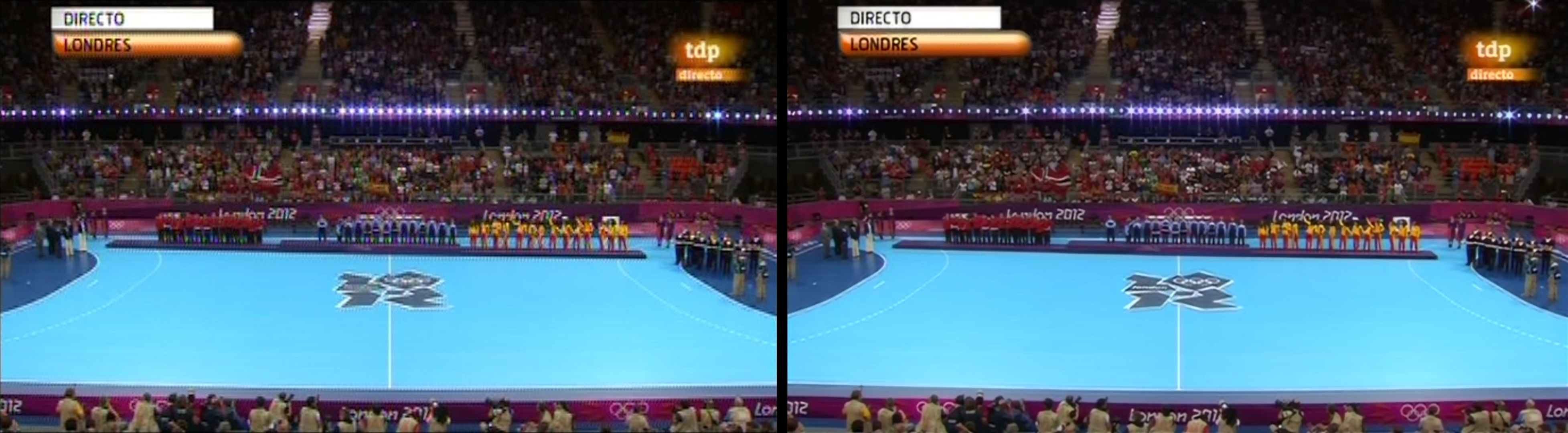

  4. @Selur
    In hindsight I should have added some screenshots comparing the source and the output I have so far so you don't have to download the whole video. Here they are:
    [Attachment 83085 - Click to enlarge]
    [Attachment 83081 - Click to enlarge]
    This is much, much cleaner, but of course the faces remain garbled because the original is garbage.
    [Attachment 83083 - Click to enlarge]
    Again, overall pretty clean and like the faces, the buttons on the jacket were garbage and will always look like garbage.

    One last question, is there any way to fix the edges of the t-shirt and elbow? I tried several filters and didn't see any improvement.
    Probably. Using some strong filtering and limiting around edges might work.
