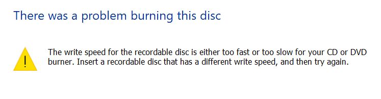

[Attachment 83047 - Click to enlarge]
Hello. New user here. I have a problem burning on my newly bought external DVD. It's reads all the discs I put into it but somehow when I'm trying to burn some videos, I got this problem. Is this a software problem or a hardware problem? I'm using Windows 10 OS.
Hope someone can help. Thanks.
Results 1 to 30 of 40
The error is telling you that your optical drive can not burn the disk you are trying to use because the speed of the disk is wrong for your optical drive.
I have never had this happen. I have had a very old disk not work . I believe because a newer optical drive no longer supported the manufacturers disk code.
Read the specifications for your optical drive. Match a new disk with the correct speed to that.
It can also depend on the chip in the enclosure.Is this enclosure old ?
Even if the optical drive is new ?

1. Can you advise of make/model of this optical drive.
2. Assuming that you did, indeed, purchase a burner and not a simple player, the advice of using imgburn is a good one. What program were you using ?
3. The rule of thumb is to burn at no more than 50% of the rated burn-speed of the blank media. Thus 16x media should only be burnt at a maimum of 8x.
4. And, finally, that the drive does support the media. That is to say that you are not attempting to burn dvd-R when the drive only supports dvd+R or vice-versa. -

Try again. But this time set your burn speed to 4x or, better still 2.4x and NOT MAX which appears to be 8x
Unless that drive supports an external power supply/adapter you can only plug the cable into the PC.

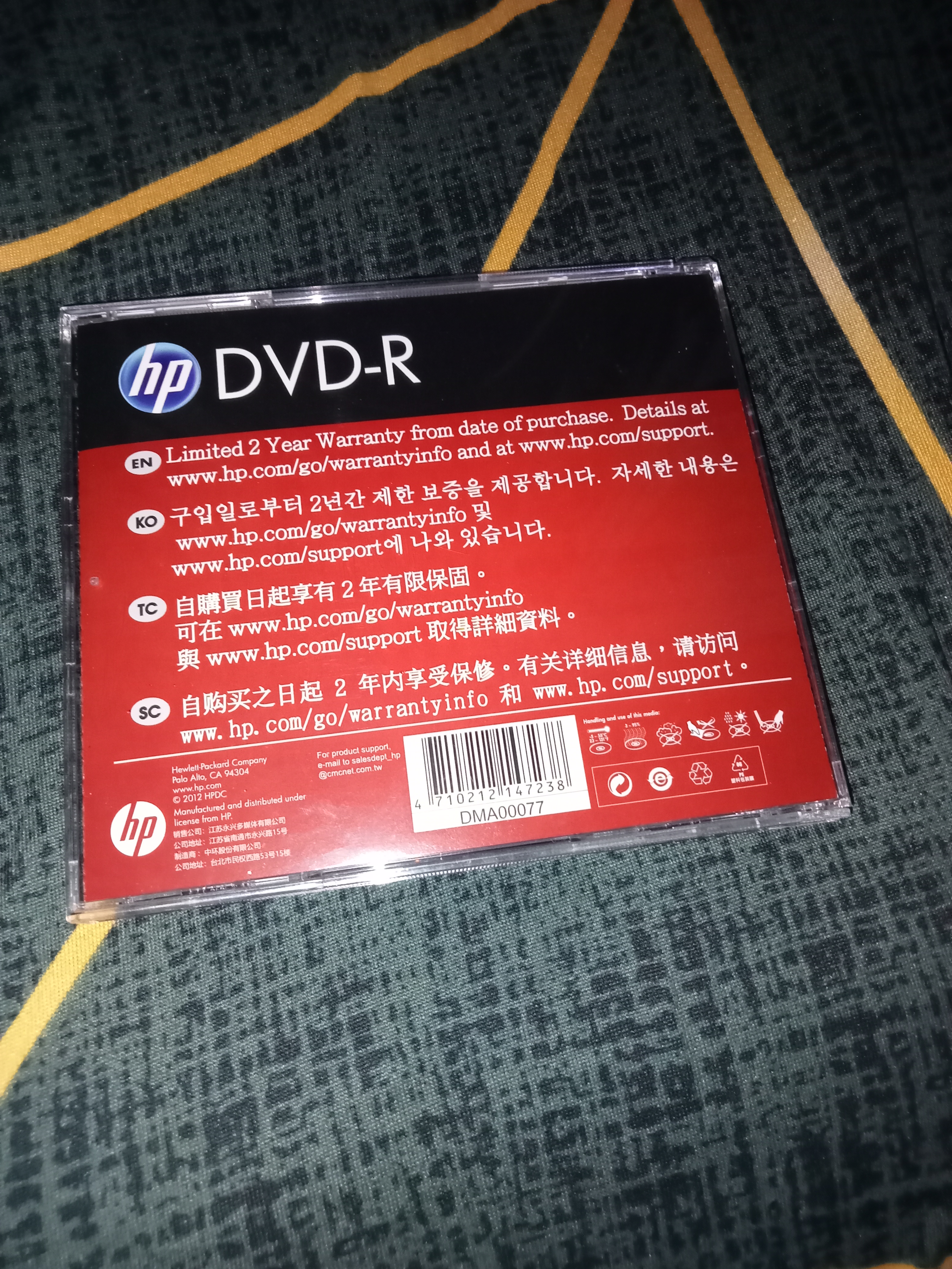

And BTW what blank media are you using ? -

I missed reading the above.
I do not know if this would cause a problem.
I guess lack of enough power could.
All of my external enclosures have a power source.
One plugs strait into the house outlet & one is powered with a "wall wart" or power adapter.
Is your enclosure powered by your PCs USB inputs ?
If so are there two usb plugs on your enclosure ? -
Sounds like a power issue, or the write laser is bad.
If the enclosure has two usb plugs try plugging the power one into a charger that has an output over 1.5A. -
I'm more of a could be a power problem.
I have a surge protector similar to this one: surge protector
That is what I would use to power your enclosure. -
Ok. Just got back from vacation and tried it. But still getting this.

W 15:28:14 Retry Failed - Reason: Power Calibration Area Error
W 15:28:14 Retrying (20 of 20)...
E 15:28:17 Failed to Write Sectors 256 - 287 - Reason: Power Calibration Area Error
I 15:28:17 Synchronising Cache...
W 15:28:20 User opted to skip the 'Close Track/Session/Disc' functions.
E 15:28:20 Failed to Write Image!
E 15:28:20 Operation Failed! - Duration: 00:00:21
I 15:28:20 Average Write Rate: 0 KiB/s (0.0x) - Maximum Write Rate: 0 KiB/s (0.0x)
Maybe the drive I bought is bad? Is Windows 10 blocking the burning capability? -

[Attachment 83243 - Click to enlarge]
Here is the blank DVD I bought. I somehow migrated to house power during the burning I posted above. -

^^ Slight problem my friend.
The OP is using a DVD-R disk not +R.
And that cover tells us nothing about the write speeds of the media so tried. I have looked at various sites to attempt to find the specs for this drive. Whether it supports DVD-R and DVD+R. But what I have found is that you are not alone in finding this drive reads but does not write. So I must assume that the drive is NOT a burner. End of. -
@DB83,
The jewel case in the picture is for a DVD-R disk & I saw that.
I trust ImgBurn's log for the disc.
Post # 7: I 18:01:00 Destination Media Type: DVD+R (Disc ID: MCC-003-00)
Post # 20 first write:I 15:26:27 Destination Media Type: DVD+R (Disc ID: MCC-003-00)
Second write: I 15:27:58 Destination Media Type: DVD+R (Disc ID: MCC-003-00)
This is what ImgBurn shows to be the drive:MATSHITA DVD-RAM UJ890AS 1.00 (E (USB)
As best as I can tell this is the same drive Amazon has.
https://www.amazon.com/Computer-Internal-Tray-Loading-Optical-Matshita/dp/B081QYZZZT
