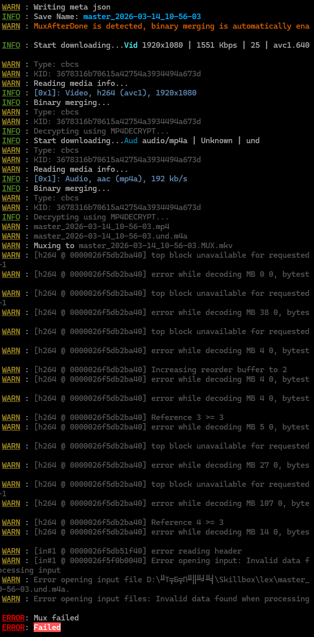

  7. Hello everyone! Can you please help me:
    I want to download a video from skillbox.ru, but I'm getting this error.
    [Attachment 91495 - Click to enlarge]
    do you have ffmpeg installed ??
  9. Originally Posted by october262 View Post
    Yes. I use ffmpeg, mp4decrypt, N_m3u8DL-RE and WineProxy2
    N_m3u8DL-RE  "URL" --key kid:key --use-shaka-packager -M format=mp4
    In other site I have no problem, it works. But in skillbox.ru I have this problem

    what is --key KID:KEY? did you add in cmd

    You might want to try again disabling Shaka_Packager as well. Sometimes it fails.
  12. Originally Posted by iamghost View Post
    My bad, I meant kid:key, of course.
    Here’s the widevine cmd I’m using — can’t download it, keeps giving this error:
    N_m3u8DL-RE "https://kinescope.io/c33662d6-085b-40c2-bc06-8e97580ba2e1/master.m3u8?expires=1773550393&sign=23b953c9b67a68d8&token=eyJ0eXAiOiJKV1QiLCJhbGciOiJIUzI1NiJ9.eyJ1c2VyX2lkIjoiOWUyMjI5MTEtYzZhOS00NGJiLTgyN2QtODI4ZjE2NTAyMDcyIiwidmlkZW9faWQiOiJjMzM2NjJkNi0wODViLTQwYzItYmMwNi04ZTk3NTgwYmEyZTEiLCJpcCI6IjIxMi4xMTIuMTIyLjE4NiIsImV4cCI6MTc3MzQ2NDg5Mn0.lkzyT-v7ERM5ACyGYYM3WKOxGXCarjA8CoNG4wPMeSk" -H "User-Agent: Mozilla/5.0 (Windows NT 10.0; Win64; x64) AppleWebKit/537.36 (KHTML, like Gecko) Chrome/145.0.0.0 Safari/537.36" -H "Accept: */*" -H "Referer: https://kinescope.io/embed/q78svMehF7ys7UiFXs2ZkF?drmauthtoken=eyJ0eXAiOiJKV1QiLCJhbGciOiJIUzI1NiJ9.eyJ1c2VyX2lkIjoiOWUyMjI5MTEtYzZhOS00NGJiLTgyN2QtODI4ZjE2NTAyMDcyIiwidmlkZW9faWQiOiJjMzM2NjJkNi0wODViLTQwYzItYmMwNi04ZTk3NTgwYmEyZTEiLCJpcCI6IjIxMi4xMTIuMTIyLjE4NiIsImV4cCI6MTc3MzQ2NDg5Mn0.lkzyT-v7ERM5ACyGYYM3WKOxGXCarjA8CoNG4wPMeSk&v=2.179.6&_=cGxheWVySWQ9X19raW5lc2NvcGVfcGxheWVyXzcmc2l6ZSU1QndpZHRoJTVEPTEwMCUyNSZzaXplJTVCaGVpZ2h0JTVEPTEwMCUyNSZiZWhhdmlvdXIlNUJhdXRvUGF1c2UlNUQ9dHJ1ZSZiZWhhdmlvdXIlNUJwbGF5c0lubGluZSU1RD10cnVlJmJlaGF2aW91ciU1QnByZWxvYWQlNUQ9dHJ1ZSZiZWhhdmlvdXIlNUJsb2NhbFN0b3JhZ2UlNUQ9dHJ1ZSZwbGF5bGlzdCU1QjAlNUQlNUJkcm0lNUQlNUJhdXRoJTVEJTVCdG9rZW4lNUQ9ZXlKMGVYQWlPaUpLVjFRaUxDSmhiR2NpT2lKSVV6STFOaUo5LmV5SjFjMlZ5WDJsa0lqb2lPV1V5TWpJNU1URXRZelpoT1MwME5HSmlMVGd5TjJRdE9ESTRaakUyTlRBeU1EY3lJaXdpZG1sa1pXOWZhV1FpT2lKak16TTJOakprTmkwd09EVmlMVFF3WXpJdFltTXdOaTA0WlRrM05UZ3dZbUV5WlRFaUxDSnBjQ0k2SWpJeE1pNHhNVEl1TVRJeUxqRTROaUlzSW1WNGNDSTZNVGMzTXpRMk5EZzVNbjAubGt6eVQtdjdFUk01QUN5R1lZTTNXS094R1hDYXJqQThDb05HNHdQTWVTayZ1aSU1Qmxhbmd1YWdlJTVEPXJ1JnVpJTVCcGxheWJhY2tSYXRlQnV0dG9uJTVEPWZhbHNl" --key 516d53786f3551792d4548316c77633d:5443526378656e704230594c4e53383d --use-shaka-packager -M format=mkv
  13. Originally Posted by doctorm View Post
    I already tried it without that - same error. And also I tried format=mp4, still getting the same error

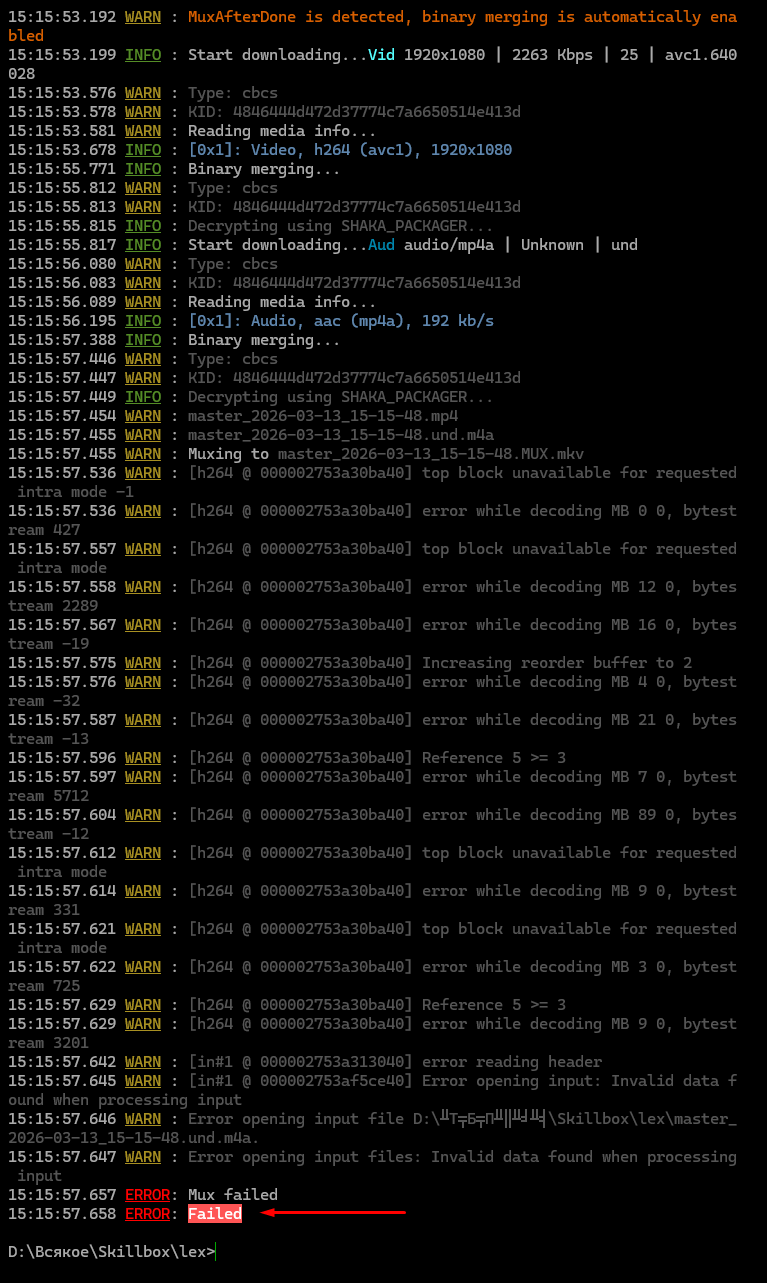

    [Attachment 91502 - Click to enlarge]
    Feb 2006
    tried downloading your video using your command, everything downloaded ok (no erros) but will not play.
    you might have a bad file.
  15. Originally Posted by october262 View Post
    The problem is that when there are multiple videos on the same page say 4 of them - 1 or 2 will download but the others throw errors. Sometimes none of them download at all. After a few tries, they somehow downloaded for no obvious reason. In another thread, someone said it might be the wrong key but these are all coming straight from widevine.
    Added: When it fails with that error the files still get downloaded but they won’t play.
    For example, here’s the code there shouldn’t be any issue with this one and it downloads just fine
    N_m3u8DL-RE "https://kinescope.io/8f9e03bf-1649-4c84-a289-5c94b3abf1ef/master.m3u8?expires=1773557703&sign=2f849d8dbe74c57f&token=eyJ0eXAiOiJKV1QiLCJhbGciOiJIUzI1NiJ9.eyJ1c2VyX2lkIjoiOWUyMjI5MTEtYzZhOS00NGJiLTgyN2QtODI4ZjE2NTAyMDcyIiwidmlkZW9faWQiOiI4ZjllMDNiZi0xNjQ5LTRjODQtYTI4OS01Yzk0YjNhYmYxZWYiLCJpcCI6IjIxMi4xMTIuMTIyLjE4NiIsImV4cCI6MTc3MzQ3MjIwMX0.C5lP4sjIqL7z2V4tMstmGa_nZLdHtuYuuP8K4xT-N7c" -H "User-Agent: Mozilla/5.0 (Windows NT 10.0; Win64; x64) AppleWebKit/537.36 (KHTML, like Gecko) Chrome/145.0.0.0 Safari/537.36" -H "Accept: */*" -H "Referer: https://kinescope.io/embed/iJAKQN61eUKeVhbC6r9CZ6?drmauthtoken=eyJ0eXAiOiJKV1QiLCJhbGciOiJIUzI1NiJ9.eyJ1c2VyX2lkIjoiOWUyMjI5MTEtYzZhOS00NGJiLTgyN2QtODI4ZjE2NTAyMDcyIiwidmlkZW9faWQiOiI4ZjllMDNiZi0xNjQ5LTRjODQtYTI4OS01Yzk0YjNhYmYxZWYiLCJpcCI6IjIxMi4xMTIuMTIyLjE4NiIsImV4cCI6MTc3MzQ3MjIwMX0.C5lP4sjIqL7z2V4tMstmGa_nZLdHtuYuuP8K4xT-N7c&v=2.179.6&_=cGxheWVySWQ9X19raW5lc2NvcGVfcGxheWVyXzEmc2l6ZSU1QndpZHRoJTVEPTEwMCUyNSZzaXplJTVCaGVpZ2h0JTVEPTEwMCUyNSZiZWhhdmlvdXIlNUJhdXRvUGF1c2UlNUQ9dHJ1ZSZiZWhhdmlvdXIlNUJwbGF5c0lubGluZSU1RD10cnVlJmJlaGF2aW91ciU1QnByZWxvYWQlNUQ9dHJ1ZSZiZWhhdmlvdXIlNUJsb2NhbFN0b3JhZ2UlNUQ9dHJ1ZSZwbGF5bGlzdCU1QjAlNUQlNUJkcm0lNUQlNUJhdXRoJTVEJTVCdG9rZW4lNUQ9ZXlKMGVYQWlPaUpLVjFRaUxDSmhiR2NpT2lKSVV6STFOaUo5LmV5SjFjMlZ5WDJsa0lqb2lPV1V5TWpJNU1URXRZelpoT1MwME5HSmlMVGd5TjJRdE9ESTRaakUyTlRBeU1EY3lJaXdpZG1sa1pXOWZhV1FpT2lJNFpqbGxNRE5pWmkweE5qUTVMVFJqT0RRdFlUSTRPUzAxWXprMFlqTmhZbVl4WldZaUxDSnBjQ0k2SWpJeE1pNHhNVEl1TVRJeUxqRTROaUlzSW1WNGNDSTZNVGMzTXpRM01qSXdNWDAuQzVsUDRzaklxTDd6MlY0dE1zdG1HYV9uWkxkSHR1WXV1UDhLNHhULU43YyZ1aSU1Qmxhbmd1YWdlJTVEPXJ1JnVpJTVCcGxheWJhY2tSYXRlQnV0dG9uJTVEPWZhbHNl" --key 6e3944396f725872583238416e73593d:3562744245715f37354635697761513d --use-shaka-packager -M format=mkv

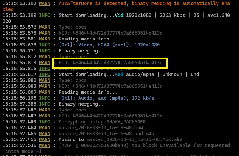

    [Attachment 91505 - Click to enlarge]
    your KID is not match so It wrong key

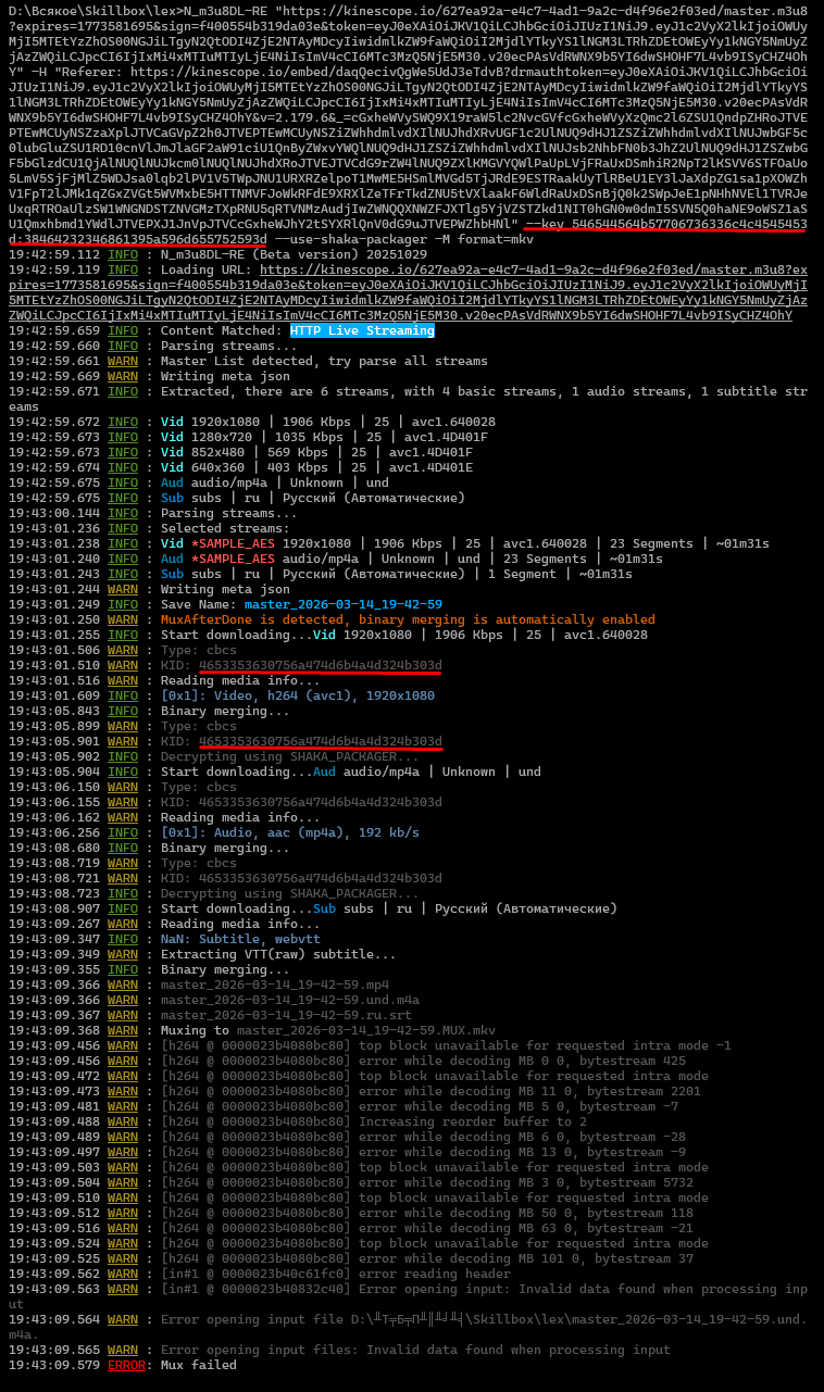

  17. Originally Posted by iamghost View Post
    Thanks for pointing that out so precisely. What I still can’t understand is this: if I paste the correct keys from widevine why does the command end up using the key from a different video - one that had already downloaded successfully earlier?
    N_m3u8DL-RE "https://kinescope.io/627ea92a-e4c7-4ad1-9a2c-d4f96e2f03ed/master.m3u8?expires=1773581695&sign=f400554b319da03e&token=eyJ0eXAiOiJKV1QiLCJhbGciOiJIUzI1NiJ9.eyJ1c2VyX2lkIjoiOWUyMjI5MTEtYzZhOS00NGJiLTgyN2QtODI4ZjE2NTAyMDcyIiwidmlkZW9faWQiOiI2MjdlYTkyYS1lNGM3LTRhZDEtOWEyYy1kNGY5NmUyZjAzZWQiLCJpcCI6IjIxMi4xMTIuMTIyLjE4NiIsImV4cCI6MTc3MzQ5NjE5M30.v20ecPAsVdRWNX9b5YI6dwSHOHF7L4vb9ISyCHZ4OhY" -H "Referer: https://kinescope.io/embed/daqQecivQgWe5UdJ3eTdvB?drmauthtoken=eyJ0eXAiOiJKV1QiLCJhbGciOiJIUzI1NiJ9.eyJ1c2VyX2lkIjoiOWUyMjI5MTEtYzZhOS00NGJiLTgyN2QtODI4ZjE2NTAyMDcyIiwidmlkZW9faWQiOiI2MjdlYTkyYS1lNGM3LTRhZDEtOWEyYy1kNGY5NmUyZjAzZWQiLCJpcCI6IjIxMi4xMTIuMTIyLjE4NiIsImV4cCI6MTc3MzQ5NjE5M30.v20ecPAsVdRWNX9b5YI6dwSHOHF7L4vb9ISyCHZ4OhY&v=2.179.6&_=cGxheWVySWQ9X19raW5lc2NvcGVfcGxheWVyXzQmc2l6ZSU1QndpZHRoJTVEPTEwMCUyNSZzaXplJTVCaGVpZ2h0JTVEPTEwMCUyNSZiZWhhdmlvdXIlNUJhdXRvUGF1c2UlNUQ9dHJ1ZSZiZWhhdmlvdXIlNUJwbGF5c0lubGluZSU1RD10cnVlJmJlaGF2aW91ciU1QnByZWxvYWQlNUQ9dHJ1ZSZiZWhhdmlvdXIlNUJsb2NhbFN0b3JhZ2UlNUQ9dHJ1ZSZwbGF5bGlzdCU1QjAlNUQlNUJkcm0lNUQlNUJhdXRoJTVEJTVCdG9rZW4lNUQ9ZXlKMGVYQWlPaUpLVjFRaUxDSmhiR2NpT2lKSVV6STFOaUo5LmV5SjFjMlZ5WDJsa0lqb2lPV1V5TWpJNU1URXRZelpoT1MwME5HSmlMVGd5TjJRdE9ESTRaakUyTlRBeU1EY3lJaXdpZG1sa1pXOWZhV1FpT2lJMk1qZGxZVGt5WVMxbE5HTTNMVFJoWkRFdE9XRXlZeTFrTkdZNU5tVXlaakF6WldRaUxDSnBjQ0k2SWpJeE1pNHhNVEl1TVRJeUxqRTROaUlzSW1WNGNDSTZNVGMzTXpRNU5qRTVNMzAudjIwZWNQQXNWZFJXTlg5YjVZSTZkd1NIT0hGN0w0dmI5SVN5Q0haNE9oWSZ1aSU1Qmxhbmd1YWdlJTVEPXJ1JnVpJTVCcGxheWJhY2tSYXRlQnV0dG9uJTVEPWZhbHNl" --key 546544564b57706736336c4c4545453d:38464232346861395a596d655752593d --use-shaka-packager -M format=mkv
    [Attachment 91506 - Click to enlarge]
    I had run this code earlier, and that video downloaded without any issues. Now all the other videos are being processed with that same key.
    N_m3u8DL-RE "https://kinescope.io/627ea92a-e4c7-4ad1-9a2c-d4f96e2f03ed/master.m3u8?expires=1773581695&sign=f400554b319da03e&token=eyJ0eXAiOiJKV1QiLCJhbGciOiJIUzI1NiJ9.eyJ1c2VyX2lkIjoiOWUyMjI5MTEtYzZhOS00NGJiLTgyN2QtODI4ZjE2NTAyMDcyIiwidmlkZW9faWQiOiI2MjdlYTkyYS1lNGM3LTRhZDEtOWEyYy1kNGY5NmUyZjAzZWQiLCJpcCI6IjIxMi4xMTIuMTIyLjE4NiIsImV4cCI6MTc3MzQ5NjE5M30.v20ecPAsVdRWNX9b5YI6dwSHOHF7L4vb9ISyCHZ4OhY" -H "User-Agent: Mozilla/5.0 (Windows NT 10.0; Win64; x64) AppleWebKit/537.36 (KHTML, like Gecko) Chrome/145.0.0.0 Safari/537.36" -H "Accept: */*" -H "Referer: https://kinescope.io/embed/daqQecivQgWe5UdJ3eTdvB?drmauthtoken=eyJ0eXAiOiJKV1QiLCJhbGciOiJIUzI1NiJ9.eyJ1c2VyX2lkIjoiOWUyMjI5MTEtYzZhOS00NGJiLTgyN2QtODI4ZjE2NTAyMDcyIiwidmlkZW9faWQiOiI2MjdlYTkyYS1lNGM3LTRhZDEtOWEyYy1kNGY5NmUyZjAzZWQiLCJpcCI6IjIxMi4xMTIuMTIyLjE4NiIsImV4cCI6MTc3MzQ5NjE5M30.v20ecPAsVdRWNX9b5YI6dwSHOHF7L4vb9ISyCHZ4OhY&v=2.179.6&_=cGxheWVySWQ9X19raW5lc2NvcGVfcGxheWVyXzQmc2l6ZSU1QndpZHRoJTVEPTEwMCUyNSZzaXplJTVCaGVpZ2h0JTVEPTEwMCUyNSZiZWhhdmlvdXIlNUJhdXRvUGF1c2UlNUQ9dHJ1ZSZiZWhhdmlvdXIlNUJwbGF5c0lubGluZSU1RD10cnVlJmJlaGF2aW91ciU1QnByZWxvYWQlNUQ9dHJ1ZSZiZWhhdmlvdXIlNUJsb2NhbFN0b3JhZ2UlNUQ9dHJ1ZSZwbGF5bGlzdCU1QjAlNUQlNUJkcm0lNUQlNUJhdXRoJTVEJTVCdG9rZW4lNUQ9ZXlKMGVYQWlPaUpLVjFRaUxDSmhiR2NpT2lKSVV6STFOaUo5LmV5SjFjMlZ5WDJsa0lqb2lPV1V5TWpJNU1URXRZelpoT1MwME5HSmlMVGd5TjJRdE9ESTRaakUyTlRBeU1EY3lJaXdpZG1sa1pXOWZhV1FpT2lJMk1qZGxZVGt5WVMxbE5HTTNMVFJoWkRFdE9XRXlZeTFrTkdZNU5tVXlaakF6WldRaUxDSnBjQ0k2SWpJeE1pNHhNVEl1TVRJeUxqRTROaUlzSW1WNGNDSTZNVGMzTXpRNU5qRTVNMzAudjIwZWNQQXNWZFJXTlg5YjVZSTZkd1NIT0hGN0w0dmI5SVN5Q0haNE9oWSZ1aSU1Qmxhbmd1YWdlJTVEPXJ1JnVpJTVCcGxheWJhY2tSYXRlQnV0dG9uJTVEPWZhbHNl" --key 4653353630756a474d6b4a4d324b303d:7171316d437750386b704a764b46673d --use-shaka-packager -M format=mkv

  19. Originally Posted by iamghost View Post
    I dont know which video you try download, I need check...
    skillbox.ru video url? not mpd or m3u8
    Yes, go.skillbox.ru
    m3u8
    I noticed that when I paste commands for other videos with different keys they all end up running with the same key - the one from the video that downloaded successfully earlier. For example, when I open a lesson that has 5 videos, one of them downloads fine, but the rest of the commands end up running with the key from that same video.

    huh? what? Im asking for link you are trying to download
    each video have their own KID with different keys not 1 key get all videos

    It’s a paid course with access through a private account, so I can’t share the link.
    Let me repeat one more time: there are several videos, and each video has its own kid:key. But when I paste a command into the console for a specific video with its correct kid:key, the console ends up using the kid:key from a different video instead.
    Please take a close look at my screenshot above: I pasted a command with these kid:key:
    but in the end it used the kid:key from a different video:
    I got the correct kid:key for each video from widevine, but the same kid:key keeps being used for all the others.
    Anyway I appreciate your time and the suggestions! Thanks for the help.
