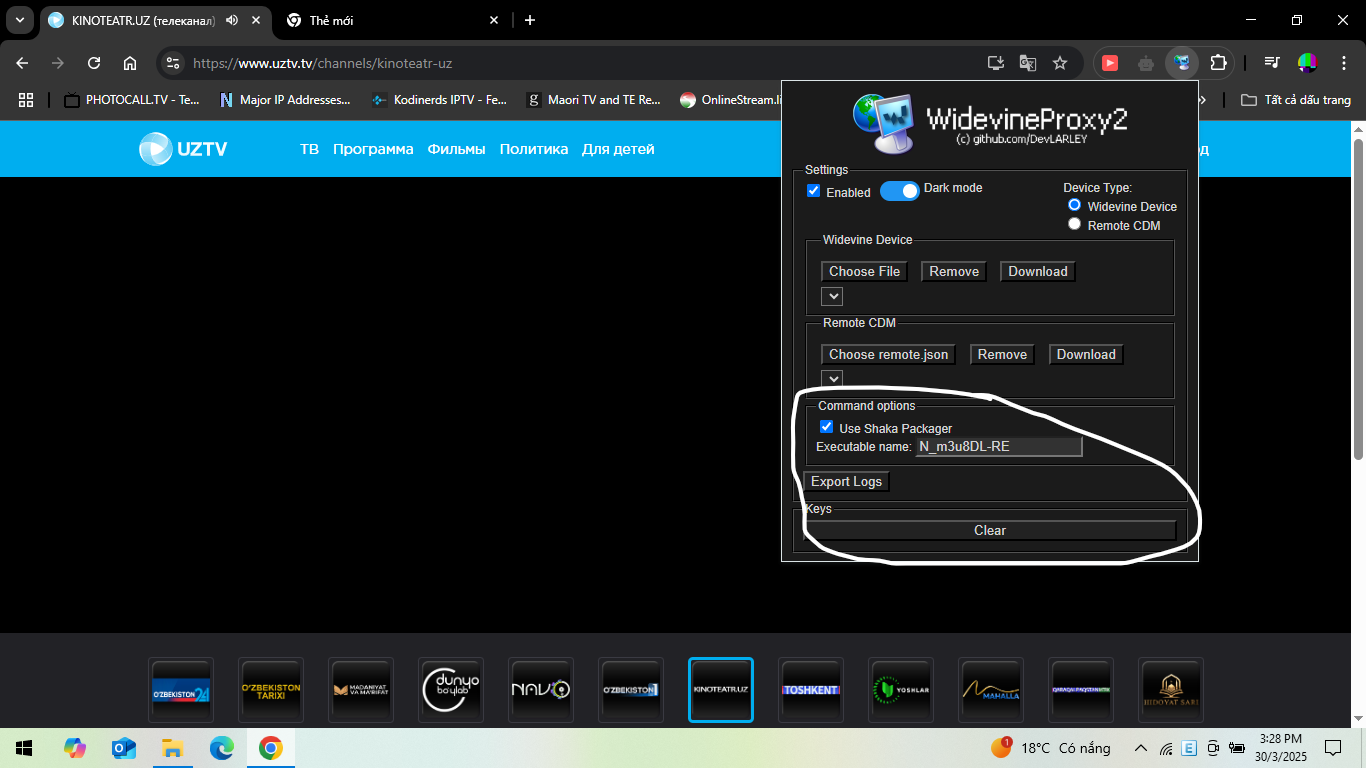

  3. Hi, I need help.
    I tried following everyone's instructions in the WidevineProxy2 addons but still can't get the key.
    Can anyone help me fix it? Thanks.
    The channel is still playing but has drm so the screen is black.

  4. Works here. No idea what you are doing wrong.
  5. Originally Posted by tungbeng95 View Post
    Hi, I need help.
    You have not added the wvd device to the tool
  6. Oops - indeed, I've missed that very important detail...
  7. How to add the wvd device to the tool? Please help me because I don't know much for this
  8. I'd advise you to read the start post of this thread again. Pay attention to the "Setup" section, which explains in detail what you have to do.

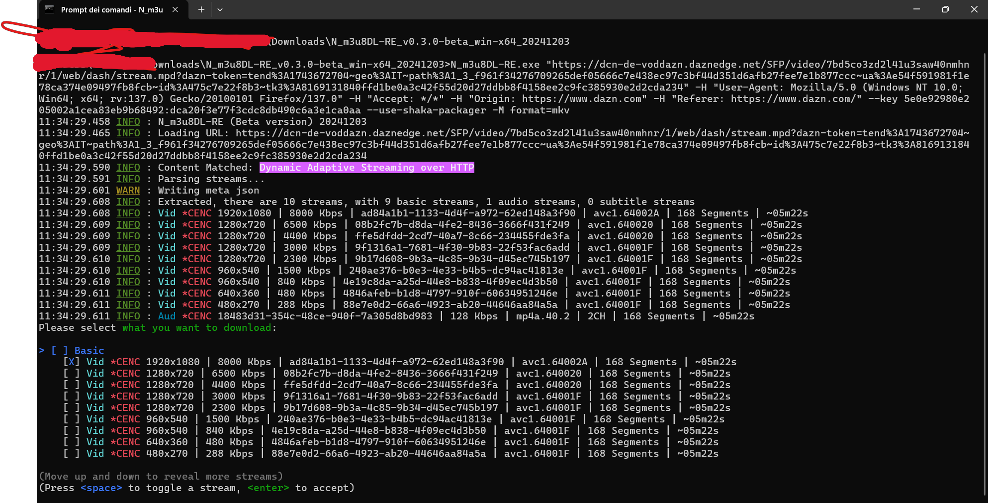

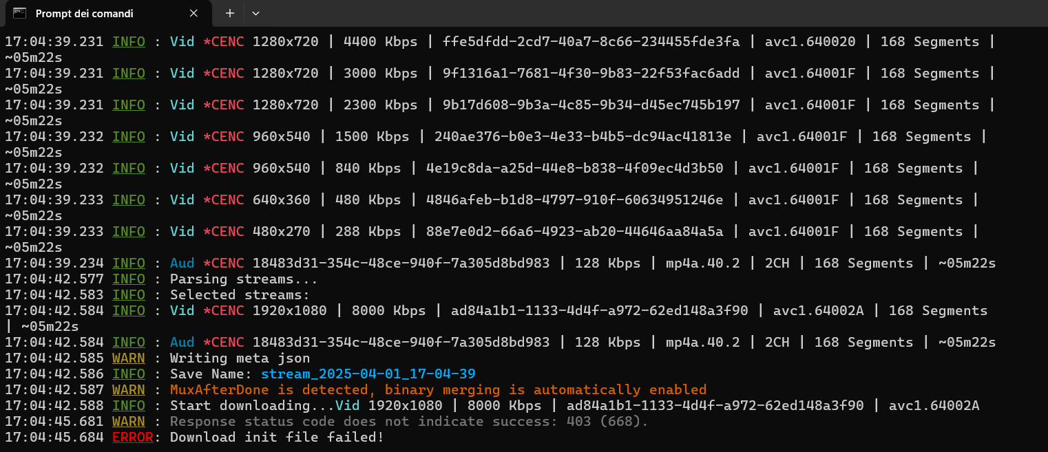

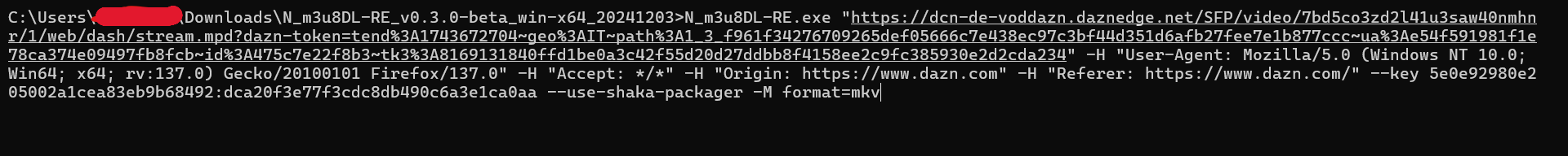

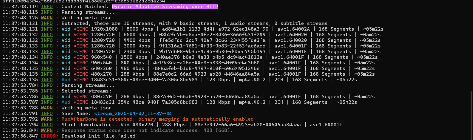

  11. Hi!
    First of all, thank you for the work,
    but it gives me the following error :Image
    [Attachment 86413 - Click to enlarge]
    what can it be?
    I am using firefox, and I am using a widewine device downloaded from the forum.
  12. Probably exactly what the error message says: status 403 means "forbidden". Which can have a lot of reasons.
    You are trying to download a video resolution 1920x1080 from a URL you don't mention. Did you obtain the command from a video with that resolution? Do the lower resolutions error out with the same error?
  13. Can someone please tell me how to change user-agent for WidevineProxy2 Extension?I'm using chrome on mac, it won't get 1080p from channel 4, but woks on windows. Then someone on this forum said changing user-agent might solve it, so I use "User-Agent Switcher and Manager" extension to change user-agent to windows, but still get mac user-agent "User-Agent: Mozilla/5.0 (Macintosh; Intel Mac OS X 10_15_7) AppleWebKit/537.36 (KHTML, like Gecko) Chrome/134.0.0.0 Safari/537.36" from cmd.
  14. @morgancasey: Can't help you here. First I'm not willing to type the command from a screenshot to try myself. Then I guess it geo restricted, and last maybe paid content?
    N_m3u8DL-RE has a switch --log-level DEBUG. Try that, maybe it gives you a clue as to where the "403" comes from.

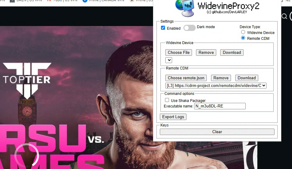

    I've been using this excellent extension for a few months on D#ZN and am#zon, worked great until a couple of weeks ago.
    Now I don't get and keys after starting the video.. I haven't changed anything my end..
    [Attachment 86455 - Click to enlarge]
    The video doesn't start, I don't think it did before but I used to get the keys, now it just hangs and nothing happens.
    Using on FireFox and Chrome.
    Have I missed and update or am I doing something wrong?
    Thanks in advance for any help.
    Sep 2022
    London
    Originally Posted by Obo View Post
    I'd try a local CDM - in the stickies are threads with "ready to use" ones, eg here: https://forum.videohelp.com/threads/413719-Ready-to-use-CDMs-available-here%21 or here https://forum.videohelp.com/threads/417425-Real-Device-L3-Cdms
    Thank you very much - solved the issue

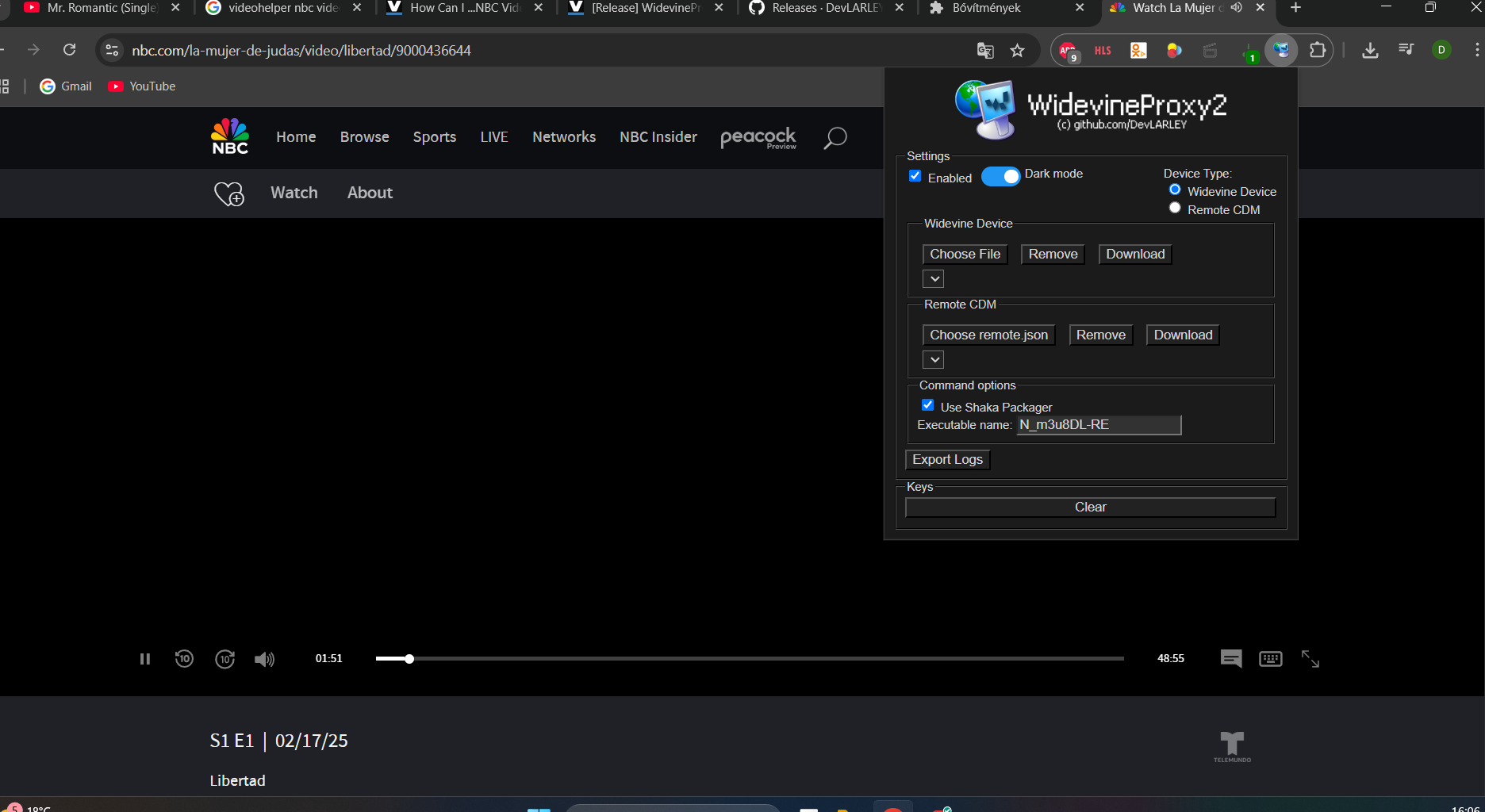

  20. Help me please! Where can I download this program as zip, for chrome extension? I can't find!! And I install to my chrome, after steps? Help me, please! Thx+!+!
  21. https://github.com/DevLARLEY/WidevineProxy2/releases and follow the instructions in the start post.

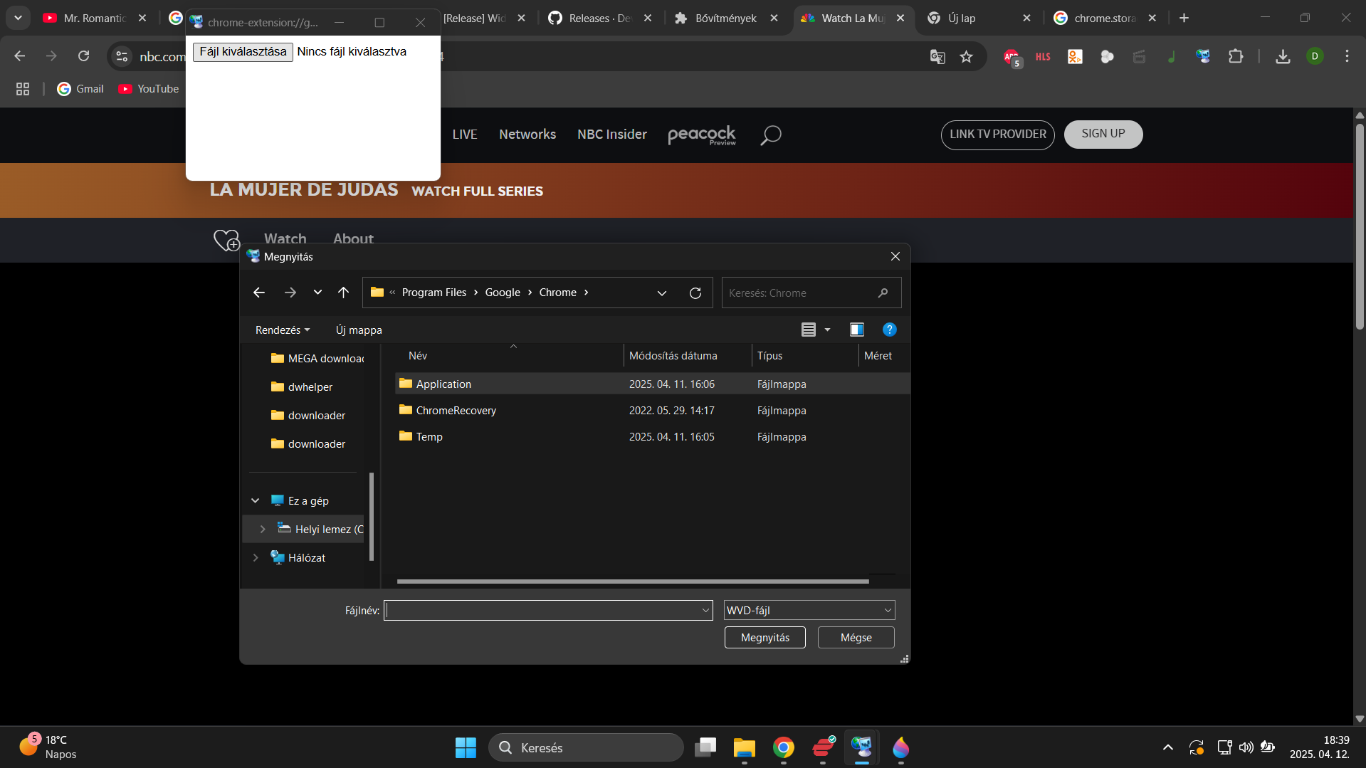

  22. Thanks, but When I click nbc videos, not show nothing Keys! Why? Image
    [Attachment 86572 - Click to enlarge]
  23. You didn't follow the instructions in the start post. You have to choose a CDM (wvd file).

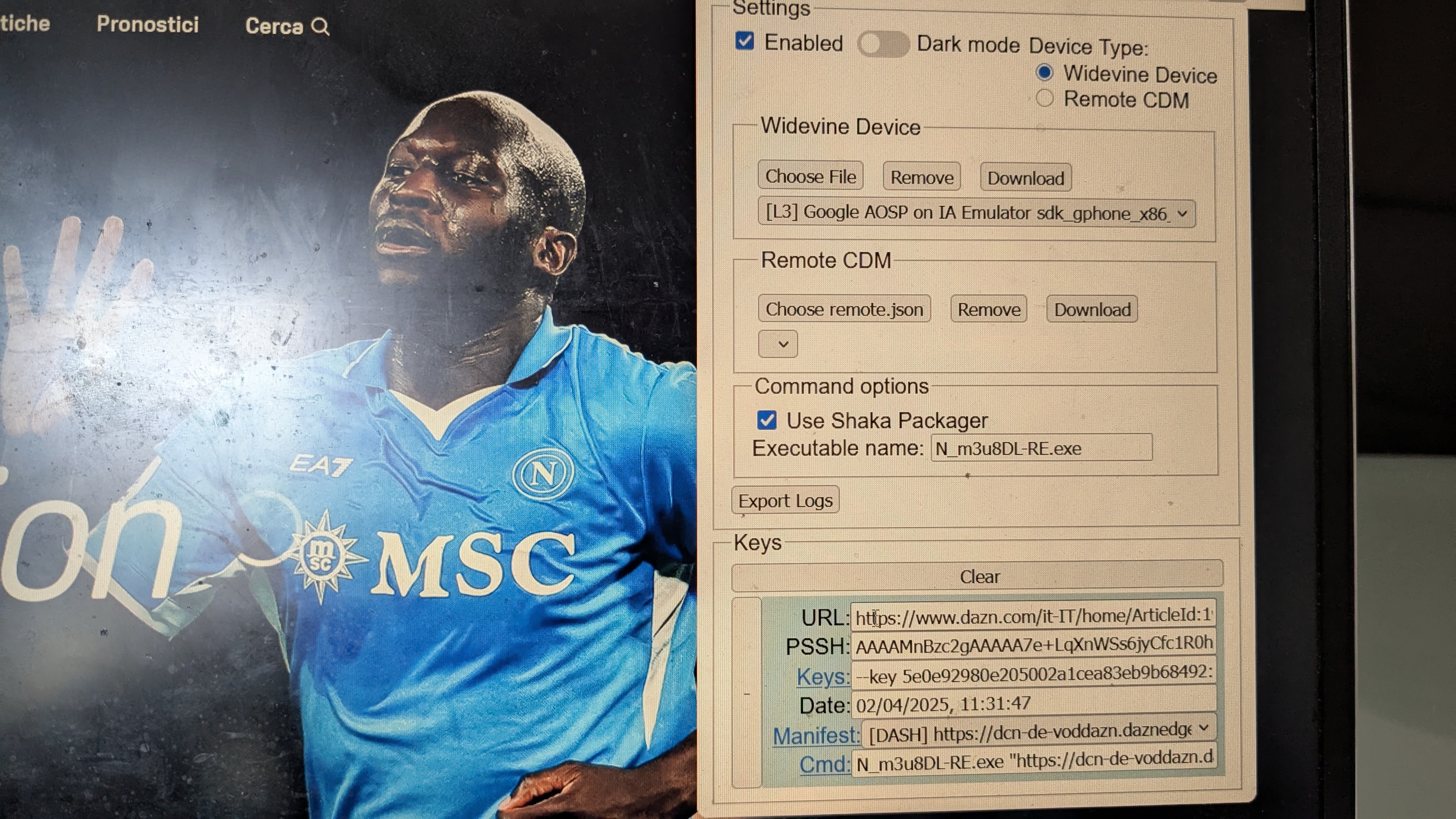

  24. Hi there, I'm attempting to get the keys from a Discovery Plus stream. I'm using my own L3 CDM from an Android phone which is confirmed to work. When I go on the Discovery Plus stream, it fetches two key pairs but when I attempt to play the stream using N_m3u8DL-RE, I am unsuccessful as the key pairs are wrong. Any ideas what could be causing the addon to fetch the wrong keys? Thanks.
  25. Image
    [Attachment 86574 - Click to enlarge]
    Can you help me, please? Sorry but I can'"t find nothing files, what's this? chrome.storage.sync
    And what the Widevine Device file???
    Setup
    + Once installed, open the extension, click `Choose File` and select your Widevine Device file.
    + The files are saved in the extension's `chrome.storage.sync` storage and will be synchronized across any browsers into which the user is signed in with their Google account.
    + Due to the sync storage limit of 100KB, the maximum amount of installable of devices at the same time is ~30.
    + Check `Enabled` to activate the message interception and you're done.
