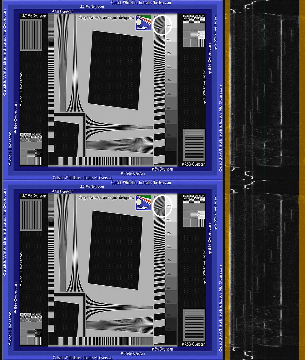

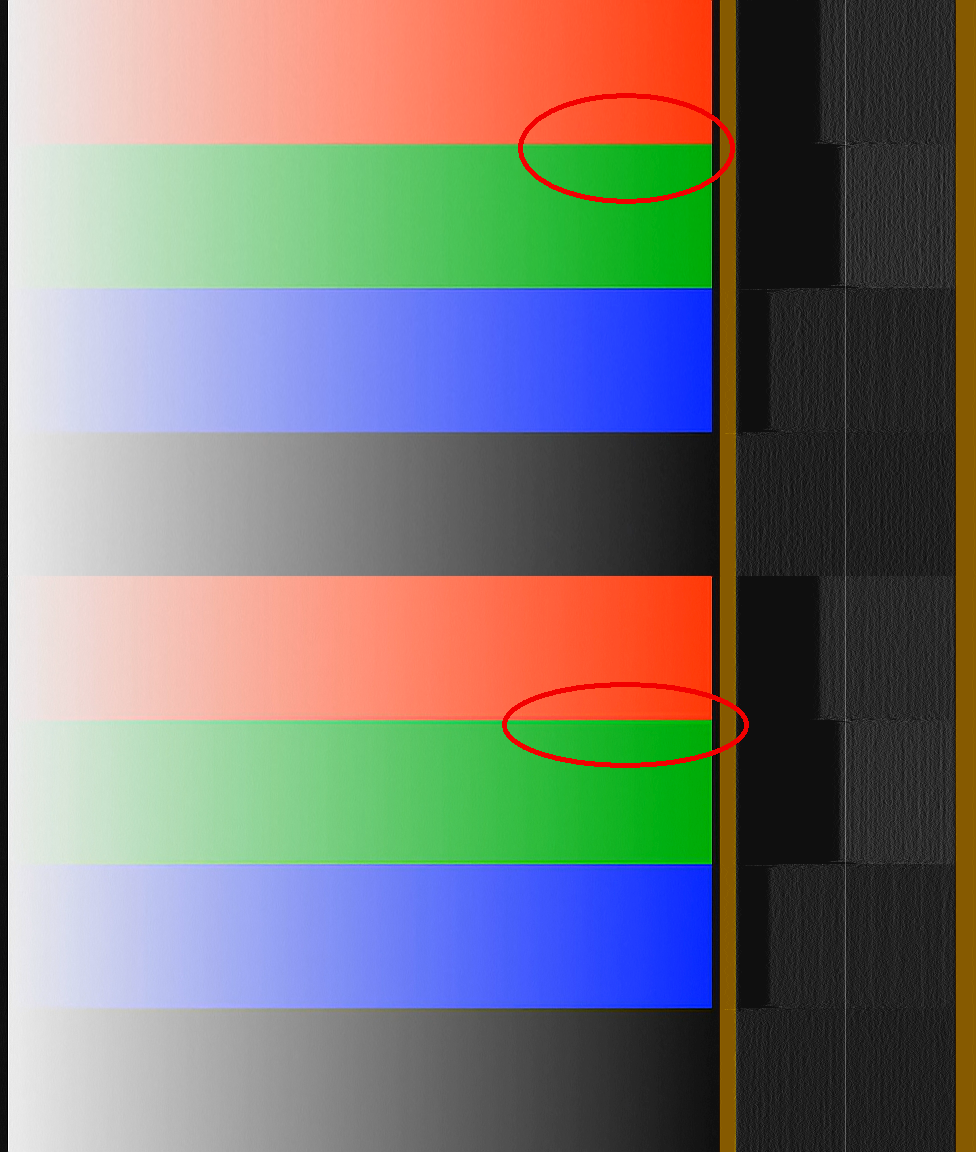

    The second screenshot also shows how QTGMC at 8 bits is more likely to go beyond the 16-235 range.
    Aug 2018
    Wrocław
    xx
  10. Without knowing what scripts created those screenshots, they do not really say much.
    Both images in your second screenshots violate 16-235,...
  11. In your second example it's the white text which exceeds 235. It should theoretically be at 255 exact (sRGB 255,255,255) in 8 bit realm or YCbCr(255,128,128) in YUV for sRGB matrix.
  12. You can put ConvertBits(8, dither=-1) at the end of the script - that's probably the best way to convert to 8 bits
    Unless any dithering was added beforehand, this will add banding to banding prone areas,....
    Sample examples from the net. You can make your own, the effect should be similar.
    In the second example both exceed, but with 8 bits even more.
    Aug 2018
    Wrocław
    I meant rather the range 0-16. After zooming in you can see that at 8 bits the overshoot is stronger.

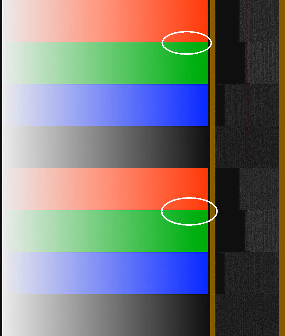

    That file is progressive,... why would you apply QTGMC to that?
    My mistake. But what does it matter how it was labeled if every frame will be the same anyway?
    When marked as interlace:
  19. No script, nothing to reproduce,... you didn't read what I wrote,..
    => I give up on this thread, I wrote my piece and leave in peace.

    You just don't accept that 10, 16, or 32-bit processing is more accurate.
    https://files.fm/u/zz7cys82h6
