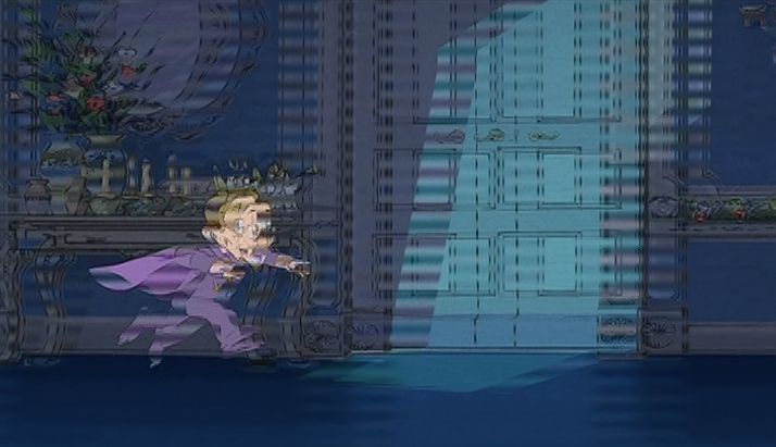

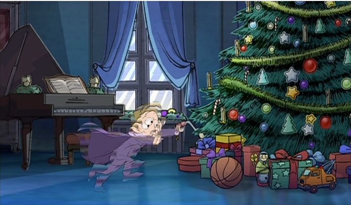

    I'm trying to deinterlace a video ,but I'm a bit confused. The video is a movie I ripped from dvd. When I played it on my laptop, I saw that it was interlaced. So, in VLC, I turned on deinterlacing and Blend mode. This fixed it just about perfectly. But when I put the video on my desktop computer, it was of course interlaced. So I did just what I did on my laptop. I turned on deinterlace in VLC and blend mode....and while that fixed the black horizontal lines that come with interlaced video, there is now this weird...banding when objects in the movie are moving up and down. This is what it looks like...
    I know that this can happen when you pause a video even if it was deinterlaced...I think. I'm not too knowlegable on this subject. All I know is that when the video is moving, I still notice this.

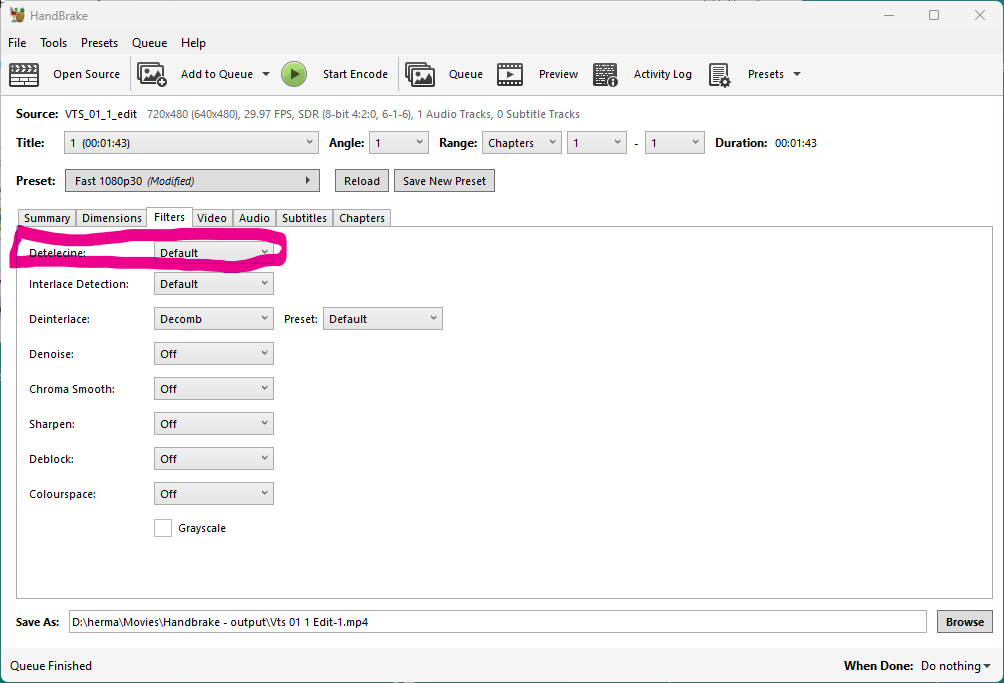

    Can anything be done ? Could I deinterlace it through Handbrake or something ?

    the pictures I posted IS with deinterlace on and Yadif 2X. And I don't know how to post a few seconds of the video. I wish there was some way I could just send you the whole movie....

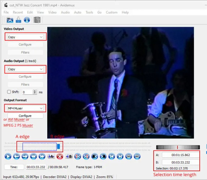

    Make sure you use Video>Copy and Audio>Copy when you give us a snippet. The new snipped file shouldn't look any different to the original.
    AVIDemux should look like this (Output format "MP4 Muxer"):

    - Once we've sorted out the interlacing/telecine, you can then use Handbrake to create an MP4 to your liking.

    I have Handbrake. How do I TVTC the file in Handbrake ?
    Think about this. Once bread becomes toast, you can't make it back into bread.
  25. Member
    Mar 2008
    Set it up as you normally would.
    ON the filters tab select "detelecine" / default.
    ON the video tab set FPS to 23.976/constant
  26. Member
    Dec 2006
    good lord, I'm dense. that sounds extremely easy. You'd think that someone my age would have figured this all out by now...
    I don't need to use that code you posted, do I ? I can just detelecine like you said ?

    Using HB with it's built-in filters is an alternative to using the Avisynth code.
  28. Member
    Dec 2006
    I've got it processing right now with the suggestions you just gave me. I'll let you know how it turns out.
    Update. The movie seems to play perfectly fine now. It worked. I opened it in VLC with deinterlace turned off and it looks great. Thanks for all the help. I don't think I would have ever been able to figure this out on my own...

    Starting from scratch:
    - It sounds like the DVD isn't copy-protected. Copy the VIDEO_TS folder on the DVD to your hard drive (I think you have already done that)
    - Convert the VOBs in that VIDEO_TS folder into a single MPEG. Use the process with AVIDemux I describe on my website here.
    - Make a snippet of around 30 seconds for us to analyse, using the procedure here.
    - Attach that snippet here. I suspect the experts will be able to guide you to a pristine result.
