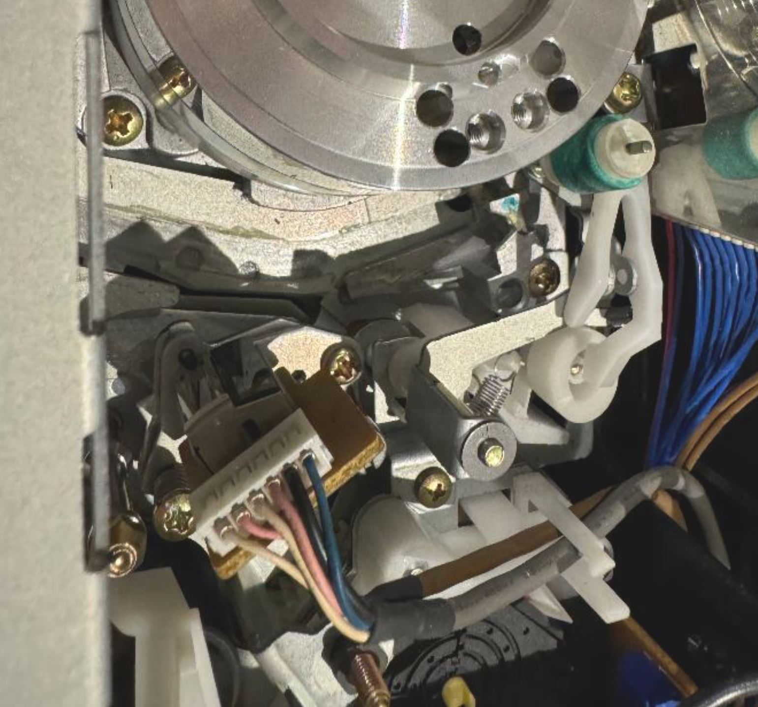

  12. Image
    [Attachment 82928 - Click to enlarge]
    Originally Posted by timtape View Post
    It might help if can take and upload a photo of the transport section of your Hitachi VCR with the camera looking directly down at it. We can probably attach an arrow to the photo pointing out the audio/control head.
    I did the photos

    Here:
    Aug 2018
    Wrocław
    And remove the whole lever. That green cleaner definitely doesn't clean the head anymore.

    Here:
    Thanks very much. How to clean it?
  16. Thanks. Is any way to clean audio head with cotton stick using alkohol?

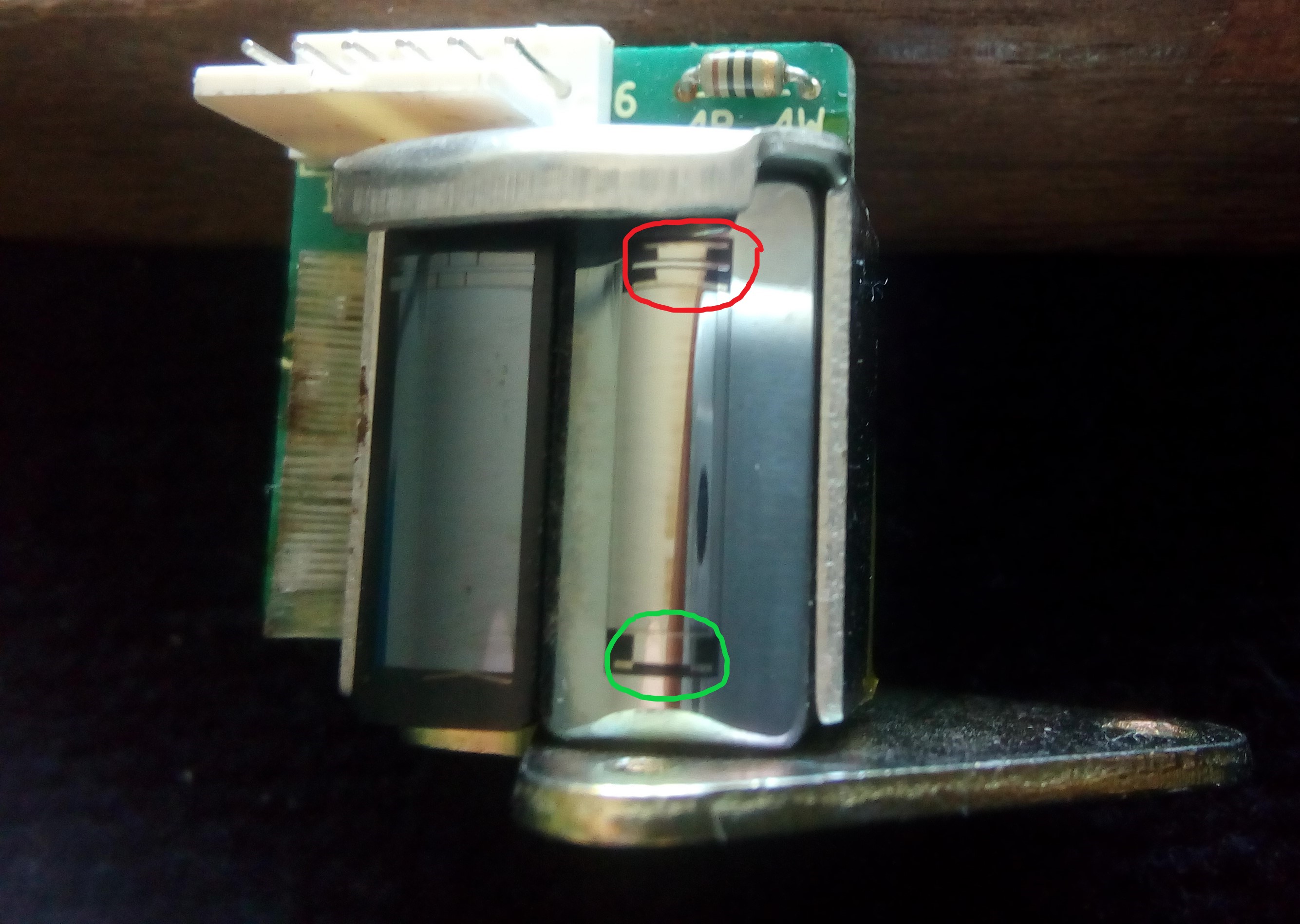

    Here's a marked photo of an audio/control head out of the VCR. The audio erase head is the dark coloured one on the left. The entire faces should be cleaned but the actual operative sections are circled. The red area at the top is for audio, the green for the control track. (The audio head in this photo happens to be stereo while your is probably mono. So they look a little different but the cleaning is the same). They need to be spotlessly clean. It's good to see the face clearly enough to see when it's dirty and when it's clean. If yours has failed because of dirt, you should be able to see that dirt on the head face. That probably requires viewing with a small inspection mirror in a good light. Some inspection mirrors are magnified which also helps. Some heads like this one pictured have a metal overhang at the top making it harder to see. Again the inspection mirror allows us to see under that overhang.
    Be gentle though. The metal is quite soft and can be easily scratched. Dont use anything abrasive or harsh solvents. If it means using less pressure against the head but taking longer to remove the dirt, so be it. Obviously as mentioned, the green tyre should be removed to avoid it depositing more muck. Be patient. Take your time.
