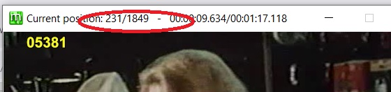

  8. Thanks, poison, but I've just had a eureka moment. I use MeGUI and if the entire movie is selected then finding the bad frames is difficult due to lack of space in the small preview screen. So I select a few scenes at a time making it easier to find the frames to delete. With my first go at using DeleteFrame I assumed it would delete the original frame number but you put me right on that. But - eureka moment - I can still use DeleteFrame by using the position number rather than the frame number.

  9. When you use Trim, it becomes a new clip, with new framenumbers. Another way is to use ShowFrameNumber again . You can position the 2nd instance somewhere else e.g. ShowFramenumber(x=60, y=60) . Or change the color. When you're done, you can comment out all the ShowFrameNumber entries
