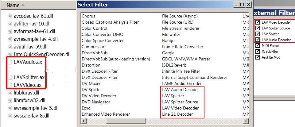

@ rocketman122,
This is what my MPC-HC has
The left red square is what the Program folder/MPC-HC/LAVFilters has in it.
The center red square is the MPC-HC/Options/Externel Filters/Add Filter/Select Filter has.
The right red square his from the same pop up as in post#4 for easier comparison.
The 3 not in the red square are extras I added for playing MIDI format & some subtitles
It seems you don't need more than the audio to play the files you want to play.
So if you ever run into a problem file you may want to add the others.
[Attachment 82844 - Click to enlarge]

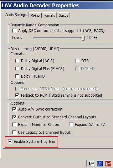

I have my LAV filters set to "Enable System Tray Icon".
This only shows when a player that has the LAV filters in playing a file.
The icon can be double clicked to make settings in that filter.
[Attachment 82846 - Click to enlarge]Last edited by cholla; 15th Oct 2024 at 12:38.
