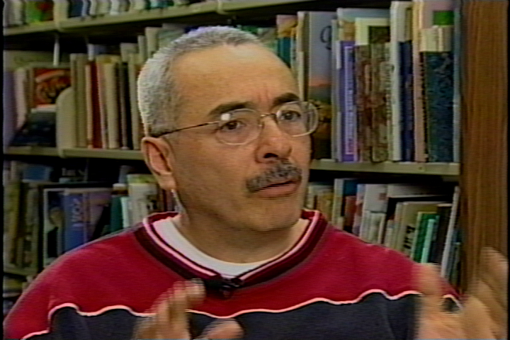

    Is there any specific codec you'd recommend? I tried using UT & Lagarith, but they both produced results where the interlaced video was in a progressive file (screenshot attached.) I could play this back in VLC with Yadif 2x, but it looked very jittery and I assume was deinterlaced using AI.

    Those UT and LAGS video files ARE Interlaced. VLC Player is deinterlacing them and producing that blur. Make sure you've got Deinterlacing ON AND Mode Yadifx2; two separate settings. Note that every time the video ends, the VLC deinterlace settings revert to Auto.
    The jitter and blur is because the deinterlacing is only single-rate. If you have Yadifx2 mode working correctly, the video will be smoother and less blurry because you're getting twice the number of frames for the same length of time.
    A better analysis can be done by opening the file in VDub; the interlacing will be obvious.
    VLC may have been playing the video with the wrong field order. VLC always assumes bottom-field-first when 2x deinterlacing. If the video is top-field-first the fields will be played in the wrong order. You can test this by pausing the video in VLC then using the e key to step field-by-field (when Yadif 2x is specified).
    I should've clarified this in my previous post, but I did have deinterlacing on with Yadif 2x
