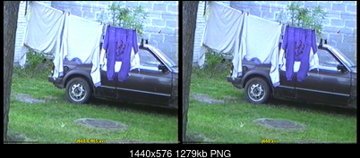

    That J672 image is not good. It has really aggressive false (over)sharpening. Look at the hard black line on the left side (from our perspective) of the child seat. The world doesn't have black crayon outlines on everything. If you want to sharpen, do it better in Avisynth from the original unmolested video.
    VCR sharpening apart, the J672 image has more details. No sharpening in AviSynth can bring back details that are missing.
  3. Originally Posted by lollo View Post
    Sharpness apart, it looks to me that the details are mainly lost in the brights. Was there a problems with the levels? The colors are also distorted. Snippets of the captured .avi could probably tell more ...
    In white areas yes, but the missing details are in the darker range (the small dark dots between the white matrix of the sweater).
    Yes, it would be interesting to see a sample of the untouched captures.

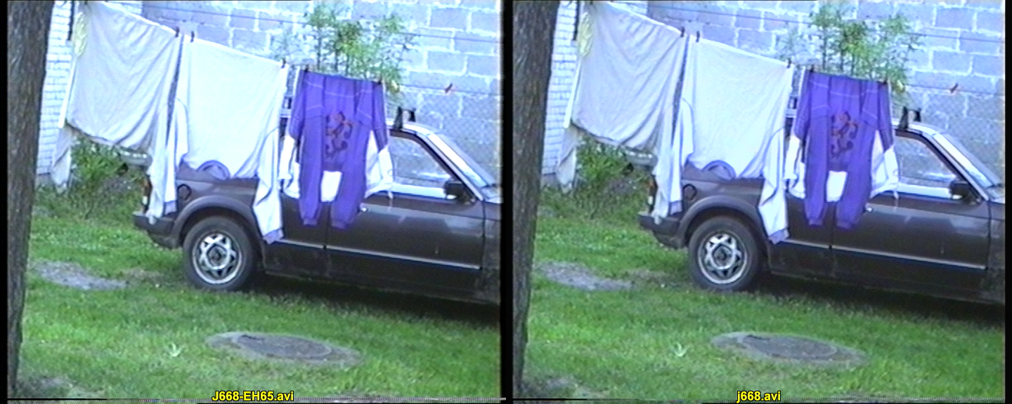

    After playing a few tapes I noticed what you can see in the screenshots below. Why is the image from JVC J672 (composite output) so good compared to Philips VR1100 (JVC S7600)?
    J672 in Edit mode, S7600 (svideo) does not have such a setting, so I can only turn off 3DNR.
    (B.E.S.T turned on on both machines)
    https://imgsli.com/MzA3NzAy

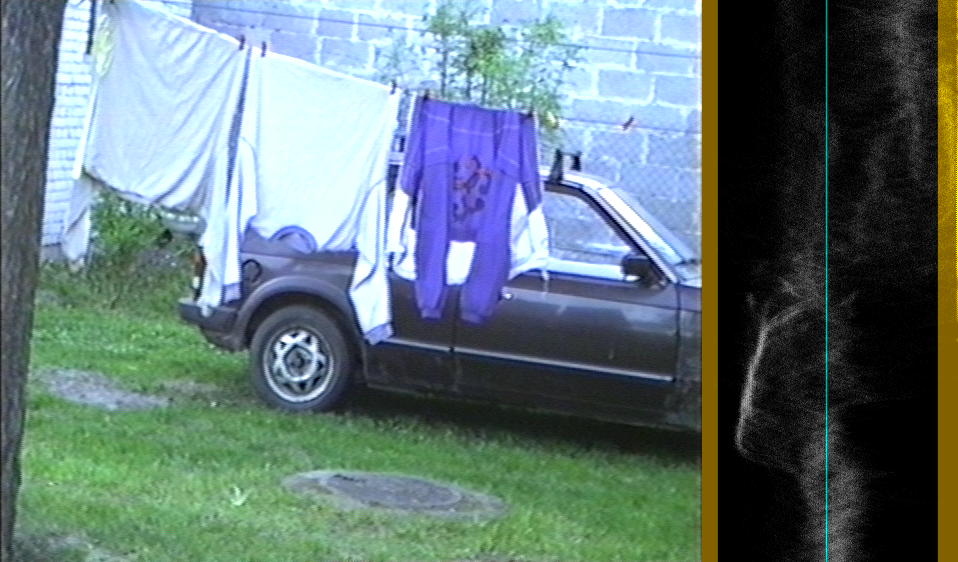

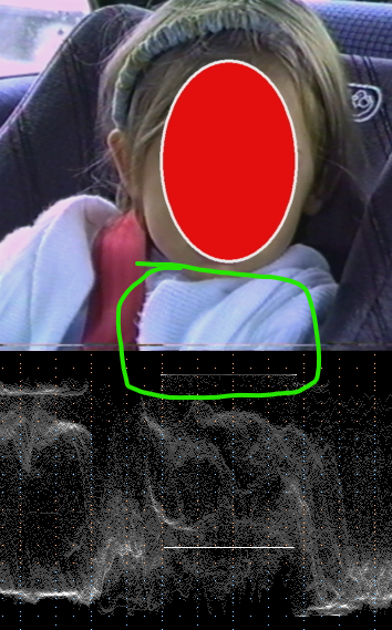

  8. Originally Posted by lollo View Post

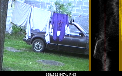

    The luma of the Philips is clipped on the whites. One cannot expect details/fine structures there. (The j672 is not clipped).
    [Attachment 82865 - Click to enlarge]

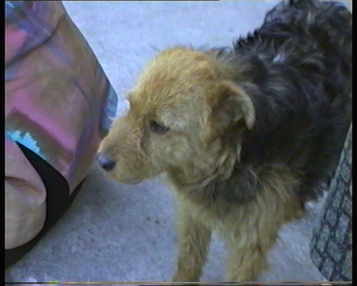

    Nevertheless, I checked it on another video:
    https://pasteboard.co/WxDLQ37d1PkA.png
    https://pasteboard.co/awmnMZeQqJMm.png
    or:
    https://pasteboard.co/TAlT9rkTxywu.png
    https://pasteboard.co/x7cliVY4oqDD.png
  10. Captures & Restoration lollo's Avatar
    Jul 2018
    Italy

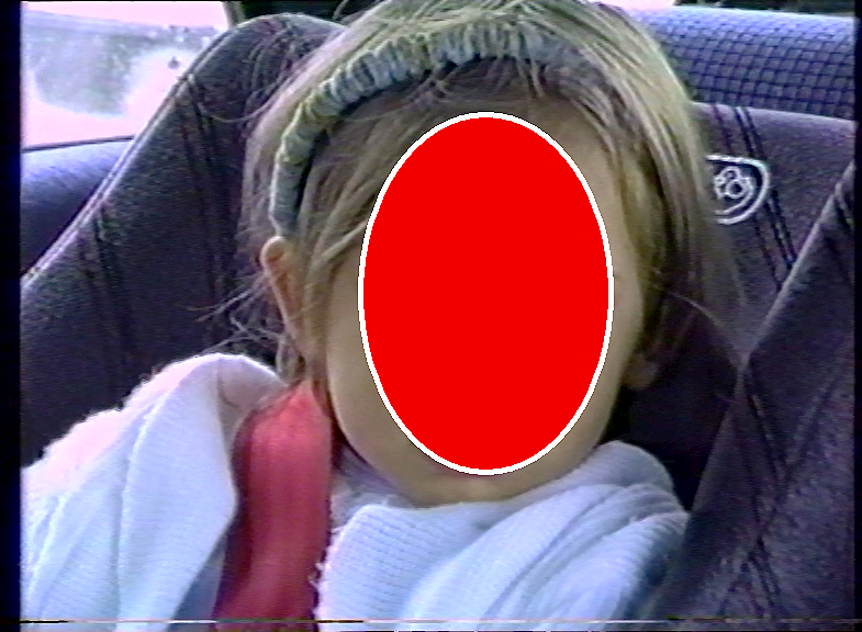

    rgr, I understand that probably because privacy you cannot provide a video sample to better analyze the case, but on my side is difficult to conclude. Maybe Sharc may have found a good explanation about the reason of a less detailed capture. Difficult to say more.

  12. Originally Posted by lordsmurf View Post
    Originally Posted by rgr
    Head wear is possible issue on that Philips deck. That degree of blurring is not typical. However, that low-end JVC is also oversharpening. It's not neutral here.

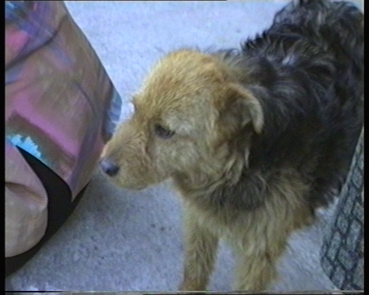

    I have never seen that head wear would blur a picture. I think we are just fooled by the oversharpened j672 picture.
    Attached a quick'n dirty processing of the Philips picture. If one could have avoided the brights clipping the pictures would probably look much the same at the end.
    @rgr: I don't know where the hard clipping at y=235 for the Philips comes from. Maybe it's your SW/editor, capture device, VCR player, passthrough device (if any). Brights clipping is an issue, see the .mpg attachement here for various VCRs (see the white text in the headline).
    https://forum.videohelp.com/threads/414871-Best-VCR-opinion#post2738885
    You could try to adjust the proc-amp settings and/or disable any "limiter" function in your workflow. Worst case you would have to insert an attenuator pad in the analog signal path. Depending where the clipping happens it may be a lost case though.
    If you can't disable the oversharpening of the j672 I would probably spend little time trying to improve the levels setup of the Philips and do the rest in post.
    Philips with little post processing (can't really fix the baked-in brights clipping of course):

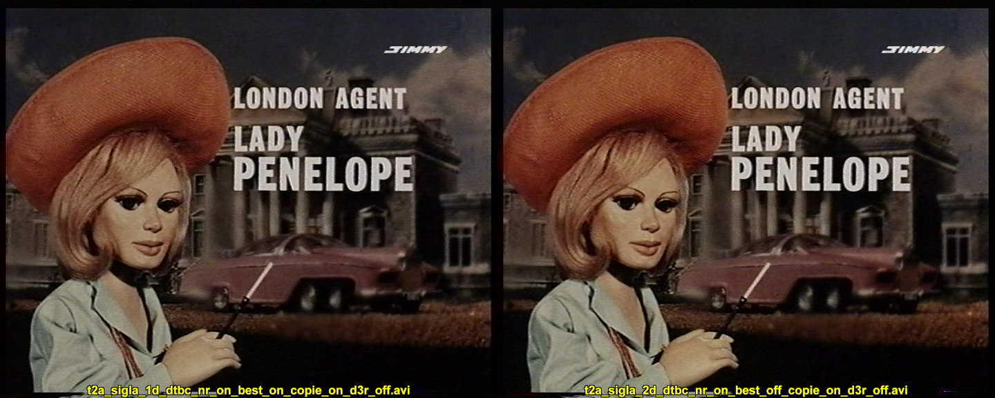

  14. It's normal that the VR1100 capture will look a little less detailed than the J672 one since the VR1100 one is with the auto setting which has noise reduction active (+ the DNR stuff from the TBC/DNR unit) while the J672 one is in edit mode which turns off most or all of the noise reduction and filtering. If you put the J672 into the standard picture mode it would probably also look more blurry.
    The B.E.S.T setting (called D.S.P.C on the philips) will also impact things if it's enabled as it tweaks the deemphasis/eq of the image a little based on some heuristics afaik so it could blur/sharpen things a little - I don't think it does anything in EDIT mode even though it shows up but not entirely sure.
    I agree. But about J672 into the standard picture mode it may be a bit better than VR1100 (NR being different)

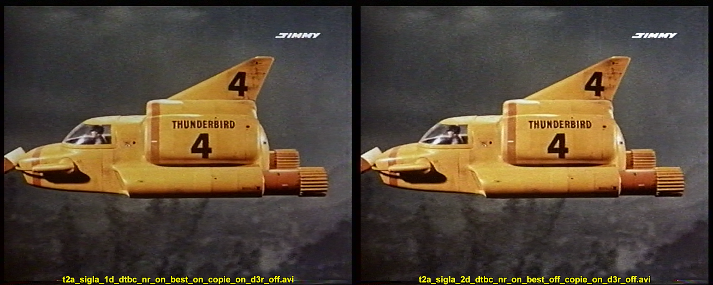

    I confirm that B.E.S.T. setting has no impact in edit mode about details, blur, sharpen. Here an example with S9500 device:

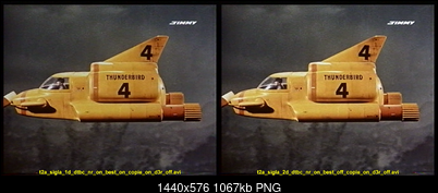

    frame 420 comparison
    with image slider: https://imgsli.com/MzA4NDg5

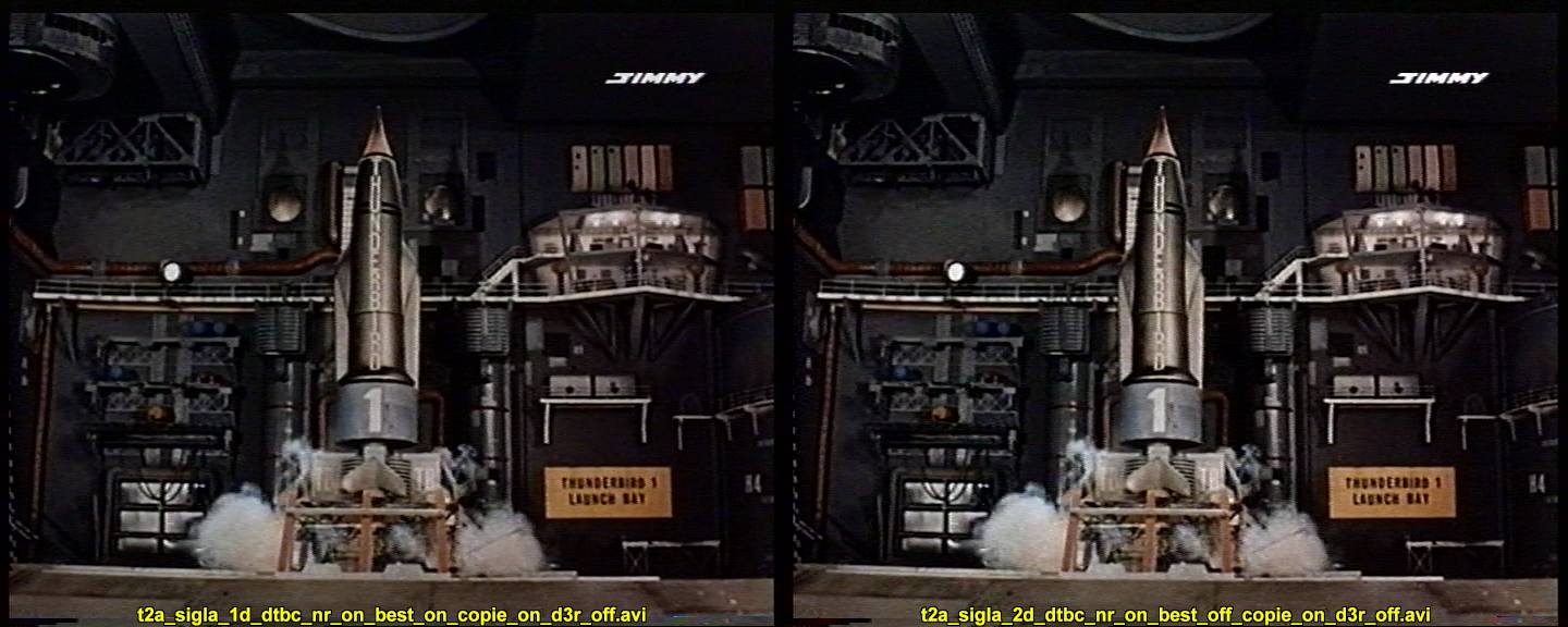

    frame 560 comparison
    with image slider: https://imgsli.com/MzA4NDkw
    frame 2020 comparison
    with image slider: https://imgsli.com/MzA4NDkx

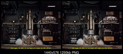

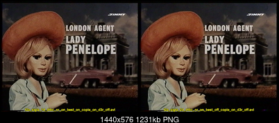

    I thought i might add my results after looking at rgr HR-J672 and Philips V1100. I used composite HR-J668 and s-video HR-S7500, both PAL and in edit mode captured with hauppauge live 2 with DMR-ES10 as passthrough device. I usually dont like results from S7500, it seems to blur more details compared to J668.
    https://imgsli.com/MzA4MzA0/2/3
    With a quick check the 2 captures look quite similar to me. A small advantage to the J668 in the details of the first shirt hanging on the rope and of the grid in the background.
    https://imgsli.com/MzA4NTQx

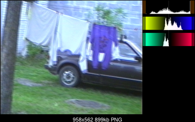

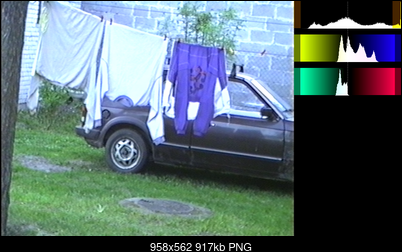

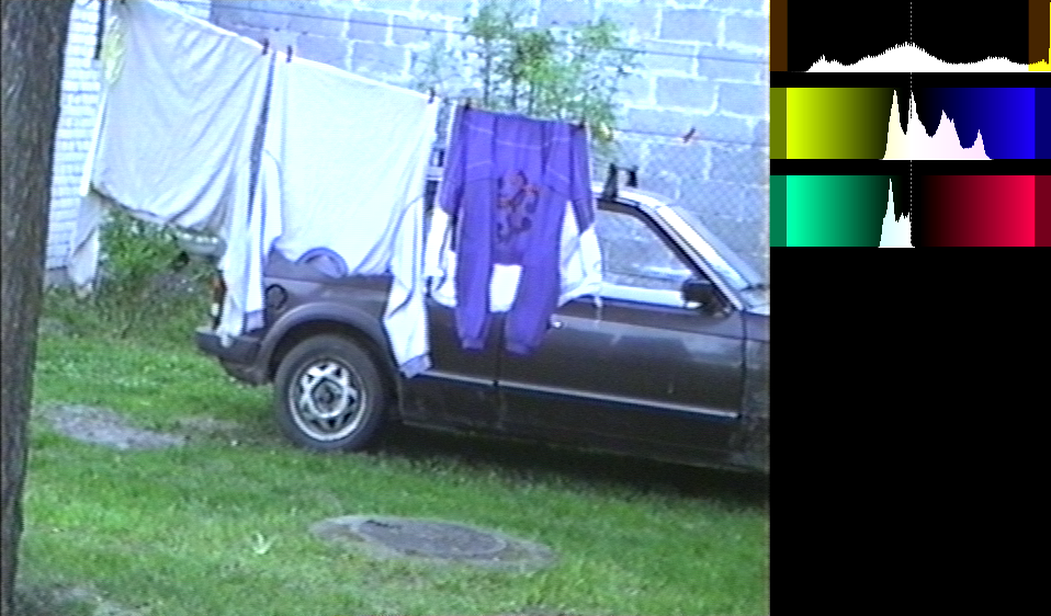

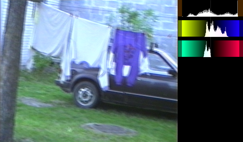

    both have some accumulation on the whites < 235, not capture fault but camera/tape

    Interleaving the 2 versions one can see that
    - the brights clipping is on the source (tape, camera, or passthrough device if in use)
    - the s7500 is slightly darker
    - the j668 pushes the brights even harder towards clipped Y=234 ("a bit hot"). See for example around 05:42 and 07:40 in the attachment.
    - one can see the dotcrawl of the composite j668 at the bottom in the head switching area, see around 03:44 for example. The useful picture is mostly fine though.
    Clipping in J668 capture is my fault. I didn’t notice it at the start of the tape and failed to adjust it precisely.
    Colors also seem unnaturally on the S7500.
    I'm not seeing that at all. Colors are fairly identical. If anything, the HR-J668 luma is a bit hot.
    In the J668 screenshot the surface looks concrete. In the S7500 screenshot it has more of a marble color.
    I checked my captures again and it wasn't my fault indeed. It seems like J668 clipped brightes here a little more than S7500. I checked that again using my slightly different capture made with J668 + DMR-EH65 + Intensity Pro HDMI route (without ES10, EH65 only). Haven't noticed that till now.
    https://imgsli.com/MzA4ODM5/0/1

    For the DMR-EH65 + Intensity Pro HDMI route you are clipping the whites:
    And while there, is interesting to see a comparison of a capture with the standard flow using the Hauppauge USB-Live 2 and the alternative flow where the digitizer is the DMR-EH65 (the alternative flow has not been equalized for brightness), for all people wondering how the 2 techniques perform (a sligth advantage for the standard approach)
    with image slider https://imgsli.com/MzA4ODY3
    Note that there is an ES10 as passthrough device for both capture, if i read correctly

    So the "standard" workflow suffers from the insertion of an additional device (having its drawbacks). One more "advantage" point to the "standard" workflow, then. For sure the right comparison would be using the proper player (VCR with TBC) since the beginning in both methods, to have a fair judgement.
    I'm still not sure why its worse while i can adjust brightness later and bring back clipped whites unlike in Hauppauge where it's not possible to do so after capturing tapes.
    Not sure I understand your statement, but you will not be able to bring back what is clipped during capture in post processing, whatever device does the A/D conversion.

    I meant that if i try to adjust brightness and contrast in e.g vdub i can recover details in whites that look blown (not in the range?).
    I did that to this EH65 sample below.

    Well, using the ES-10 is just plugging in an extra device and doing an extra D/A conversion, right? Using the EH65 (and capturing from HDMI) is just one A/D conversion.
    In your screenshot I can see that the data is not lost, it is just in the range 235-255, right?
    However, in the example I pasted in post #39 I see no such problems.
