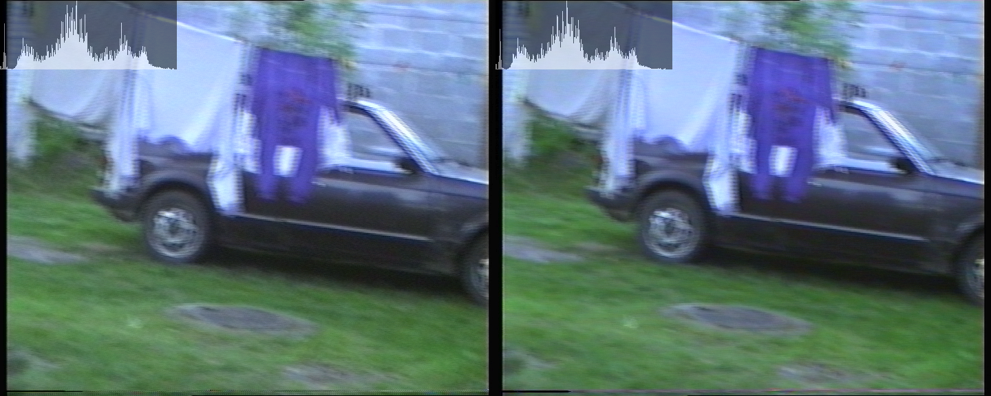

    I loaded both files from post #46 into VirtualDub and honestly I can't see any white color clipping (VirtualDub set to Rec601, limited)

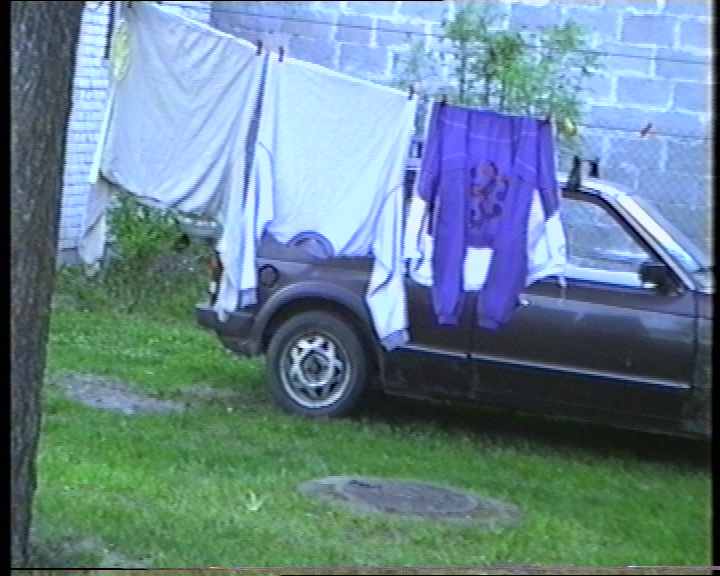

    I did that to this EH65 sample below.
    Not what has been clipped during capture. In general, when you see a spike a Y = 255 it means that details are lost, and not recoverable. You can brig back data that are in the 235-255 range and that are clipped by the player or by the software or by the processing. For example if you need a RGB conversion somehow, you shrink the Y > 235 and well position the details that otherwise will be missed.
    Originally Posted by rgr View Post
    Well, using the ES-10 is just plugging in an extra device and doing an extra D/A conversion, right? Using the EH65 (and capturing from HDMI) is just one A/D conversion.
    Yes, see my answer to Krazern. In general, if the DVD recorder acting as capture device ALSO features TBC correction, you have everything in one device, Then you can compare with the standard workflow using a VCR with TBC and a classic capture card. If you need to add a stabilization device as Krazern is doing in the standard workflow, the comparison is somehow unfair.
    In your screenshot I can see that the data is not lost, it is just in the range 235-255, right?
    Data in the reange 235-255 can be easily recovered. But when you have a spike at 255 or a little bit lower, you already lost details, and these cannot be recovered.

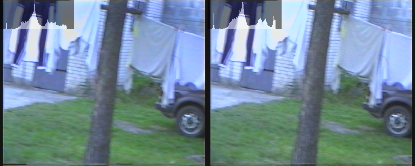

    If you setp some frame forward you will see the accumulation of the whites: hyst.mp4
    If you setp some frame forward you will see the accumulation of the whites: Image
    [Attachment 82925 - Click to enlarge]
    OK, now I see.
    Apparently the S7500 reacts faster to brightness jumps, the J668 does it slower. But is it worse? Is it better to see 1% more or better to see 99% clearer?
    (this time the histogram is set to full range and s7500 on the left)

  6. Originally Posted by Krazern View Post
    ... I meant that if i try to adjust brightness and contrast in e.g vdub i can recover details in whites that look blown (not in the range?).
    No, you didn't really recover much. The clipped luma has just been shifted down to Y=216, but is still clipped as you can see from the solid lines at Y=216. The clipping is not catastrophic, buts it's there, killing details and gradients in that area.
    Edit: and the colors are too bluish. But that's a different story. Something for post processing. In RGB it's mainly the blue which gets clipped.
    Edit2: Attachment 2 added, same as above but correctly scaled.

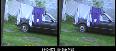

    In BMD media express i just capture the HDMI signal without changing it. I adjust it later in post processing

    You reversed the images (on the left is the E65). In the standard method there are (marginally) more details in the white areas.

    I didn't, you can see it by the head switching line because HDMI route captures whole frame here

    You did it, the naming on the top does not match. BTW the extra lines capture by the HDMI route are not that good anyhow.

    Check the bottom right corner, the switching line is longer on EH65 capture.

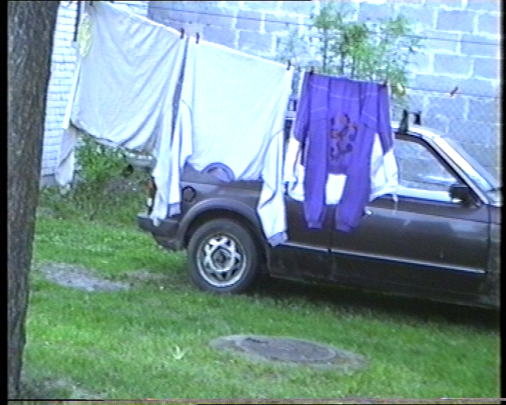

    I uploaded edited EH65 single frame to comparsion .
    Here are the images.

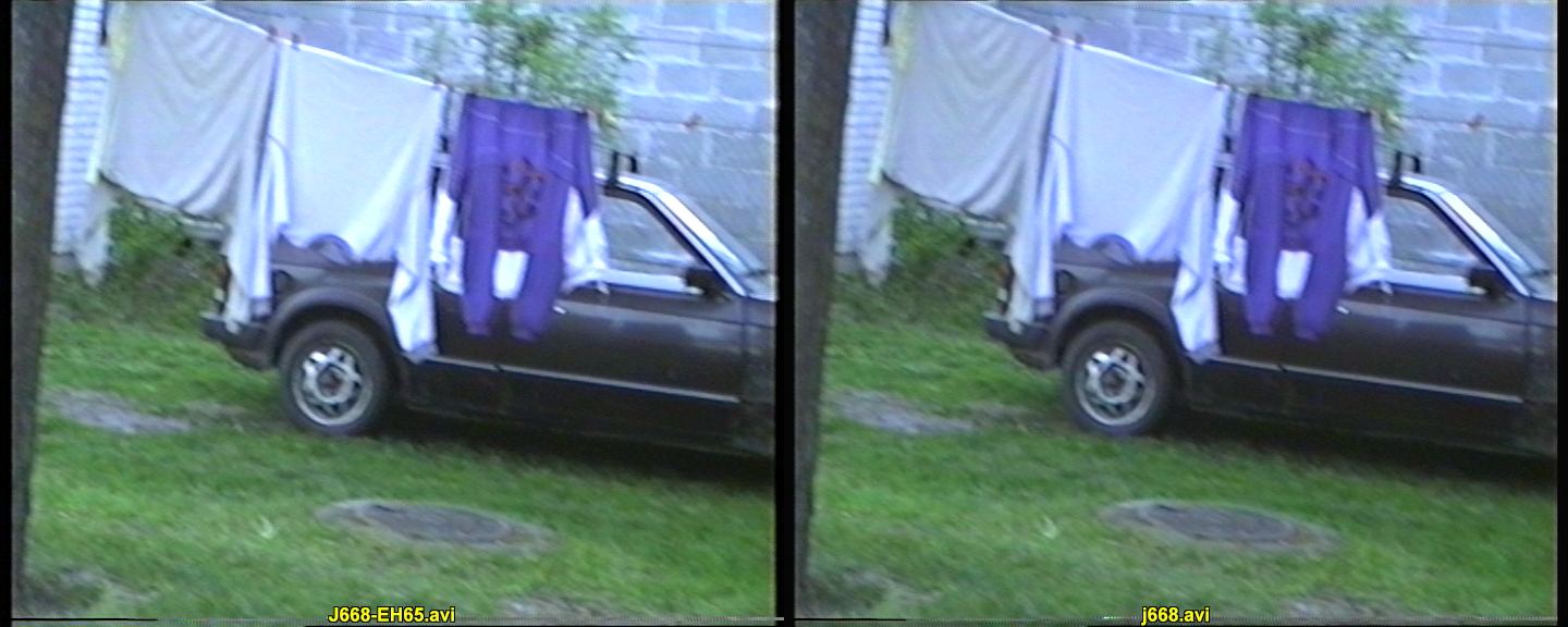

    Last attempt. From your sources j668.avi (Hauppauge USB-Live 2) and J668-EH65.avi (DMR-EH65):
    [Attachment 82946 - Click to enlarge]
    It may mean something, but not necessarily. Below is the same frame from the same equipment (here: Panasonic NV-HD630, I generally think that Panasonics give a more natural image than JVCs). The only difference -- the frame on the right is from the second copy.

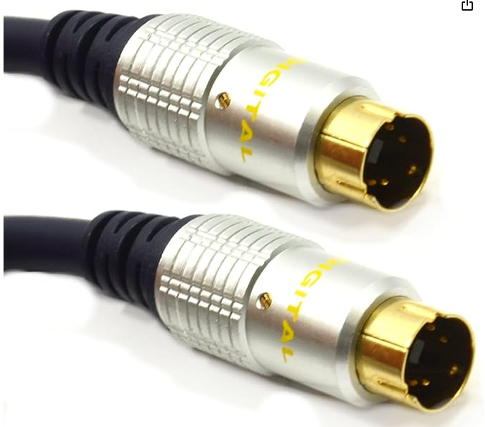

    Now, as I have ordered my "I-O Data GV-USB2" and my "JVC HR-S9500EH", I'm wondering how to connect both.
    As both have "female" S-Video and RCA connectors, do I need to get a male-to-male adapter so I can connect them?
  25. Originally Posted by Name View Post
    Alright, understood.
    Yes, an S-video cable like this:

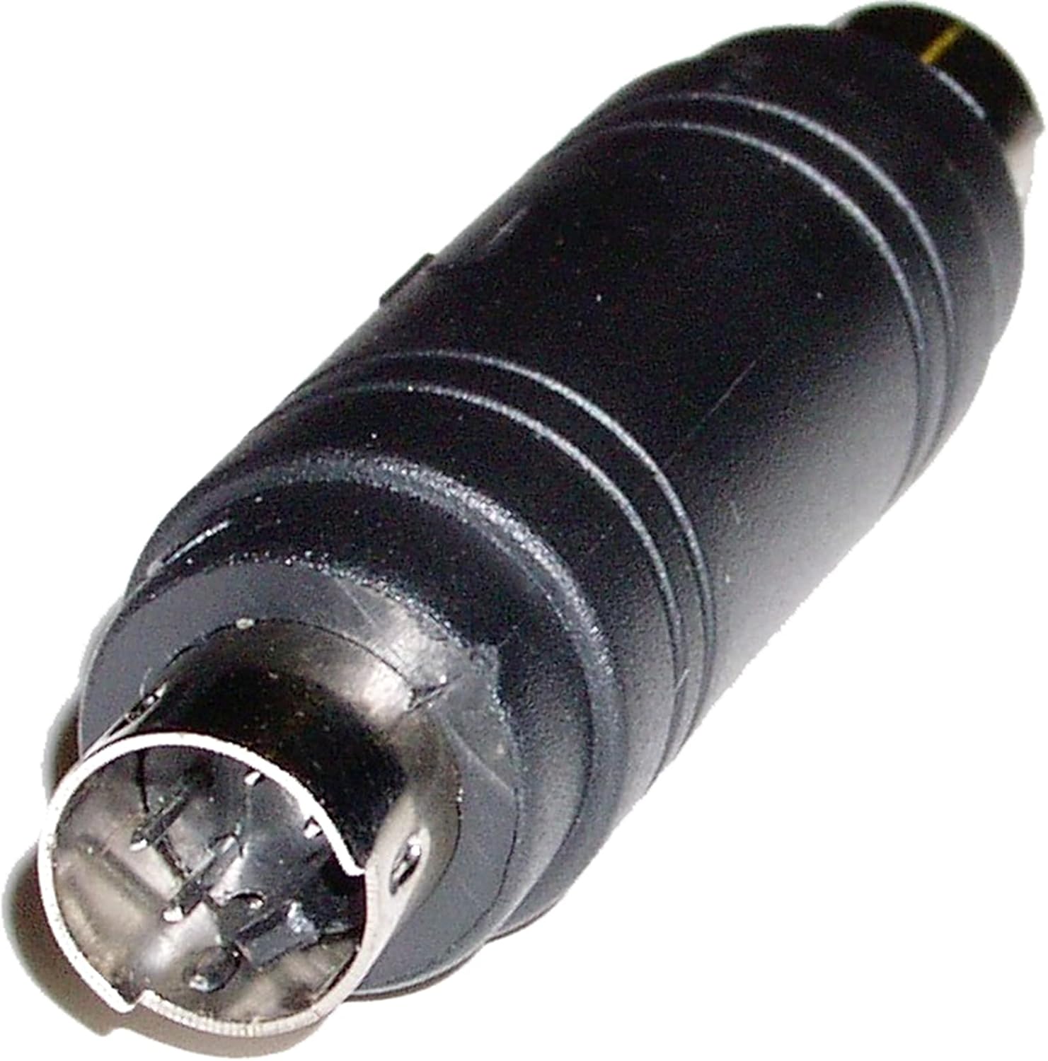

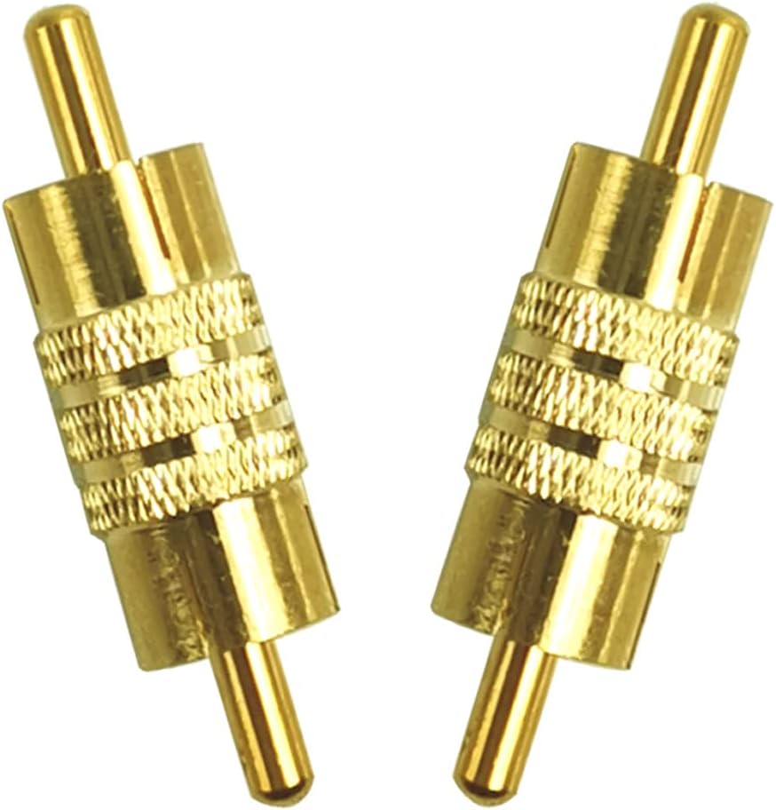

  27. To keep the cables short, can I also just use these connectors:
    BeMatik - Adaptador S-VHS MiniDIN4-M/M:
    [Attachment 83792 - Click to enlarge]
    RCA Male to Male, RCA Connector Adapter:
    [Attachment 83793 - Click to enlarge]
    it will be too short, just get a cable under 3ft.
  29. Originally Posted by dellsam34 View Post
    If it should be too short one could alternatively extend the USB cable of the GV-USB2 and keep the cables on the analog side short.
