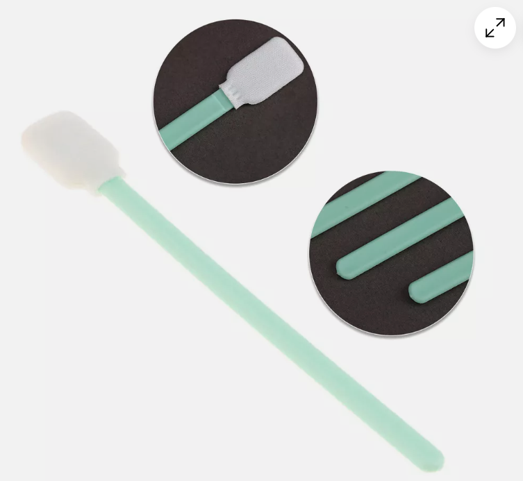

    Reading the Home VCR Repair book it recommends a chamois stick but I don't see them anywhere so are these good as an alternative?
    https://www.ebay.co.uk/itm/194124396419
    [Attachment 82683 - Click to enlarge]
    Edit: Have used paper and 99% iso which I get conflicting advice on.

    I already use 99% isopropyl. Was just the cleaner part needed. Ill check out the MG Chemicals 810D-15 Double Head Chamois Swab @lollo mentioned.
    https://www.amazon.co.uk/MG-Chemicals-Double-Head-Chamois/dp/B008OA7YG6
    Avoid open cel foam, it snags heads.

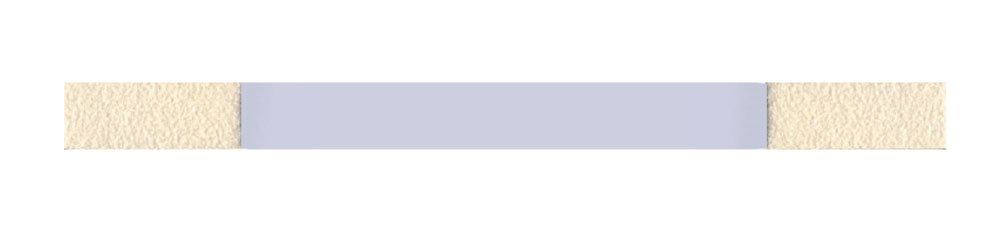

    Good to know. I got these (MG Chemicals 810D-15 Double Head Chamois Swab) in the end
    [Attachment 82735 - Click to enlarge]
