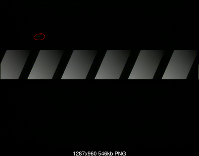

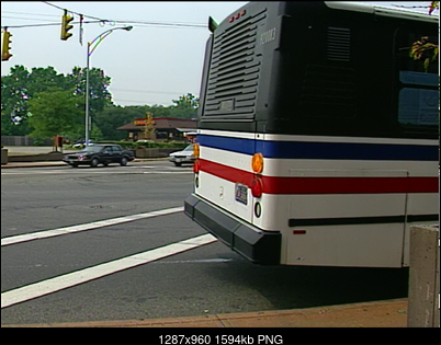

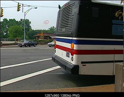

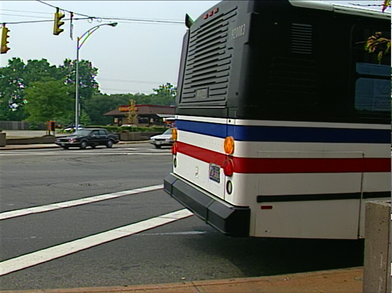

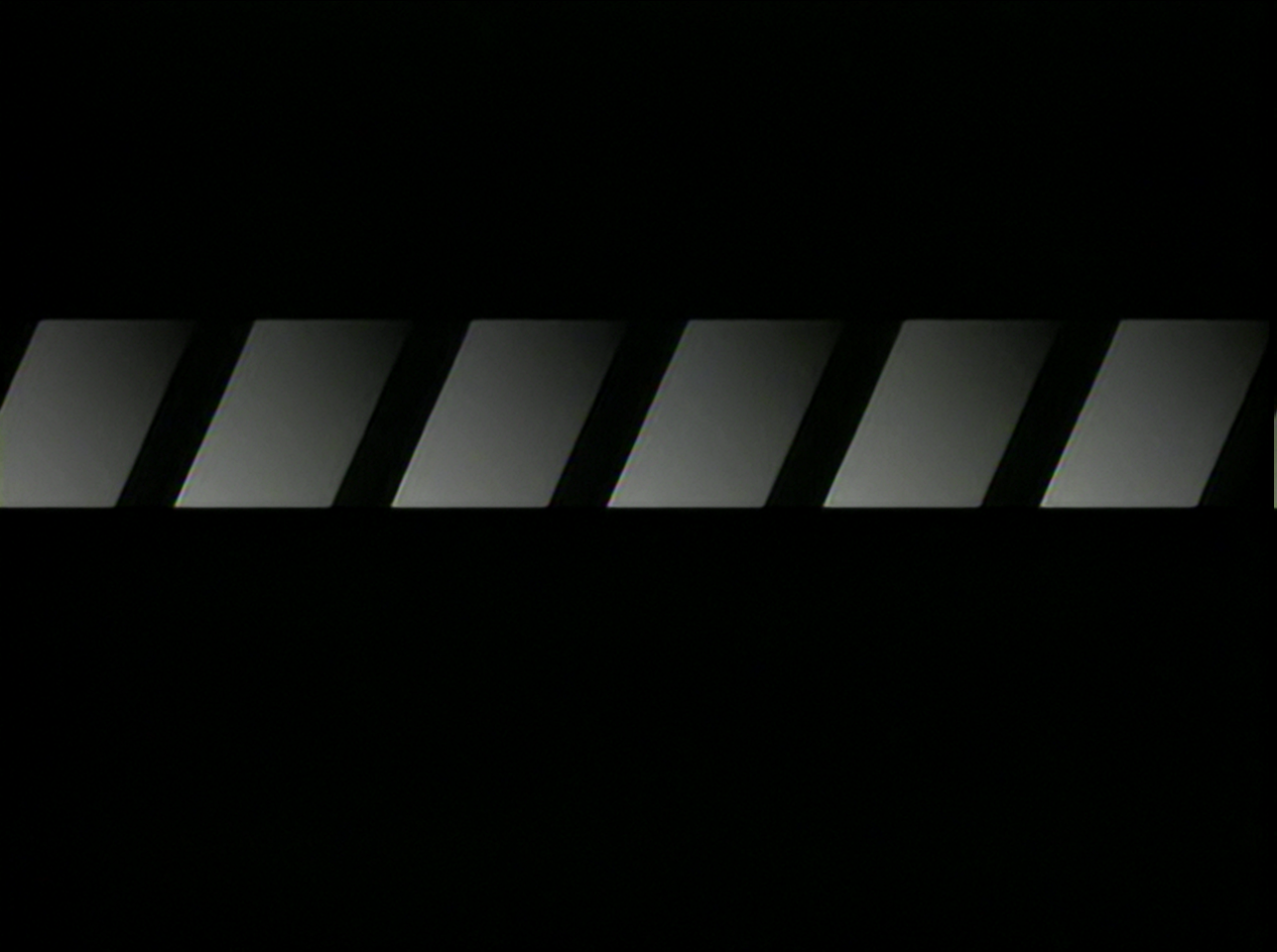

    i'm trying to use the median filter to stack three captures of a betacam tape. the preview in avspmod looks fine, but the encoded video has visual glitches and i don't know why. i'm only getting these on the encoded video. the glitches seem to show up at random, and every encode has different glitches.
    raw:
    encode:

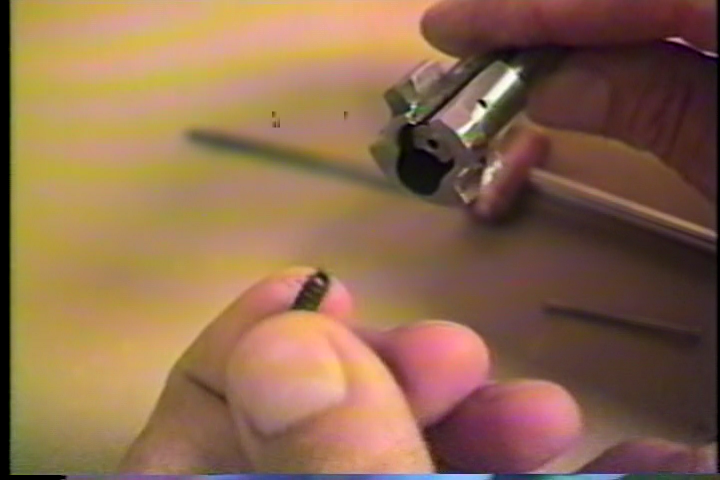

    sorry for the months late response. i'm having this issue yet again and i'm not sure how to fix it.

    i tired encoding to both utvideo and prores in ffmpeg and they both have the same issue. but my issue happens randomly at random points, so i can't just save a segment. every encode has unique errors.

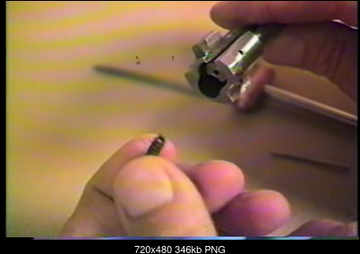

    i tried using another debander, gradfun3, but it doesn't work at all.
