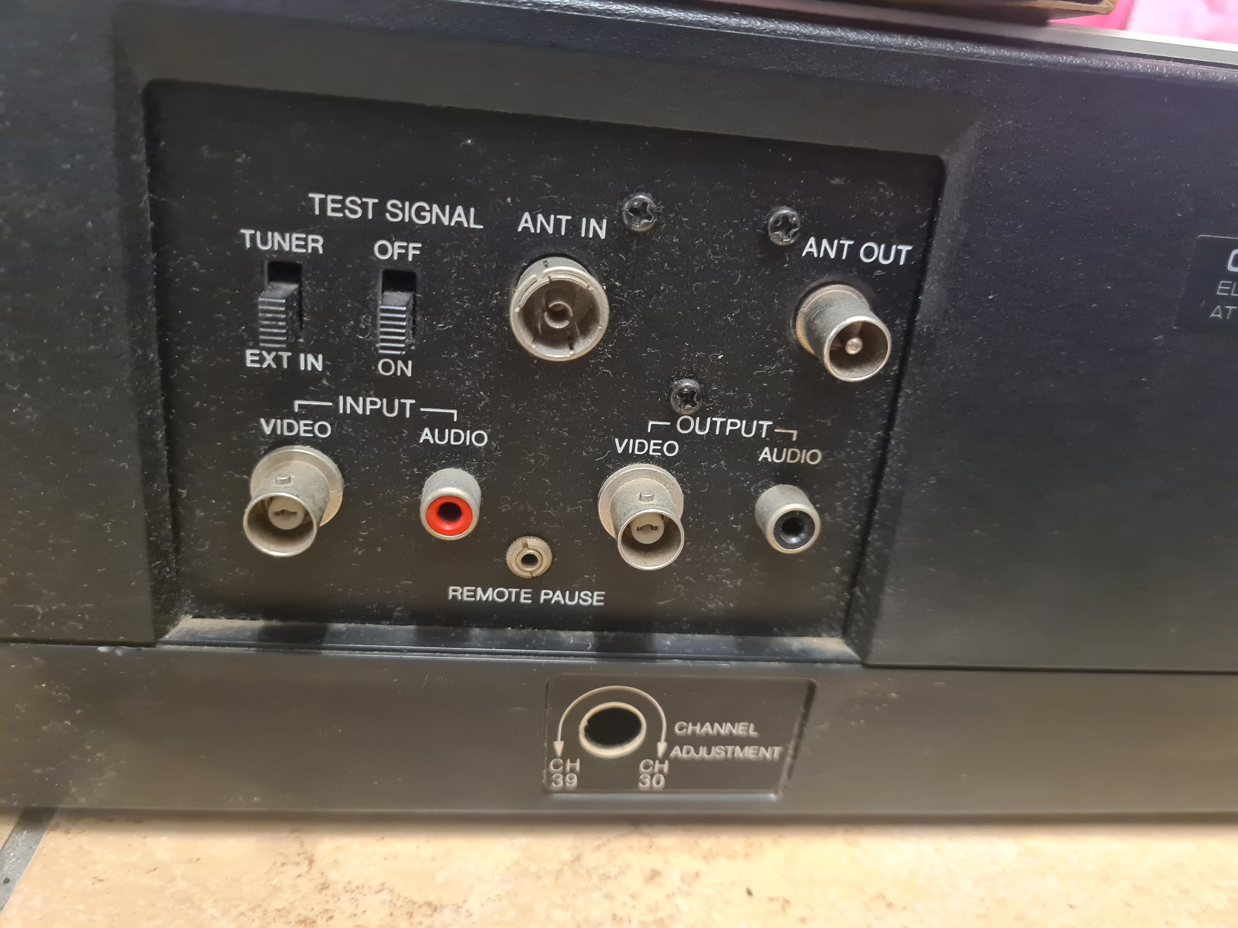

  1. Hi, I've been gifted a Sanyo VTC 5000 and have an Elgato Video Capture USB id like to use to transfer with. Can anyone please let me know what cables I'll need please? (I only have the power for the machine and the Elgato currently)
    Thank you 🙂

  2. For the video: BNC (male) - RCA (male)
    For the audio: RCA (male) - RCA (male)
    I am not sure what kind of signal the VIDEO output provides. If it is a modulated RF signal rather than a PAL composite video signal it wouldn't be compatible with the Elgato.
    Edit: In case of a modulated RF signal you would probably have to connect the SANYO to a legacy PAL TV and connect the TV's SCART output to the Elgato, means use the TV as a signal converter ......

    I have a Sanyo Beta VCR with similar output connectors and it is compatible with the GV-USB2 so I assume the Elgato will be OK.

  5. Originally Posted by Alwyn View Post
    That's good news. The manual is very vague as to what kind of signal/format the VIDEO OUTPUT connector provides.
    It mentiones an RF converter which can be set to CH30....39 for "RF Output". No mentioning of disabling it or providing standard Composite output at the VIDEO OUTPUT BNC connector.
    Anyway, you have a SANYO Beta VCR and it seems to work.

    The BNC video out on your VCR is composite a.k.a CVBS, If it was RF it wouldn't have an audio jack next to it because RF carries both video and audio. You may need a RCA splitter for audio, Even if it's coming from the same source, sometimes you get half the audio gain if doubled in software, not sure why, just a personal observation.

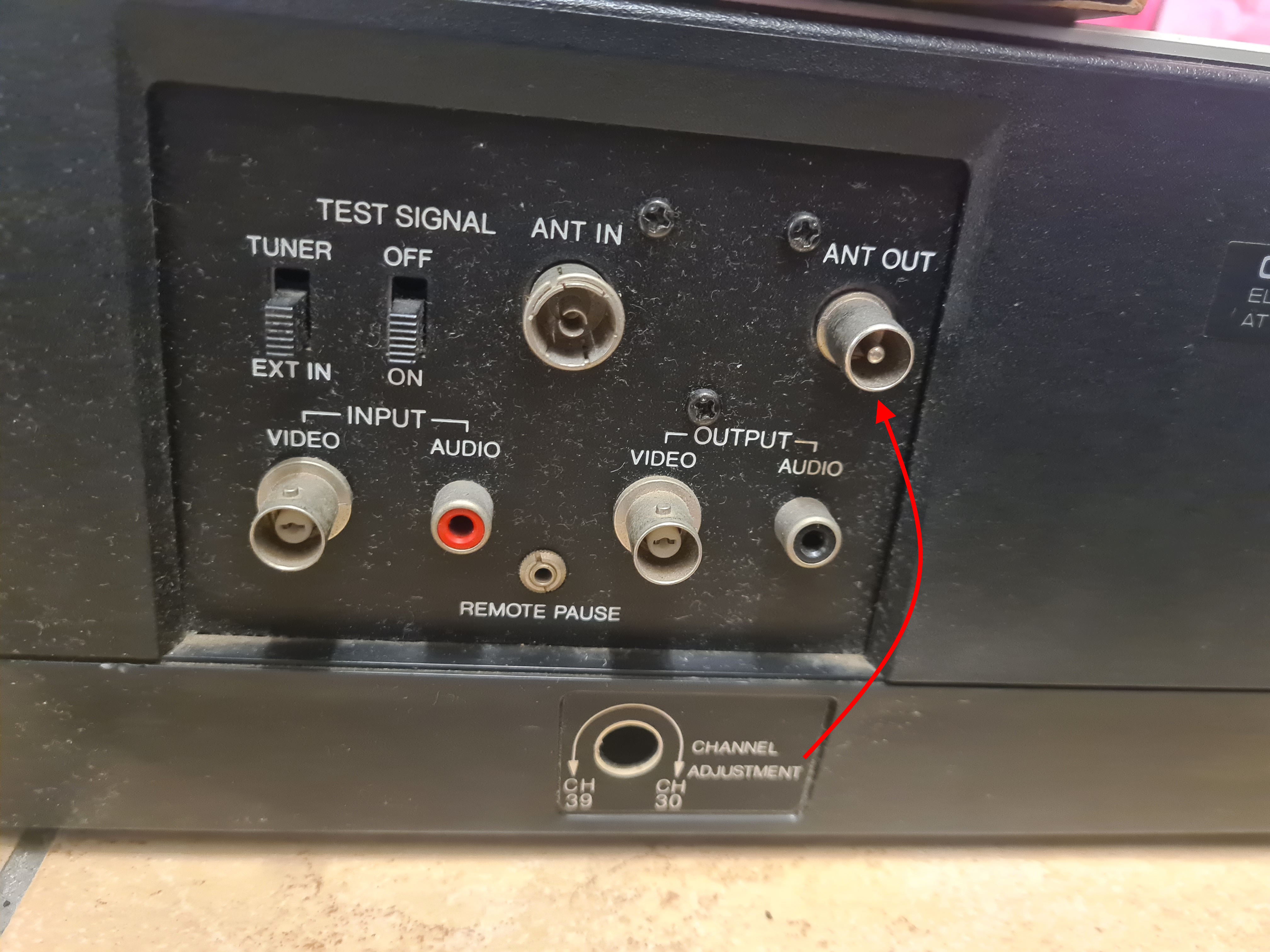

    So I assume that the built-in "RF Converter" and "CHANNEL ADJUSTMENT" of the SANYO sets the TV channel at the ANT OUT for playing the tapes on legacy CRT TVs which did not have a Composite (aka CVBS) input but only an antenna input.
    The manual is not very clear.
    Thanks.
    [Attachment 82652 - Click to enlarge]

    The ANT OUT could be RF out if the switch on the far left is set to TUNER, I could be wrong. If I was the OP I will toss that VCR in the trash bin and get a good VCR, but some people have sentimental attachment to certain gear they used at a younger age.
