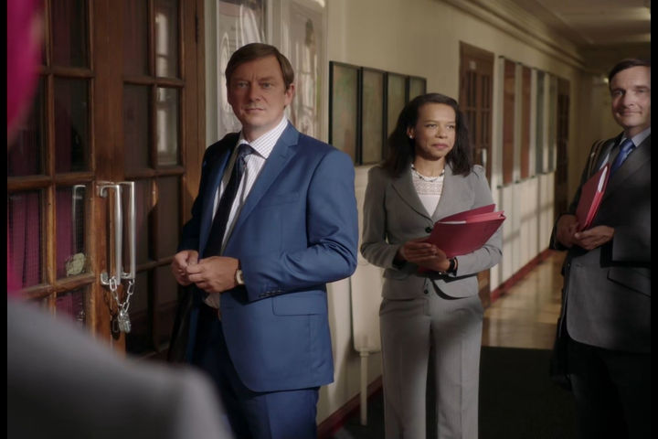

    I wouldn't bother adding borders myself. I'd just crop the crud and set the appropriate PAR. Although I've never been worried about a little resizing. You could try the CropResize function in my signature. It'll at least make the borders as even as possible (centering the picture). I've applied a cropping of Crop(10,2,-12,-10), just as an example.
    Source:
    [Attachment 82642 - Click to enlarge]

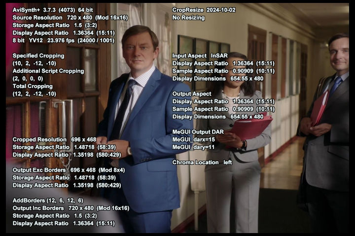

    No Resizing with borders:
    CropResize(720,480, 10,2,-12,-10, NoResize=true, InSAR=10.0/11.0, Borders=true, Info=true)
    [Attachment 82643 - Click to enlarge]

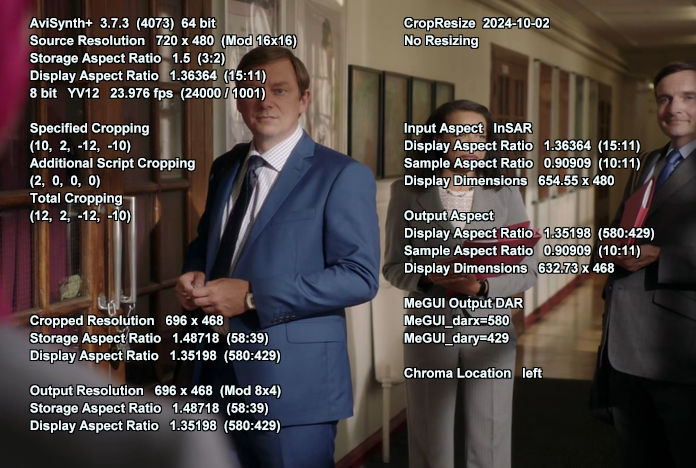

    No resizing without borders:
    CropResize(0,0, 10,2,-12,-10, NoResize=true, InSAR=10.0/11.0, Info=true)
    [Attachment 82645 - Click to enlarge]

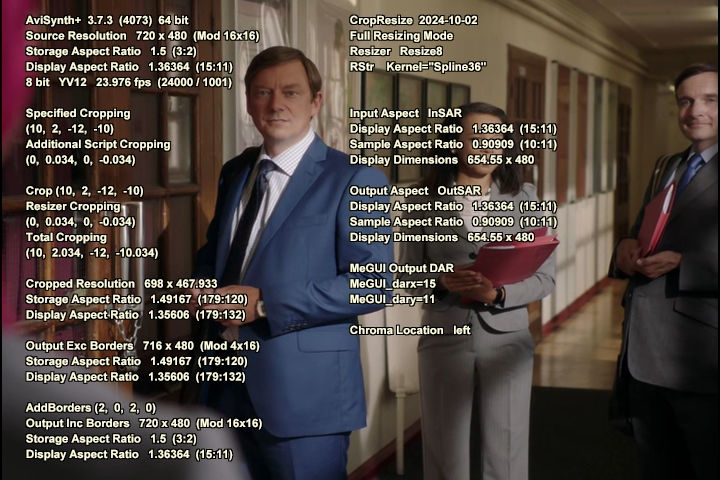

    Resizing back to 720x480 with tiny borders:
    CropResize(720,480, 10,2,-12,-10, InSAR=10.0/11.0, OutSAR=10.0/11.0, Borders=true, Info=true)
    [Attachment 82644 - Click to enlarge]

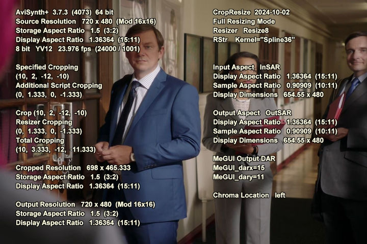

    Resizing back to 720x480 without borders (crops a little extra picture instead):
    CropResize(720,480, 10,2,-12,-10, InSAR=10.0/11.0, OutSAR=10.0/11.0, Info=true)
    [Attachment 82646 - Click to enlarge]

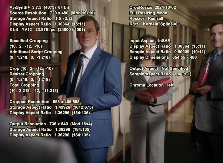

    Resizing to 736x540 (a resolution requiring very little extra cropping in this case):
    CropResize(736,540, 10,2,-12,-10, InSAR=10.0/11.0, Info=true)
    [Attachment 82647 - Click to enlarge]
