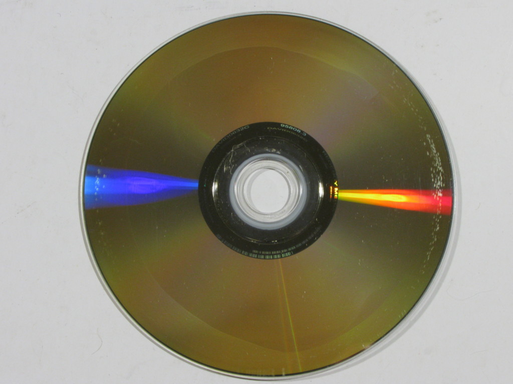

  1. Wanting to copy a DVD, but the disc has scuff marks around the periphery as well as minor scratch marks (not seen in photo). It is difficult to copy this disc because the DVD reader can't read some of the disc content due to the scuff marks (and possibly due to minor scratch marks as well).
    Looking at cleaning this disc in the hope of eventually being able to copy all of the DVD content.
    I've looked at several disc cleaning method videos online, but I have some doubt as to the validity of the cleaning methods, and there seems to be a risk of permanently damaging the DVD disc, which I don't want.
    What are known reliable and effective DVD disc cleaning methods/procedures that actually work and minimize chances of permanent disc damage?
    Prefer responses from people who have actually carried out the procedure (successfully) themselves.
    Thank you.
    [Attachment 82594 - Click to enlarge]
    EDIT: Forgot to mention that there are no professional disc cleaning services in my area (as far as I'm aware), so I can't use a professional cleaning service (locally).
