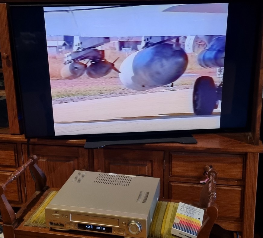

    You mean like this (LG 55SK8500)?
    [Attachment 82617 - Click to enlarge]
    No deinterlacing of home videos though. Commercial tapes (I assume, PSF) no issues with interlacing. Quality? Same as the unprocessed capture.
    The OP does not need an upscaler.
