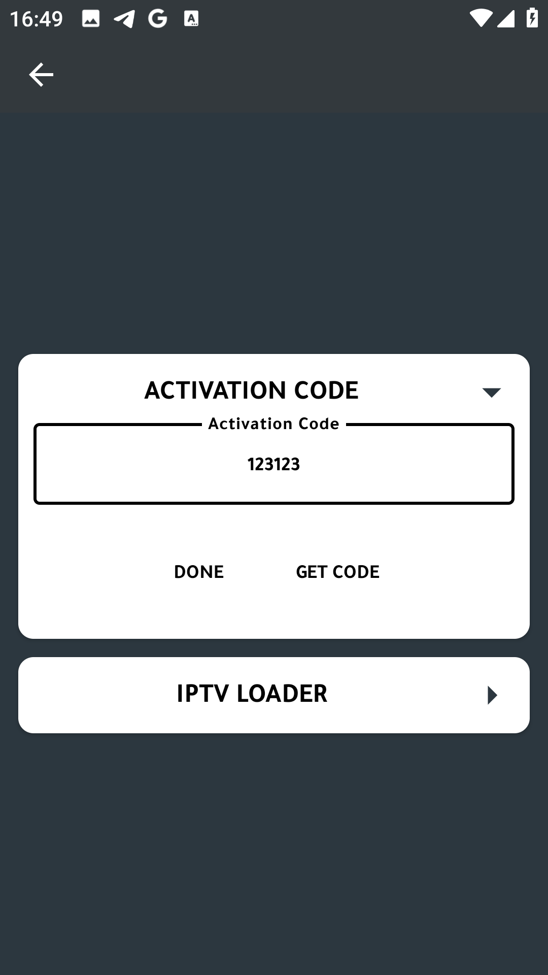

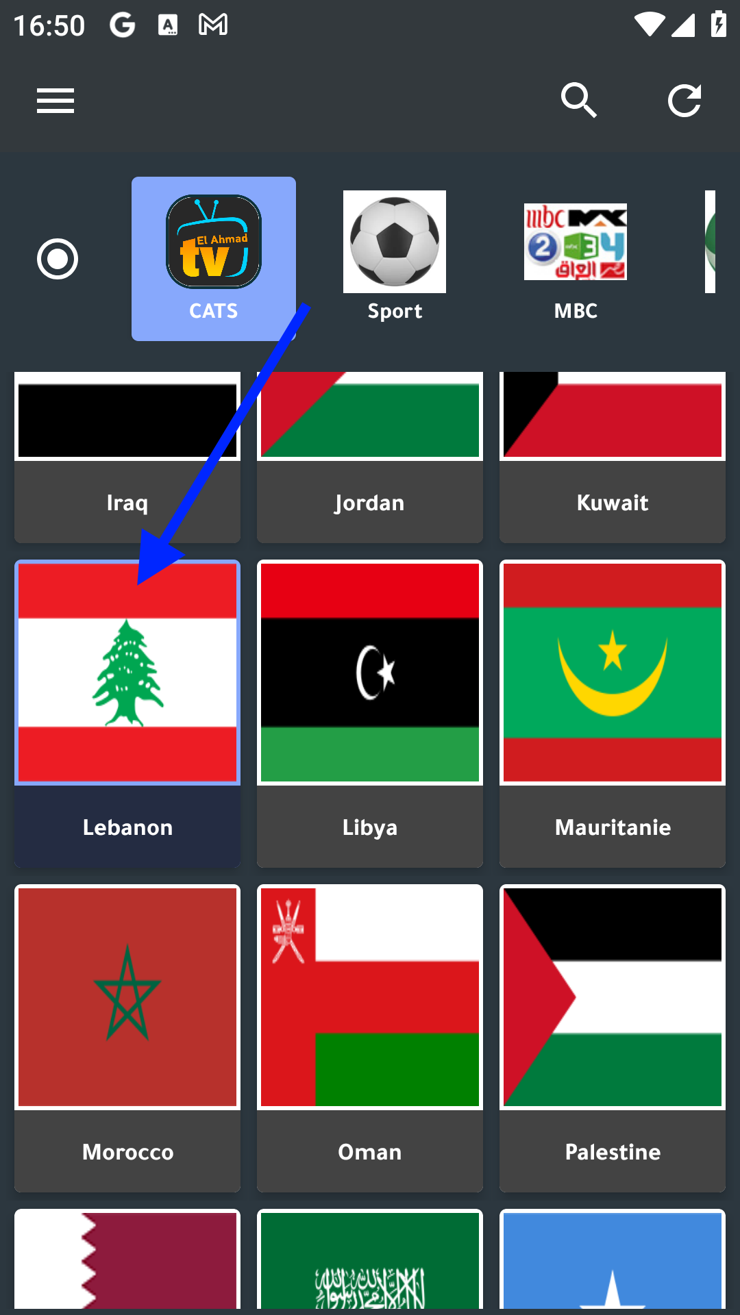

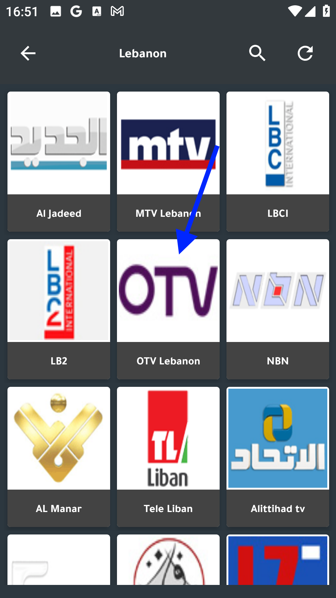

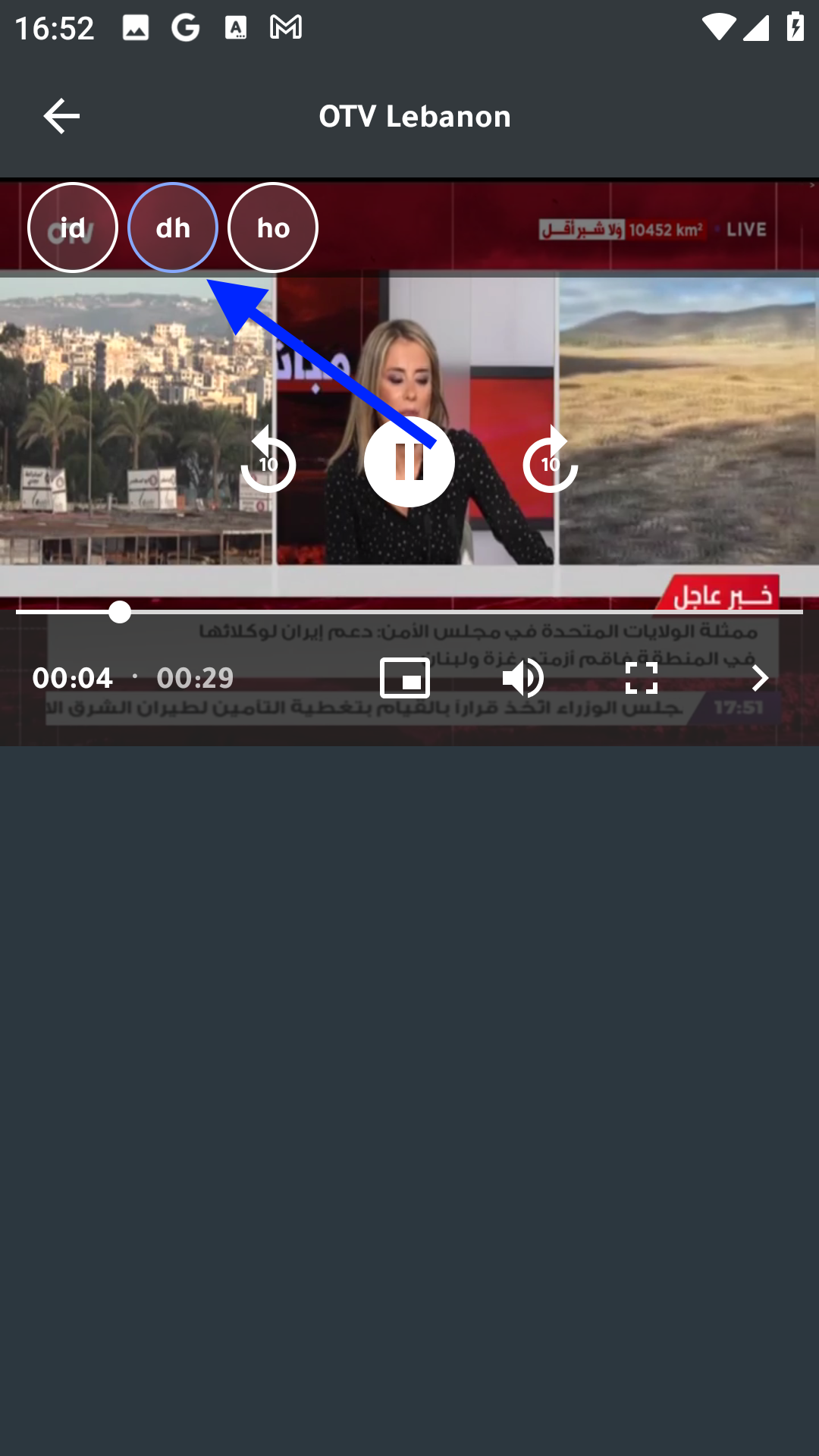

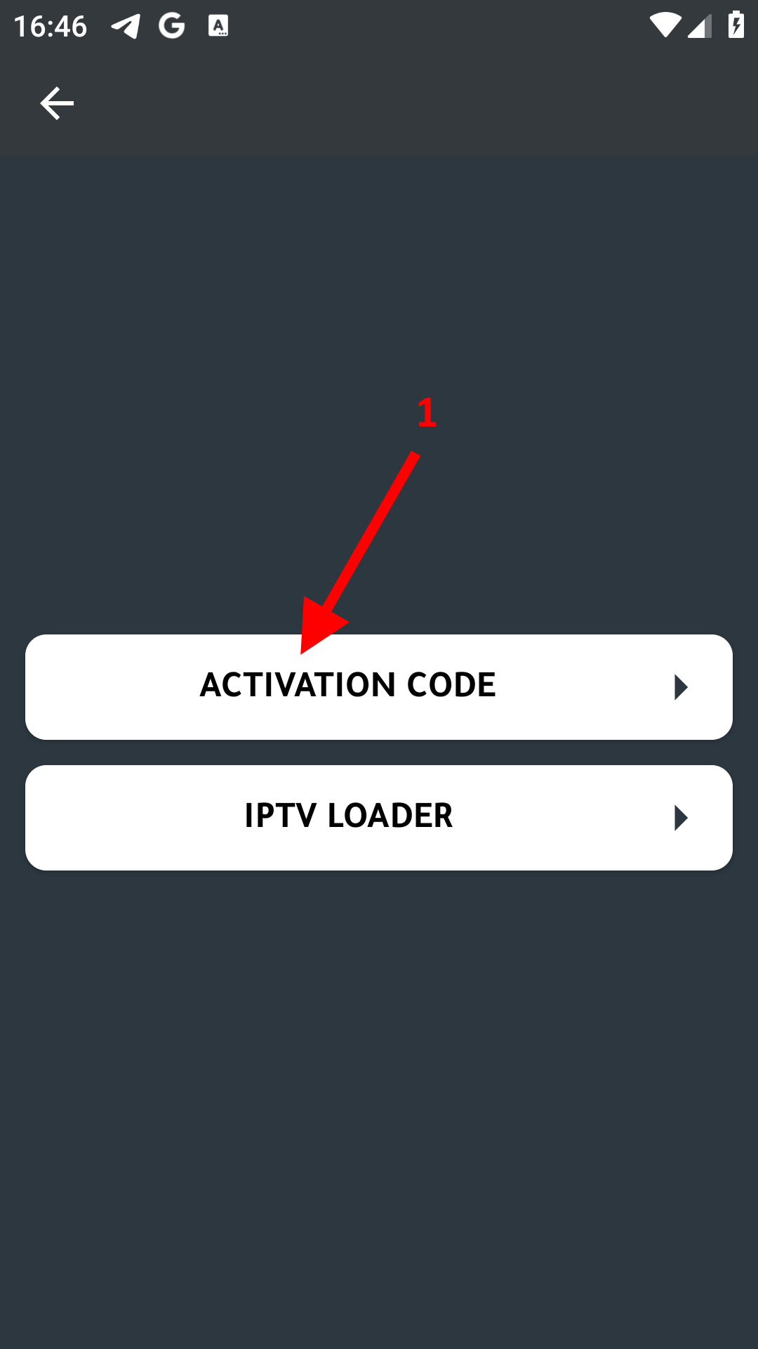

You can extract the encrypted code from the app by following the steps shown in the screenshots to access the specific channel. -

He uses an activation code in one of his screenshots.
