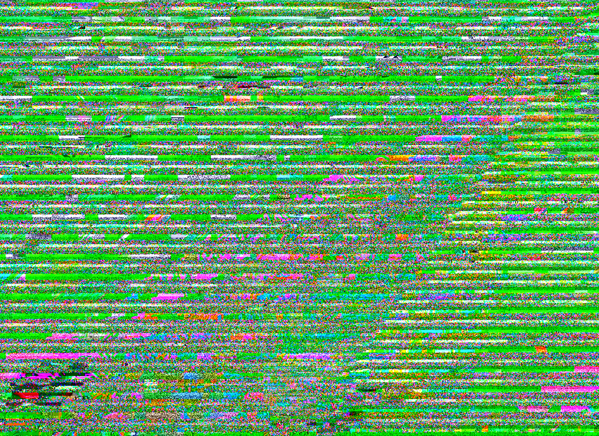

  1. I've installed K-Lite Codec Pack Full with MADVR but some files' video playback is broken. They work with VLC.
    The files are HEVC .mkv but there are other HEVC .mkv that work in mpc regardless. I tried different video renderers as well but they all appear the same.
    [Attachment 82557 - Click to enlarge]
