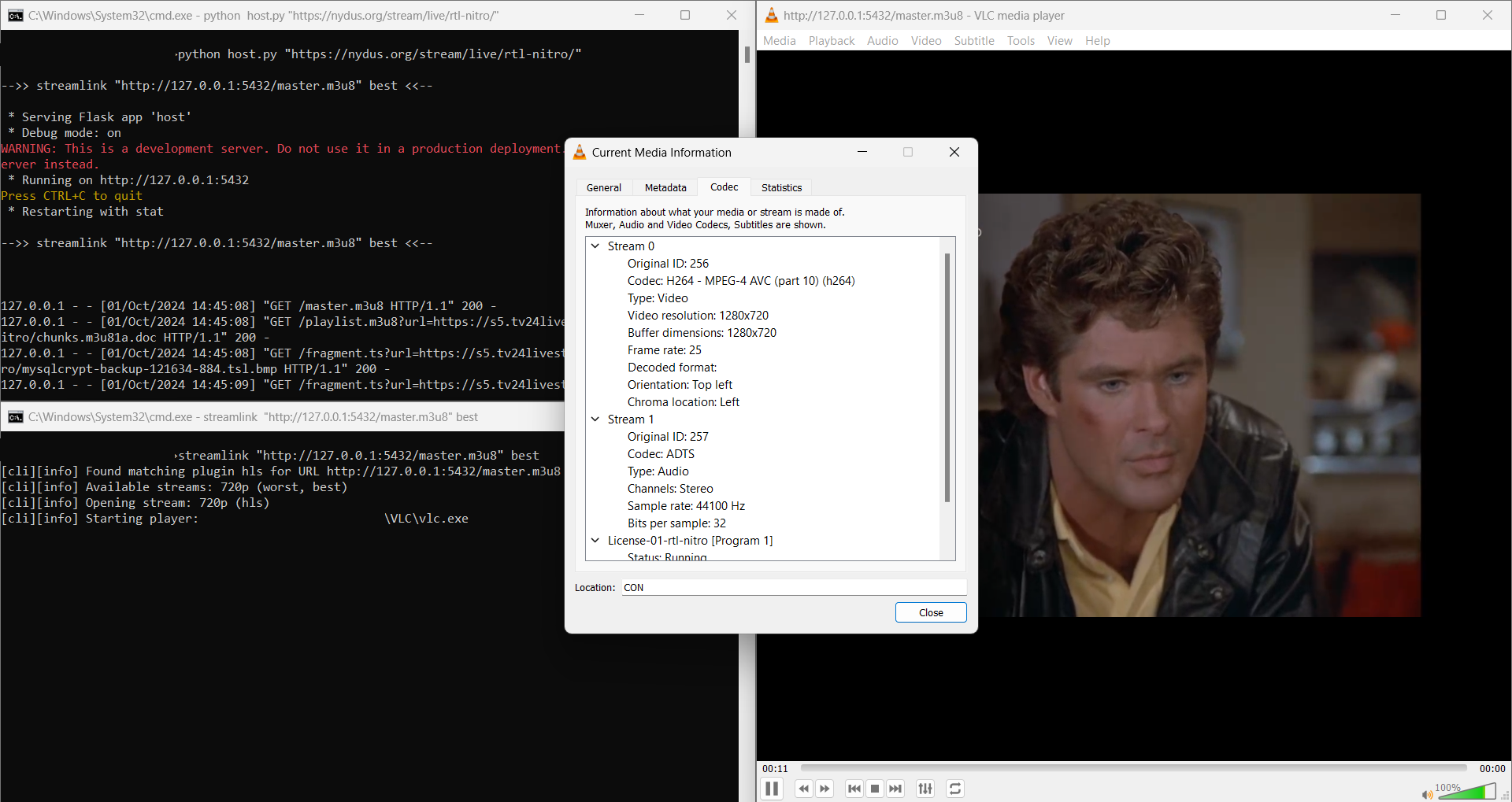

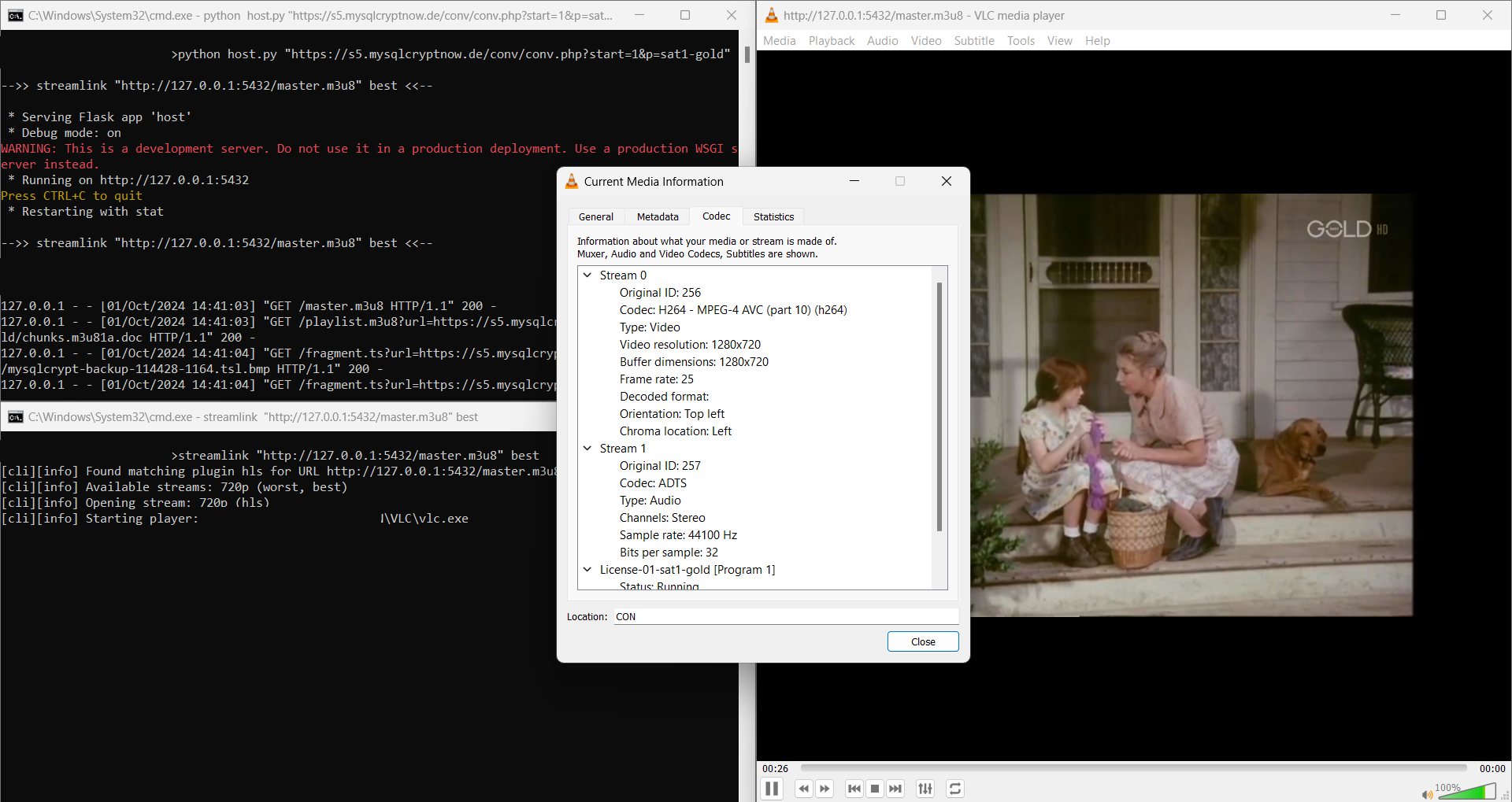

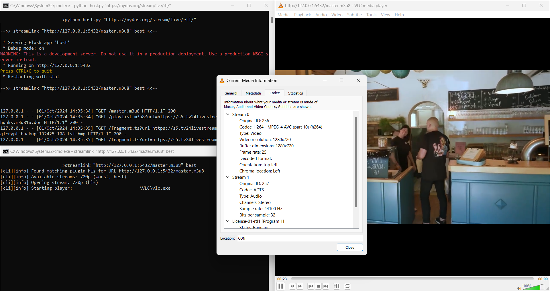

    Usage, input page URL or conv.php (the master.m3u8 equivalent of their site)
    python host.py "https://nydus.org/stream/live/rtl/"
    python host.py "https://s5.mysqlcryptnow.de/conv/conv.php?start=1&p=sat1-gold"
    python host.py "https://nydus.org/stream/live/rtl-nitro/"
    streamlink "http://127.0.0.1:5432/master.m3u8" best
    [Attachment 82570 - Click to enlarge]
    [Attachment 82571 - Click to enlarge]
    [Attachment 82572 - Click to enlarge]
    The fragment URLs are edited to point directly to their unaltered ts content.
