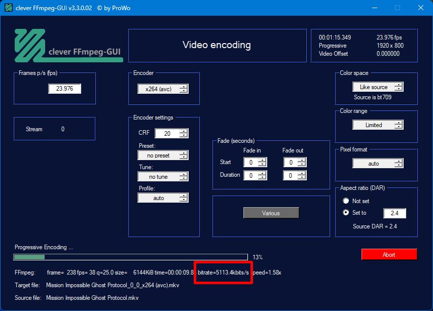

Nobody knows what bitrate to use. Different videos require different bitrates. Action, noise, flickering lights, smoke, fog, smooth gradients all require more bitrates. If you encode everything at at the same bitrate some videos will get more than they need, other less. If you encode two different videos at crf 15 one might turn out 17 Mb/s, another 25 Mb/s, and another 5 Mb/s, all depending on the properties of the different videos.

Use clever FFmpeg-GUI to encode, so while encoding you can see the actual bitrate, choosen from the encoder at the given CRF.
[Attachment 82559 - Click to enlarge] -
