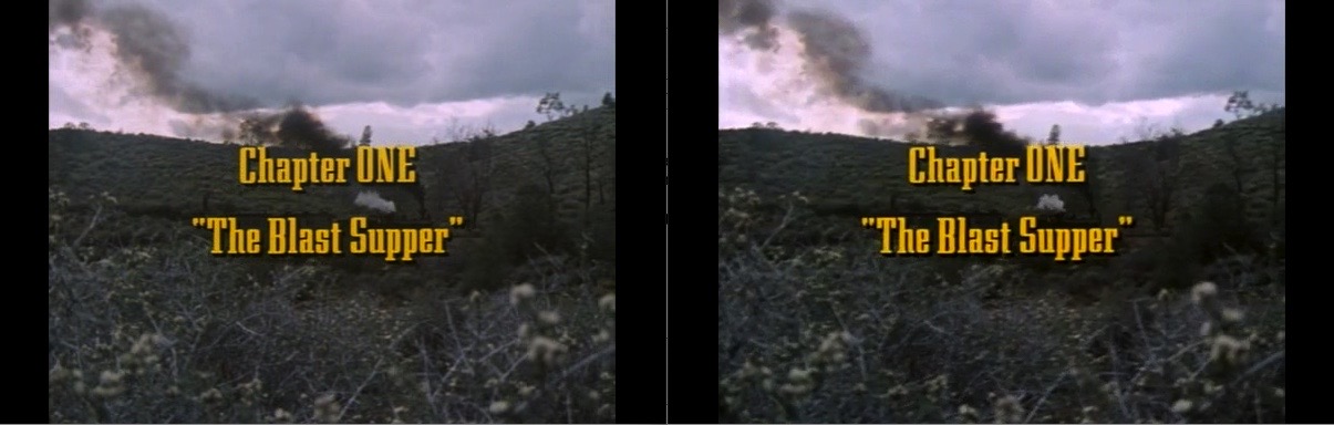

    Using AVC has allowed me to lower the file size to an acceptable size, however the colors look a tad darker than the source video as seen in the image below. The one on the left is the source video while the one on the right is the Vegas render:

    The brightness difference could be to do with the source being full range
    and the levels being crushed. You'll have to post the video, or a clip of it for analysis.
    Clips of both videos for comparison or just one of them? The original video is about an hour in length and other than Sony Vegas I don't have any tools to hand to shorten it without re-rendering.
    Another quick note when it comes to the color - the issue does not occur in the preview.

    To update, changing the project's pixel format to 32bit floating point (Video Levels) has the same color problems, but (Full Range) seems to have fixed it. Thanks for the assistance.
