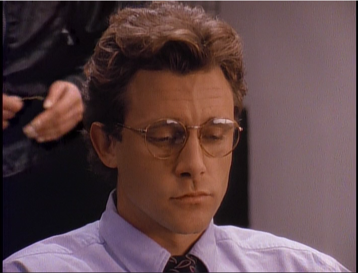

  1. Is there a name for these vertical artifacts? I occasionally encounter these when encoding a DVD and don't understand what they are or how they occur. Is it an artifact from the transfer process? Can they be filtered?
Name:	vertical artifacts screenshot.png
  2. I remember to have got these as a result of de-interlacing quite often. It seems that quite chaotic random structures get clustered by deinterlacing and become more visible. Maybe you could try different de-interlacers.
  3. Thanks I just tried some other deinterlacers, QTGMC, BWDIF, yadif, but couldn't find a solution. Any other ideas? Surely there is a name for this as I've encountered it more than a few times.

    Ok. Looks like the field order is wrong, is this any better?
  9. Originally Posted by davexnet View Post
    I got that. I'm referring to the vertical like noise. look at the whitewall in the back. its easy to see in the screenshot I posted above as well.
    Mar 2008
    I think it's just noisy, I don't think it's an artifact of the deinterlace - unless I'm still looking at the wrong thing.
    Does this version with some denoise help?
  11. @LaserBones: Post a few seconds of the original .vob of the DVD
    The .mkv looks like a messy PsF or poorly baserate deinterlaced video encoded as interlaced .... and there are mpeg2 artifacts.

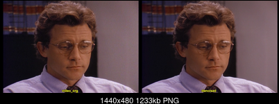

  12. Captures & Restoration lollo's Avatar
    Jul 2018
    Italy
    As davexnet wrote, if you are referreing to the noise you can try something like TemporalDegrain2(degrainTR=3).
    video comparison: comp.avi
    image comparison: https://imgsli.com/MzAwMjUw
    You could add some light sharpening after.
    If you refer to the vertical clearer bar, it is in the source and difficult to remove.

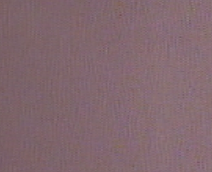

  13. I understand the OP refers to these vertical patterns, present all over .... (enlarged x2).
    [Attachment 82473 - Click to enlarge]
  14. I agree it's not caused by deinterlacing, you can simply look at the separated fields to see the artifacts are already in the fields.
    Looks to me like noise was badly compressed, so I would mainly categorize this as compression artifacts.
    Cu Selur
    Ps.: DPIR denoise might be useful with this.

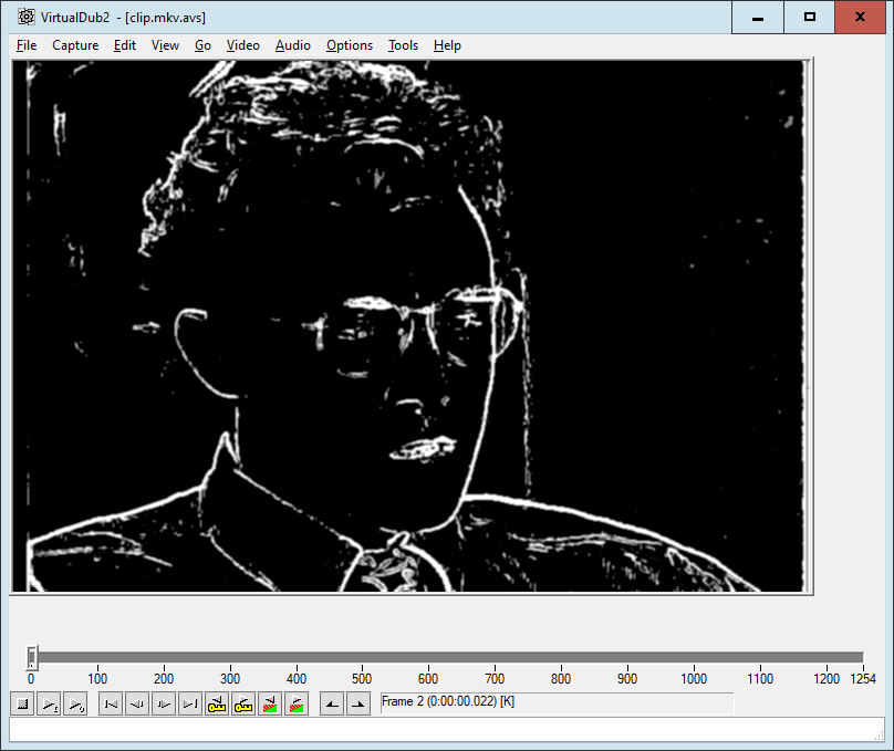

  17. Something like:
    edges = mt_edge(mode="hprewitt", thy1=50, thy2=50).Blur(1.0).Blur(1.0).ColorYUV(cont_y=500)
    Overlay(BilinearResize(width/2, height).Spline36Resize(width, height), last, mask=edges)
  18. Originally Posted by jagabo View Post
    Something like:
    Hey Jagabo, This is amazing. If you have time, would you mind explaining what the edge mask is doing? I'm not familiar with edge masks. Other than that you're just halving the horizontal resolution to blur away the artifacts correct?
  19. Yes. mt_edge() returns a map of sharp edges. Where there are sharp edges the map is white, otherwise black. Overlay() is used to restore the sharp edges from the original video onto a horizontally blurred version of the video. The edge map is used as an transparency map. Here's a slightly modified version of the script:
    LWLibavVideoSource("clip.mkv", cache=false, prefer_hw=2)
    vInverse() # blur away residual comb-like artifacts (time base errors, filtering errors)
    edges = mt_edge(mode="hprewitt", thy1=50, thy2=50, chroma="-128").ColorYUV(cont_y=500).Blur(1.0).Blur(1.0)
    You can see the edge map by adding return(edges) to the end of the script:
    [Attachment 82616 - Click to enlarge]
