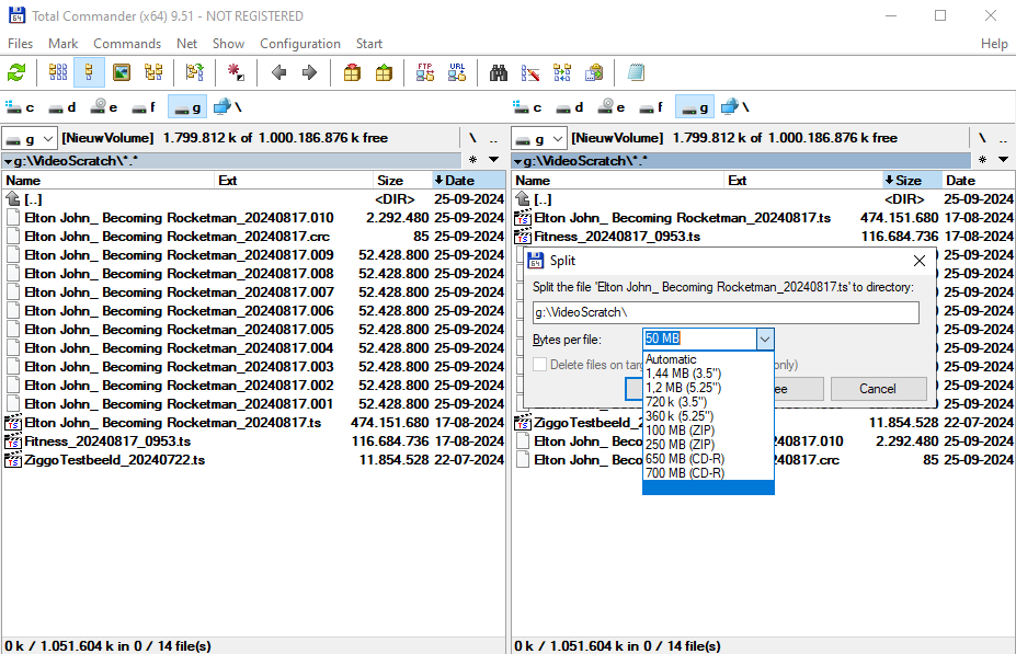

    Instead of uploading whole 1GB TS files possible you can split them in smaller (50/100 MB?) segments?
    "Dumb" Splitted TS files are usually playable thanks to the extra recovery/resync data included.
    Assuming they are real TS files.
    Then you could post the last part of 000.ts and the first part of 001.ts for example to see if/how they can be joined "perfectly".

    Originally Posted by flexmcmurphy View Post
    That's a good idea to split my .ts files into maybe 30 second chunks to share with you guys but after googling a little about how to split the .ts files down to smaller sizes now I think splitting the .ts files may just introduce more potential for out-of-sync audio/video problems! Unless you are sure of a way to split .ts files that preserves the audio and video streams start and stop timestamps then I think that might be a frustrating waste of time because the main issue here IS trying to preserve and re-join the audio and video streams start and stop timestamps exactly.
    If you are using "dumb" data file-splitter, which only splits the files without any other operation, you will end up with exact the same data when the parts are joined again.
    So especially NOT use a video splitting tool.
    There are many tools around which can do this.
    For example with the excellent filemanager Total Commander you co do it easily.
    Or the Total Commander inspired Double Commander for Win/Linux/Mac.
    Total Commander - Splitting Files:
    [Attachment 82460 - Click to enlarge]
